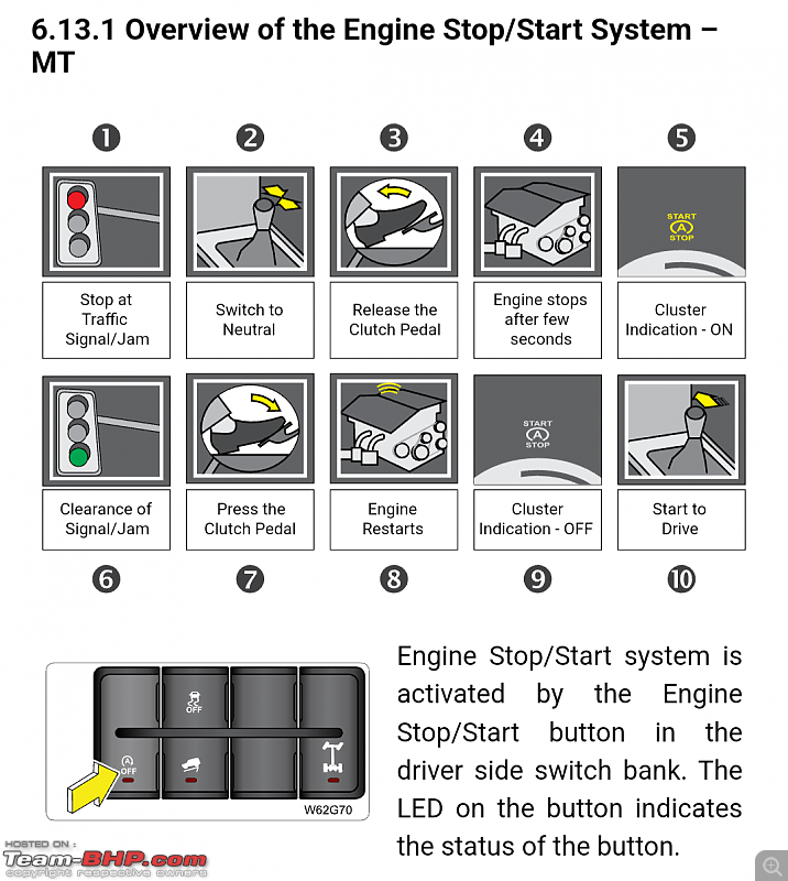

Is there any way to switch off the engine without switching off the infotainment system?
After reaching my parking , I may have to continue the call for few minutes, but I would like to switch-off the engine alone. Couldn't find the option.

One query:
Use the Engine Automatic Start/Stop option. Works like a charm. Turn on the @ switch or the right side panel. When you stop just change gear to Neutral and release the clutch. Engine stops. Press the clutch again and engine starts. In automatic you just need to press the brakes stay in D mode. You may engage hand brakes as well and leave the brakes.
Infotainment system remains On. AC blower will also be running, however cooling will be off because engine is off.
Instruction images from user manual

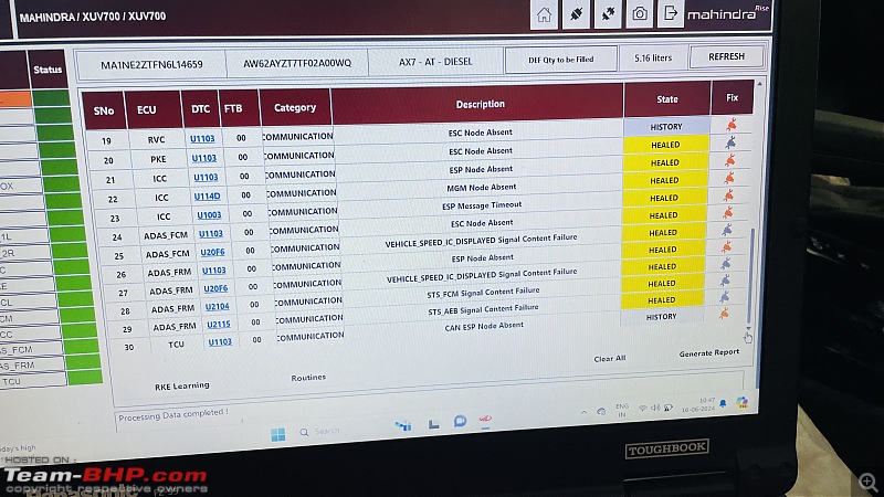

This episode happened in early evening today. It was an open parking and it was quite hot. The car was there for almost an hour before i got into it and had this experience.
I have no clue why all these things happened and I’m still hopeful i may not find the engine sign on when I start the car tomorrow morning. At the most, i’ll get it sorted in the service centre in the coming week.
But my CONFIDENCE on the reliability of the XUV is BADLY SHAKEN. Mechanical issues can happen with any machine and are acceptable but an issue of this nature which seems purely electronic is scary and can easily lead to a severe mishap. It may not happen again and I may forget about this instance in a few weeks time but right now I feel like exploring a reliable replacement.
Any updates regarding this? The same thing happened to me last night when i was parking my vehicle while in R. The steering was heavy, same alerts and same lights blinked on the instrument cluster. The exact same thing. Did you contact your SA or go to service centre for the diagnosing of this issue?
Last edited by KarthikK : 16th June 2024 at 12:38. Reason: Please quote ONLY the relevant bits of a post. Quoting a full, long post inconveniences our mobile readers. Thanks!

Old 16th June 2024, 11:18   #10199
Join Date: Sep 2022
Posts: 33
Thanked: 60 Times
Originally Posted by StraightDrive20 View Post
When I started the car next morning (I only wanted to check for the issue, had no plan to take the car out), the engine indicator was present on the instrument panel. I turned the car off after 5-7 minutes.
The car was unattended till last evening as I was travelling over the week. When i started it yesterday it was ALL FINE !
That, I guess, is the XUV 700 for you - heals on its own
Jokes apart, I drove it for close to 50km yesterday and couldn’t tell if anything of that sort ever happened.
I do not plan to take it for a diagnosis as don’t think if I can replicate that and don’t want them to experiment with the car.
Hopefully it resolves for your case as well. Keep us posted on your experience
In Mahindra Service Centre… they are trying to diagnose the issue with their iscan and they found the following errors. Even though the errors are clearly visible they are unable to decode the problem properly. Requesting technical experts on team bhp to help decode these errors if they can to help solve this problem once and for all.
Second page of the errors and it seems to highlight esp and esc. Wonder what does it mean by “healed”. Self healing capability maybe ?
Thanks for the quick response.
Unfortunately I turn off the "Auto Start/Stop" most of the times, in that case engine won't turn off automatically after stopping and engaging break.
Since there is an option to turn on the infotainment without turning on the engine, I hoped something similar available for turn off as well.
