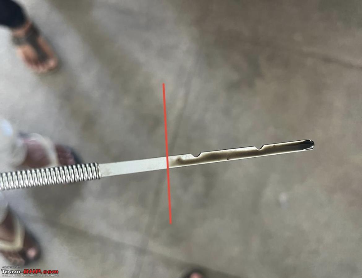

My XUV700 diesel has done 15000 km. Serviced at 10,000 km. Just randomly checked engine oil & found it to be above max mark. There have been no forced regen’s.
Is this a cause for concern?
It may be, only if the viscosity of the oil goes down below the specified value.
Simply speaking, there is a system of injecting diesel in the exhaust to burn the soot. Some of that diesel, if not burnt fully, may roll back to the oil chamber and mix with the engine oil. This is called Oil Dilution and this issue has been reported by some members.
What you can do is visit the ASC, report this issue by opening a RO and get the engine oil changed - for peace of mind.
For more insight on this issue, please visit this topic : https://www.team-bhp.com/forum/techn...ngineer-7.html (All your questions about DPF & BS6 Diesel answered by a Diesel Calibration Engineer)
Thank you for the inputs.
There hasn’t been any active regen performed in the past 5000 km since service. The car mostly does a mix of highway + B road runs. Very recently i had a DPF clogged warning, instead of performing active regen, i drove the car on the highway for 15 min with engine RPM between 2.5-3K with speed of 70-90 km/hr. The warning disappeared.
With no active regen, is there a possibility of oil dilution?
I am also getting the car sent to ASC for a check-up.
