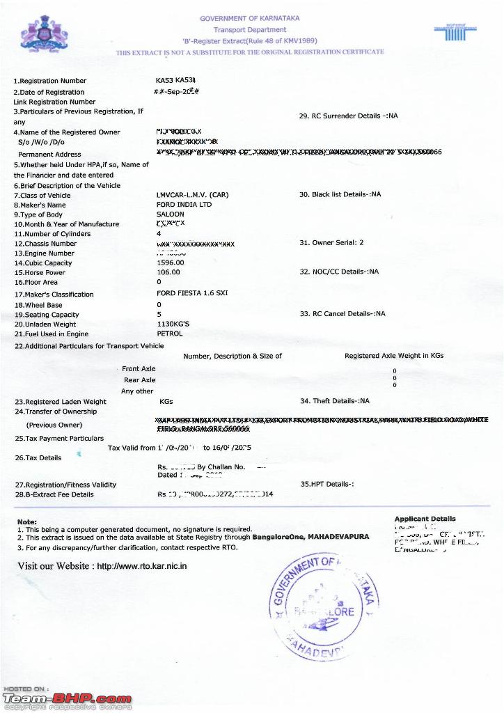

Originally Posted by samabhi View Post
One way I know is go to the nearest Bangalore One Center and get a copy of RC extract. They charge very nominal price and it will show the information about any hypothecation.
Thanks a lot for the information. Got the RC extract from Bangalore One center. The format is as shown below. I can see that there is no hypothication.
ARTICLE: RTO Hypothecation Removal Process - Step by Step Guide-untitled.png
