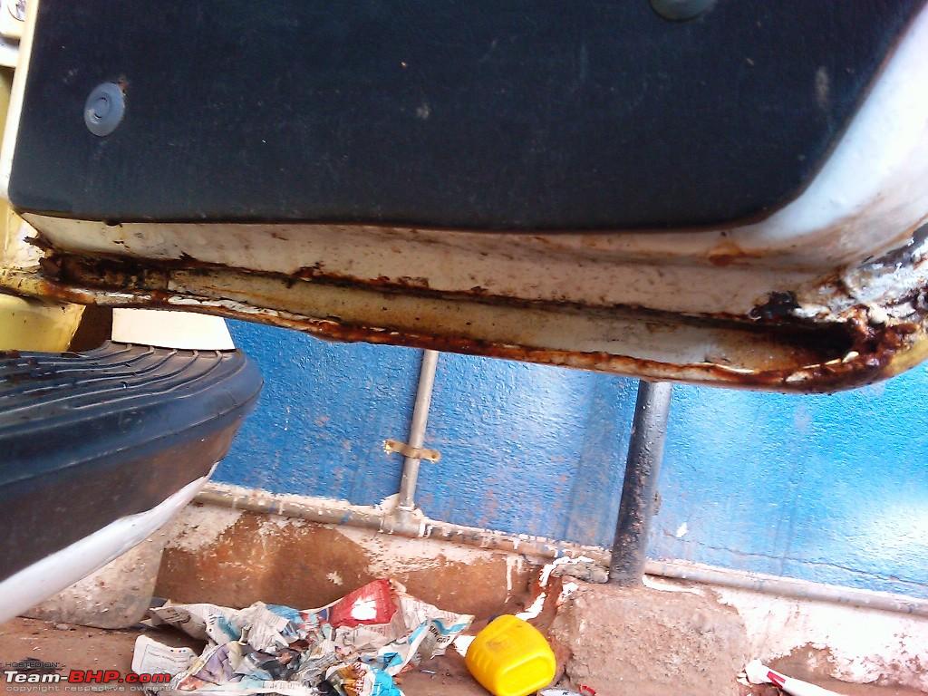

2 yrs after paint, i see rusts
Originally Posted by Mpower View Post
Looks good Pavan. Why no number plate up front? Square shaped plate mounted off-center would look much nicer than painting on bumper.
Searching for a number plate of the same size as in rear. will do it ASAP.
Very surprisingly, i found few small places with rusts yesterday and i am not very happy with the whole thing. Gave an earfull to my painter and made him re-do the entire panel once again, though this is not the final finish, he has sprayed WD-40 and rust preventer on the areas, put the oil putty, which will remain there for a weeks time. Later which we will sand them down again and re-paint it.

Dont you think the right way would be to seperate the door skin from the frame , repair them seperately, put them back together , put sealant in the joints and THEN paint it. I think thats the only way the rust will stop

That process has to be adhered to if the rust pores are deep, here in my case, its just the surface rust spots at the joints, caused due to encapsulation of rain water within the door rubber strips.
I have used oil putty at the joints presently, will observe it for couple of days and attend to it. In case i need to use joint sealer, will gladly do it. Thanks for your concern and suggestion, i truly value it.
