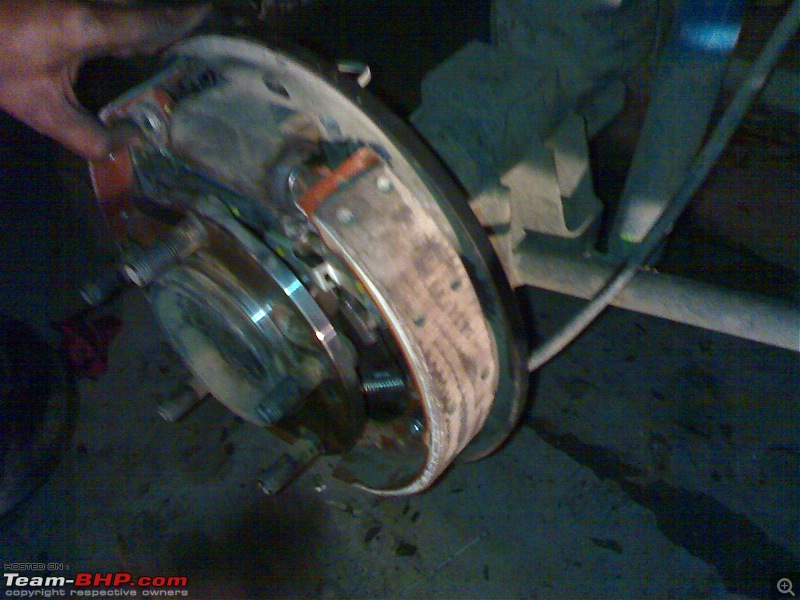

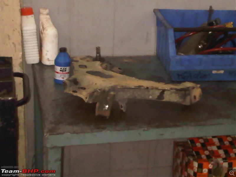

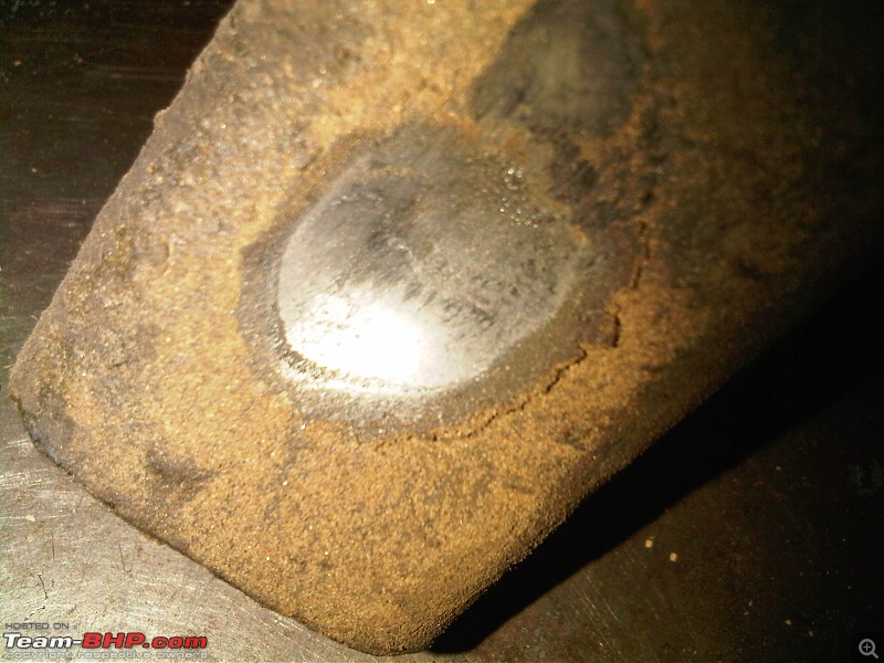

Still awaiting a call from the M&M people to come pick up my car. In the meantime, I have a few pics on what happened to the car on the steering issue. Both the left & right front shoulders were changed. The pics are of the right shoulder. It had developed this gash (seen bright in all pics). Thereafter I have been advised not to turn the steering all the way
Just wanted to know if this has happened to any one else as well.

Rajat, after seeing the pictures and then again going through your first post in detail, I want to ask did you change tyres from stock to oversize? If yes, then what is or was the tyre size.
The gash visible in the pictures does not happen normally when turning the steering lock to lock if you have stock tyres, i.e. 235 x 70 x R15 or R16 as the case may be.

Hi gd1418,
I have the regular Bridgestone tyres that were made available with the Slx. I did opt for the alloys, though. These also were the standard alloys that are available with the Vlx (got them from the dealer himself).
What I was shown at the A.S.S.(& pardon the noob-ness here) was that there is a round metal protrusion somewhere inside the metal part of the tyre frame. This is similar to the round hub, which we find at the back of SUVs, to fix trailers etc., though smaller in size. This is built in such a way that its supposed to touch the shoulder. I was also told that this happens only in this particular model. As mentioned in the original post, for the first few times, they simply covered the part with some rubber dongle, which would dampen the effect of rubbing, hence removing sound, but a months - two months of turning the tyre all the way would eat into this dongle and the sound would reappear.
Again, & more loudly this time...
Is this normal? Cause I know this will reappear in some time if I turn the steering all the way!!

Rajat, could you provide pictures of this round metal protrusion?

Well, I did not take pics of that part
But will try to explain (going into noob-mode again)
When you take off the wheel, you are faced with a series of round metal strips/ plates. This protrusion is right behind the disk plate and is facing/ slanting upwards. When you turn the steering, the entire set of circular plates move on their axis , resulting in this protrusion meeting the shoulder at the place where you see the dent.
Idea to have this protrusion (as per A.S.S.)
To ensure that there is some type of stoppage when you are turning the steering and so that there is no "load on the steering bracket" (read - I dont understand one bit of it!!)
Also just checked with the supervisor at the A.S.S. - Sterling Motors (at least that I have been able to achieve in 2 years is that each & every person at that place knows me by face) and was told that this is present in each & every Scorpio, whether new or old
Also, wanted to know if the brake problem that I am facing can be sorted out by installing the brake discs of the mHawk. While speaking to one of the mechanics at the A.S.S., he unwittingly mentioned that this problem can be sorted out that way. Have already made a request for the same to be tried.....

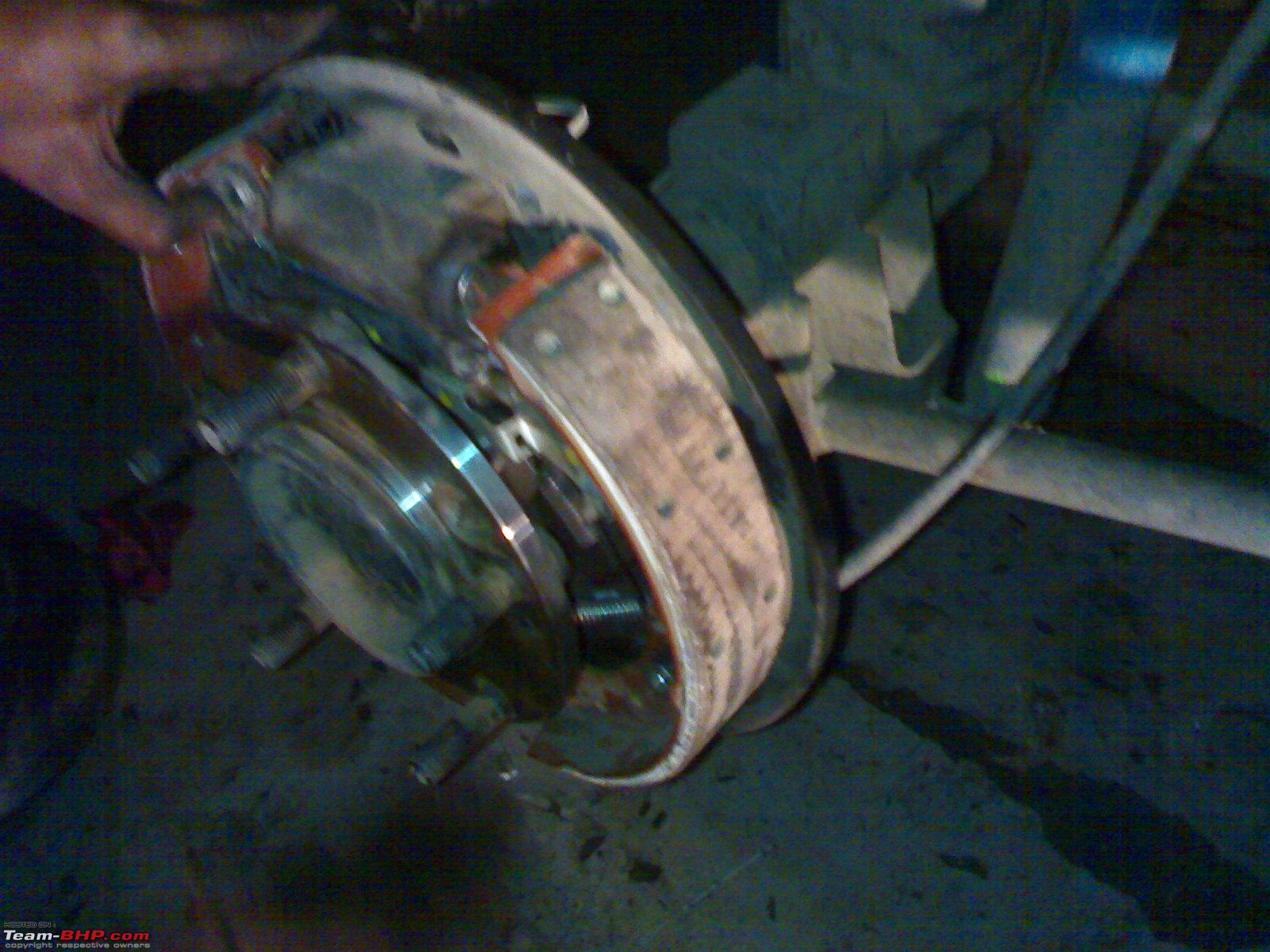

Hi guys, I wanted to share this information for the benefit of all Scorpio owners, especially who owns the latest MHawk series.
I had noticed that my left real wheel was getting locked up during hard breaking(I’ve talked about this in different TBHP threads in the past) and have brought it to the notice of A.S.S during my first service. I was told that it has been fixed, but I noticed the problem the very next day. After trying couple of more unsuccessful attempts with A.S.S, escalated the complaint to M&M and my Scorp was taken back for a detailed testing. I got it back after 4 days, claiming that the problem has been fixed. When I did a test drive, it appeared that it has been fixed. Few days later, it re-appeared, by then I also noticed that the same wheel had a small puncture and was losing the pressure. Fixed the puncture and for few days the break worked fine. I started to notice the screech again, though it was minimal and only appeared occasionally.
It was by then the time for the second service (6 months, 10000 K/Ms, I’m still due on my Travelogues, sorry about that!). This time I mentioned to A.S.S that I want to get this problem fixed forever. To my surprise, the service adviser says that they have a circular from M&M, saying the break liners in new Scorps are faulty and they are in the process of replacing them. Though I was relieved a bit, I was upset that I was driving a massive 2 ton SUV since last 6 month, with a faulty break liner, and M&M never bothered to inform me at least!
The story continues- As usual, I got a call in the evening saying ‘all is well!’ I did a test drive again and there is was again screeeech! When I asked them what they did with my break liner, I was told that the circular was to chamfer the break liner surface and not actually replace it. However, the amount of chamfering they did wasn’t enough! They took the car back, removed the break liners and chamfered them again. I was in a state of shock , while all these happed and the whole thing was very unprofessional. The mechanics at the A.S.S were very helpful, though. They fitted everything back and now the wheel doesn’t lock and I confirmed the ABS is working by skidding in the smooth workshop floor. However, I now feel the breaking distance, even in regular breaking, has come down. Have to check in detail.
See the modified break liner below
Mahindra Scorpio : Issues & Solutions-scrop_break.jpg
