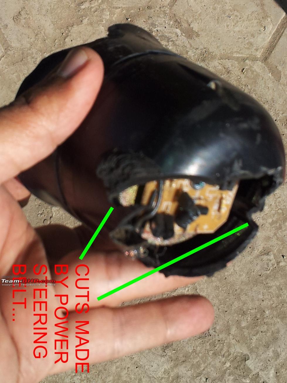

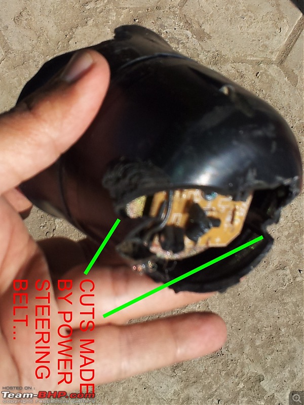

XUV HOOTER BREAK-OFF
hi everyone
Its been exactly one year since i bought my XUV from Bhasin Motors, Delhi. I should say that i totally love the XUV for everything it is and also for what its not. having owned mahindras before i never expected a perfect vehicle in the first place! hence i got more than what i expected. definitely value for money keeping in mind all that it has to offer....
I have had my share of niggles, some of which i got solved reading through XUV threads on team-bhp. But this is the first time i am really complaining since what has happened to me could be life-threatening to others and Mahindra need to look into this issue asap.
This is what happened -
After a 400 kilometer journey from my home place indore to bhopal and back, i heard some loud scraping sound coming from the engine bay. I opened the bonnet only to find that the sound was coming from the power steering belt, into which the hooter (for security system) has somehow broken off and fallen!!! It was stuck in the power steering belt and was being sawed off by it slowly. I immediately took the vehicle to the service center which luckily is very near to my home. They removed the engine cover and with much difficulty, pulled out the hooter.
As is quite obvious the hooter was badly damaged as well as the power steering belt which was shredded badly. As i could see, the hooter hadnt come loose as even its mount was broken.... There had to be some impact to break it off from its mount.
I clicked a few snaps of this which are attached. Pardon the poor quality.
I wonder why this happened as the road on which i traveled was silk smooth and the car didnt suffer any bad bumps etc. The hooter is installed very much inside and its very hard to reach so it couldnt just fall off due to some small reason. The service guys were also clueless as to why this happened and immediately replaced both the parts free of cost.
No matter the reason why it happened, i think i was lucky that the power steering belt didnt rip-off while in high speed.
I hope someone on the forum could help shed some light on this. Also wish this doesnt happen to anyone else and was a one-off freak incident.

Sorry to hear that episode Ar.Naved. Its really alarming that a part could fall-off with it mount and get struck between some other moving part. As you have pointed out correctly, this is highly dangerous.
BTW, my car's hooter is not working since last 2-3 days. Let me pop up the hood today and check if it is still there or has fallen off somewhere .

Hi, is this a after market hooter or an OEM one which comes with the vehicle?
anandtheleo is offline
Old 10th January 2013, 10:31   #1393
Enveee's Avatar
Join Date: Dec 2012
Location: Indore
Posts: 31
Thanked: 22 Times
Its the OEM security hooter/siren which comes with the XUV.
