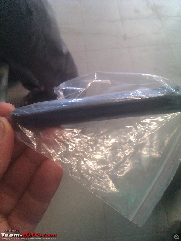

Just back from M&M A.S.S Modern Motors, Ludhiana. I was there to replace the tail gate rubber beading which had developed a crack in my XUV FWD W8. Cost of beading= Rs. 500. While talking to the SA, i got to know that M&M has ordered all the service centers to replace 3 parts in vehicles belonging to certain 2012 batches. My car happens to be in those certain batches. Result- Parts that got replaced were -
1.Power Steering Pipe. Sorry i wasnt able to click its picture.
2.Both front Doors window motors. My windows used to rattle when partially down, which is now completely solved.
Here is the stack of motors that have already been changed
3. Edge Part of left wiper. The SA told me that it might cause scratches in the future
The new part
Front suspension bushes were also replaced under request by me and the SA obliged without any question. But its not covered under the recall.
Although i haven't been experiencing any problems with my brakes(got them changed 4 months ago) my SA said they are the latest gen ones by BOSCH with no cuts/grooves. He also said it was an official recall by M&M only for some 2012 manufactured vehicles and said to check the newspapers for directions regarding the same.
I would also like to specially mention the very courteous attitude of all the staff at Modern Motors, they were very knowledgeable and understanding. I have 4 other cars in my garage of different makes, and i can safely say that the attitude of M&M has so far been the best. My car was washed free of cost and i also received my extended warranty certificate. Boy am i loving M&M service, they do pamper a lot! Apart from minor problems like TPMS error, 3 headlight bulbs fusing(475/-per bulb), a bit of squeaks here and there, My XUV experience so far has truly been great(8 months-11k kms). Its completely VFM and i highly recommend this vehicle to everybody. I just hope that in the long run, XUV maintains its charisma and reliability.
