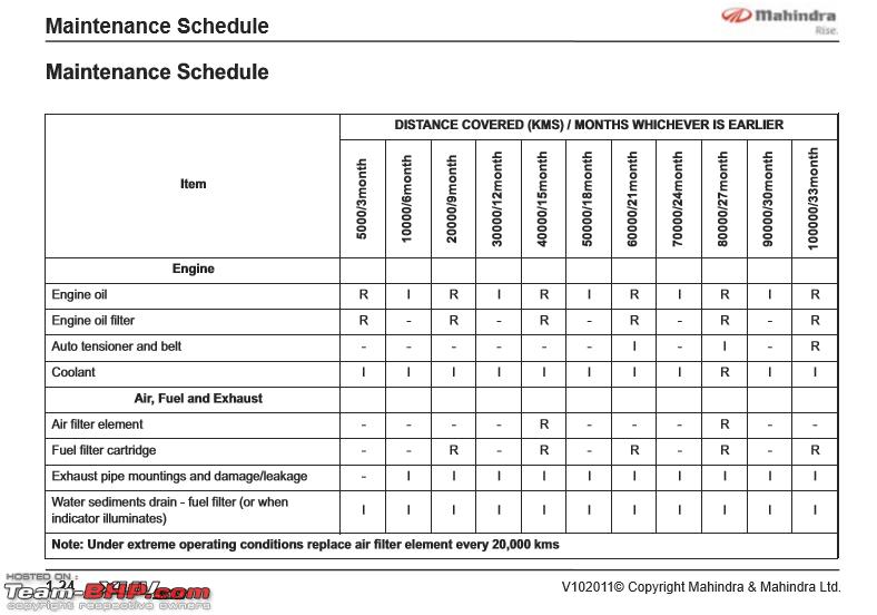

Hi
Is anyone aware of the change in the Service Intervals for the XUV 500.
A friend of mine wanted to book his XUV500 for the 15K service and has been told by the M.A.S.S. that the service intervals have been changed to every 10K kms by Mahindra from the current intervals of 5K Kms.
There is NO change in Service Interval. First service at 5K, second at 10K and thereafter every 10K. Earlier there was a time limitation also of 3 months, 6 months etc. That has been removed. You can take my word for it since my car was delivered on Jan 7, 2013, and that too from M&M 100% subsidiary, NBS International, Mumbai. Good luck with your 20K servicing

Originally Posted by GoSlow View Post
Thanks! Please get some feedback on if they are continuing with the 15K kms service.
My friend had been told that his 15K kms service wil now happen at 20K kms only. I agree with you on the time limit part and I had heard the same but this change of service intervals sounds a bit fishy!
Only the first two services are at 5 K interval. After that , the service interval is at every 10K and oil change at 20K. Now M&M is only tracking the Kilometers done and no more time bonded services. This is mainly due to the sheer work load service stations were at in handling so many vehicles coming in for scheduled maintenance with more than expected non-scheduled running repairs.
