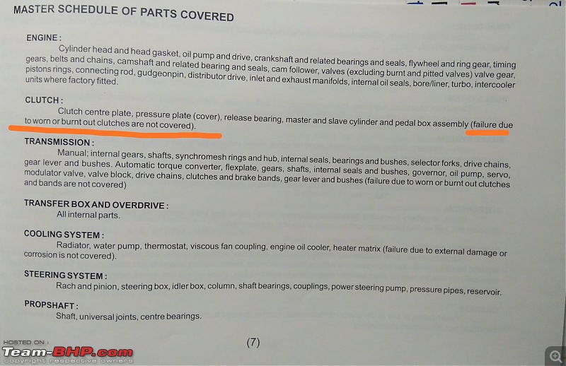

Originally Posted by witwat View Post
Hello all! Going through a tough time analysing the problem. Hope to find some solution here.
Just wondering if any had similar experiences or possible solutions here. I would be visiting the service centre again but need some clarity to explain or get the issue fixed. TIA
* UPDATE *
Finally found the issue. Meanwhile, I was lucky enough to stumble upon this video (shared below) and was very informative
Understanding the system of how a clutch works, and relating my issue to the experience occurring from a faulty spring in a "push-dot ballpoint pen" I had a strong feeling of error in the "spring system" involved to engage a gear. Having felt so, I visited the FASS again and asked them to open the clutch assembly to inspect the same. Having opened the assembly, they witnessed the coil spring to be broken as seen in the pictures below.
However, from the FASS opinion, the clutch plates are still fine since they seem to have more life in them but the coil spring in between had been broken either due to the incidental damage occurring from the pressure plate or engine power flow fluctuation.
Meanwhile, I am on way to reach the service center to collect the vehicle with a deep thought why was the master cylinder replaced in the first place!
Sharing this update if in any case can help other motoring enthusiasts.
