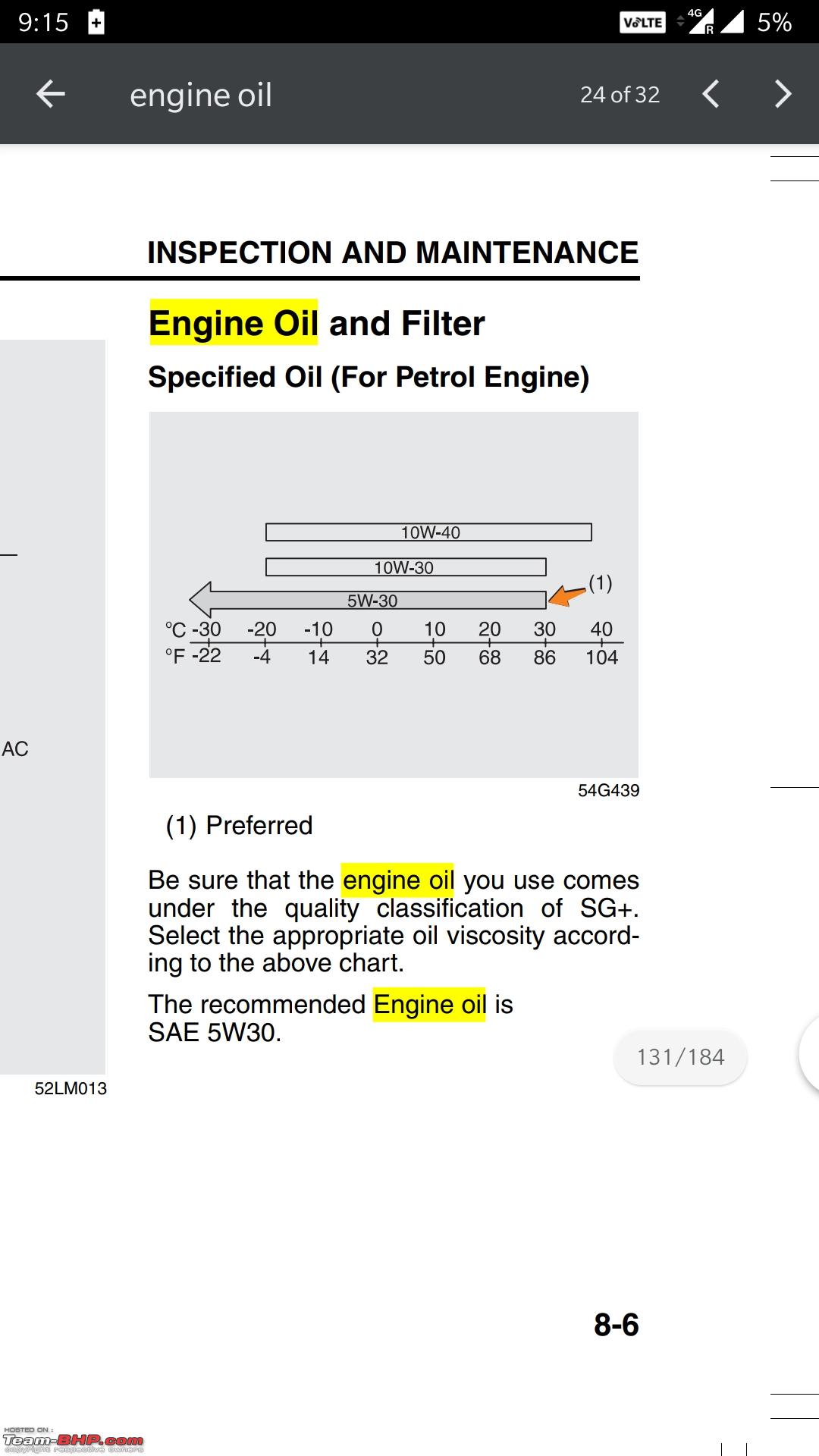

Yes, online user manual suggests the same (5W30).
But i heard that, later on Maruti updated oil specs of all engines to 0W20.
Online catalogues also suggests 0W20 engine oil (4.3 litres).
That's why i am confused.
Please find the attachment which justifies my confusion.

Firstly, avoid referring to any third party source like the one you have posted above(mycarhelpline). When in doubt, always go with the recommended grade in your owner's manual.
Secondly, Maruti has now started recommending 0W16 for new engines. They keep on changing the grades with minor changes in the engine. For older cars, since the engine is the same it came with, the applicable grade should logically be the same which is mentioned in the manual and not the one which MSIL is recommending for current cars. Hope you understand this. Also for SX4, it always remained 5w30 AFAIK.
Shell Helix HX8 5W30 or any other nice synthetic oil will be my choice.
