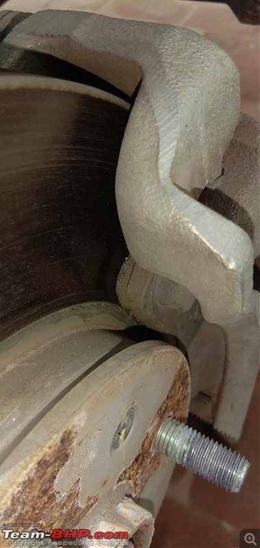

Hello to everyone. I have a 2014 Verna which has run for 64000 kms and is still on stock brake pads. During the last service the service executive advised against changing the pads saying they were still good but i wasnt convinced so took these pictures during the wheel alignment and balancing. Kindly advise after taking a look at the pictures as to the condition of the brake pads as i feel the bite has reduced since some time
The pad and rotor look OK with about 6-8 mm left. Very good for a car that's done 64K kms. How long will they last? Difficult to say because it generally depends on your driving style. Also, sometimes you need to check the pad and rotor surface on the rear (caliper piston) side to ascertain wear. This part generally wears out faster than the outer one. These parts may need a clean up to remove any dust, grit and other substances that build up over time. I'd suggest you get the brakes serviced and have caliper pins lubed without having the parts replaced for now.
Thank you. I use the brakes judiciously and instead use a lot of engine braking, plus the car also does a lot of highway drives so I guess all those factors come into play.
As a matter of fact i have always denied getting my brakes cleaned and 'overhauled'(as the service centre guys say) as i believe disc brakes are inherently self cleaning but now after so many kms i believe i should get them serviced once as you say.
You obviously have good driving habits. The long lasting brakes are a testament to it.
Disc brakes are self cleaning compared to drums because they are open and exposed to the elements which helps to get rid of any muck stuck to the parts. However some dust and grit can get embedded in the pads and can score the rotors over time. Plus the braking forces and high temperatures during braking operations can cause some parts to wear out unevenly especially the part that we cannot easily see i.e. the inward pad and face of the rotor.
That's why it is important to have these inspected or serviced at least once every 2 years or about 20K kms whichever is first. And after 64K kms a service is definitely due if nothing but for an inspection and if required re-lubing the caliper pins. The brake system is critical for safety. Make sure you are following any maintenance scheduled prescribed by Hyundai.

Thank you for the insights. Yes as you pointed out i should get them thoroughly checked especially after the mileage the car has clocked. Also i feel the braking seems to be kind of weak now so thats all the more reason to get everything inspected.
