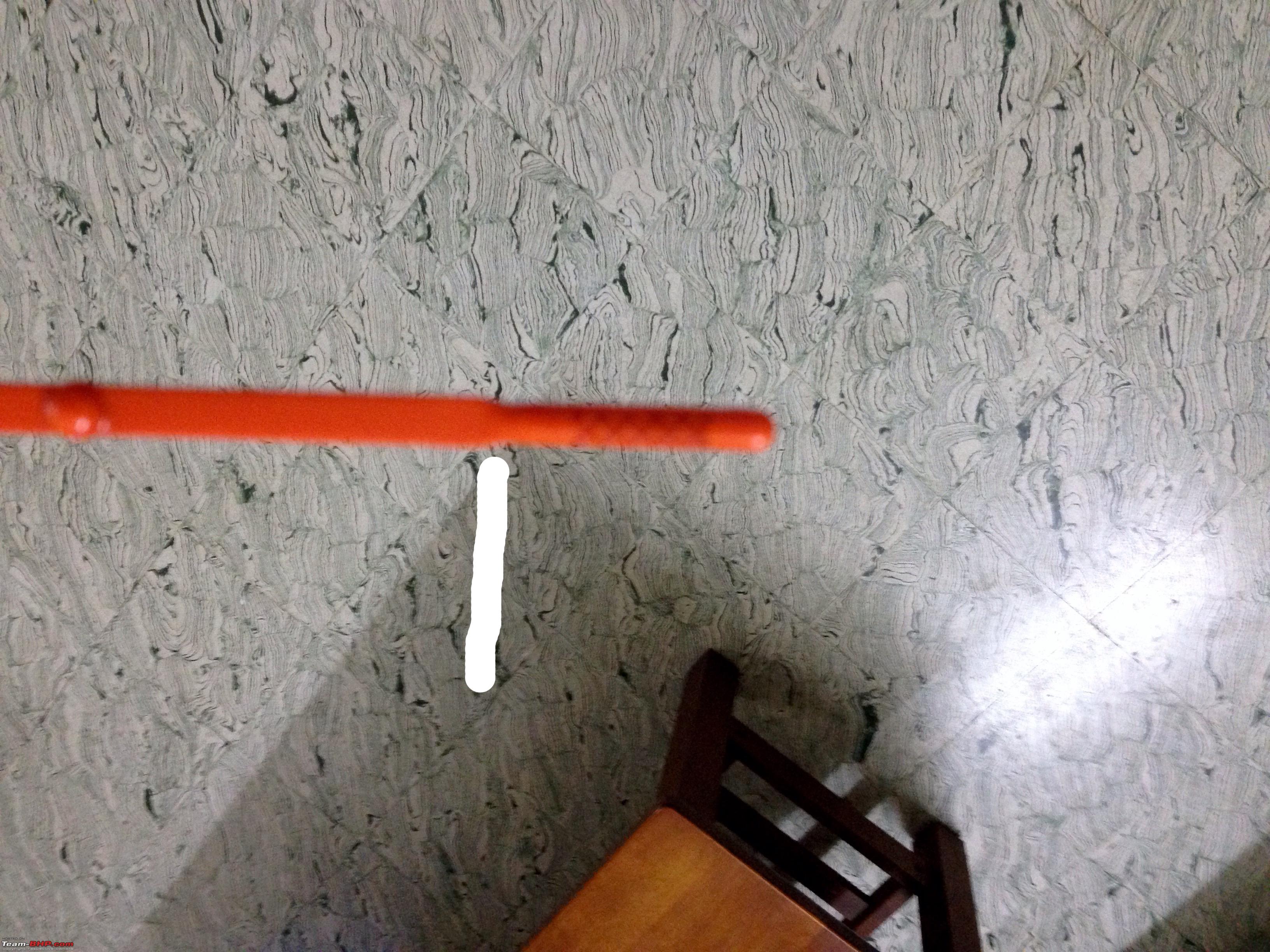

Depends upon how much more than the upper limit. If it is more like a couple of millilitres then I wouldn't worry. If substantially more then it can create more than required pressure and may lead to a leak in the head gasket leading to big service bills.
Regards.
Thanks for the response saket77.
The oil level in the dipstick is up to the white line marked in the picture.
Honda Civic : Maintenance, Service Costs and Must dos-image.jpeg
If I recall correctly then the upper limit is the area with cross texture. If that is the case then you need to drain about quarter to half litre of oil.
Regards.
Regards.
Thanks. I would go to the service centre and drain out the oil
