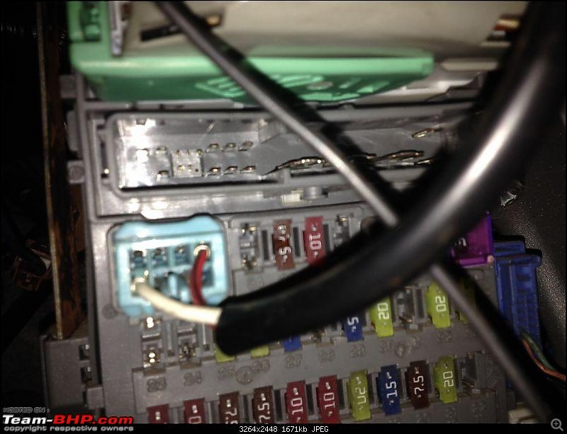

Had ordered a roll of warm white LEDs which I cut into smaller strips of 6-10 LEDs. Tapped the cabin dome light wire from the MICU under the driver's side dashboard and placed a 570 ohms resistor to limit the flow to LEDs. The correct wires to tap are the green and pink wires on the extreme right blue connector of the MICU.
Honda Civic : Maintenance, Service Costs and Must dos-1image.jpeg
Tap the wires of the blue connector on the extreme right. Pic wasn't taken for this purpose hence focus is not on that connector. This is a reference only.
Once you have tapped the correct wires, installation of Footwell lights is an easy tasks mainly asking for fixing the LEDs and concealing the wiring. I concealed the wires by running them behind the running board trims.
