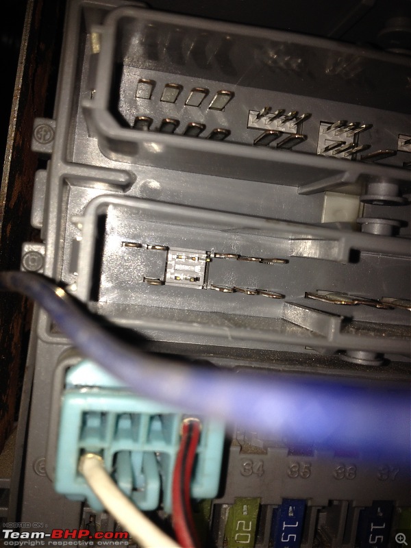

Some electronics are again malfunctioning on my Civic. I performed the gauge cluster diagnostics which is built into the Civic's MID. You can perform the test by following the given sequence:
1. Push and hold the trip/reset button.
2. Turn the lighting switch ON.
3. Turn the ignition switch ON.
4. Within 5 seconds, turn the light switch OFF, then ON, then Off again.
5. Within 5 seconds, release the trip/reset button, then push and release 4 times more.
The odometer has to be in mileage mode and not in the trip mode. All dash lights will blink continuously and the RPM needle will do a complete sweep and then display any errors if there is a communication failure between any of the modules.
Now Honda has 2 main communication modules that run the entire system and report to the Gauge control module. First is the F-CAN and the other is B-CAN. CAN means Controller Area Network.
F-CAN relates to all realtime information modules like fuel injection, emissions, etc which are very critical and hence the network bus is faster. The B-CAN is slower of the two and control other lesser important functionality like climate control, outside temperature sensor and indicator, door locks, the head unit/ stereo etc.
Coming back to the sweep test/ gauge diagnostics, if the MID displays Error 1, then it signals a communication failure between the Gauge control module and the F-CAN while Error 2 relates to the B-CAN.
My car was tested with HDS (Honda Diagnostics System) at HASS and it showed errors relating to the body control module. The gauge diagnostic which I performed at home threw error 2, indicating problem in the same module. My problem is intermittent, means the climate control, HVAC and the key-in reminder fail to trigger at certain times.
Now, the possible causes of this failure can be:
1. Faulty/ poor grounding
2. Open in wire
3. Loose contact at some joint or coupler
3. Faulty Gauge control module which means replacement of entire speedo panel.
I am still reading more on it and trying to solve my issue. Will keep you guys posted about more on this. In case someone has a clue, please chip in with details.

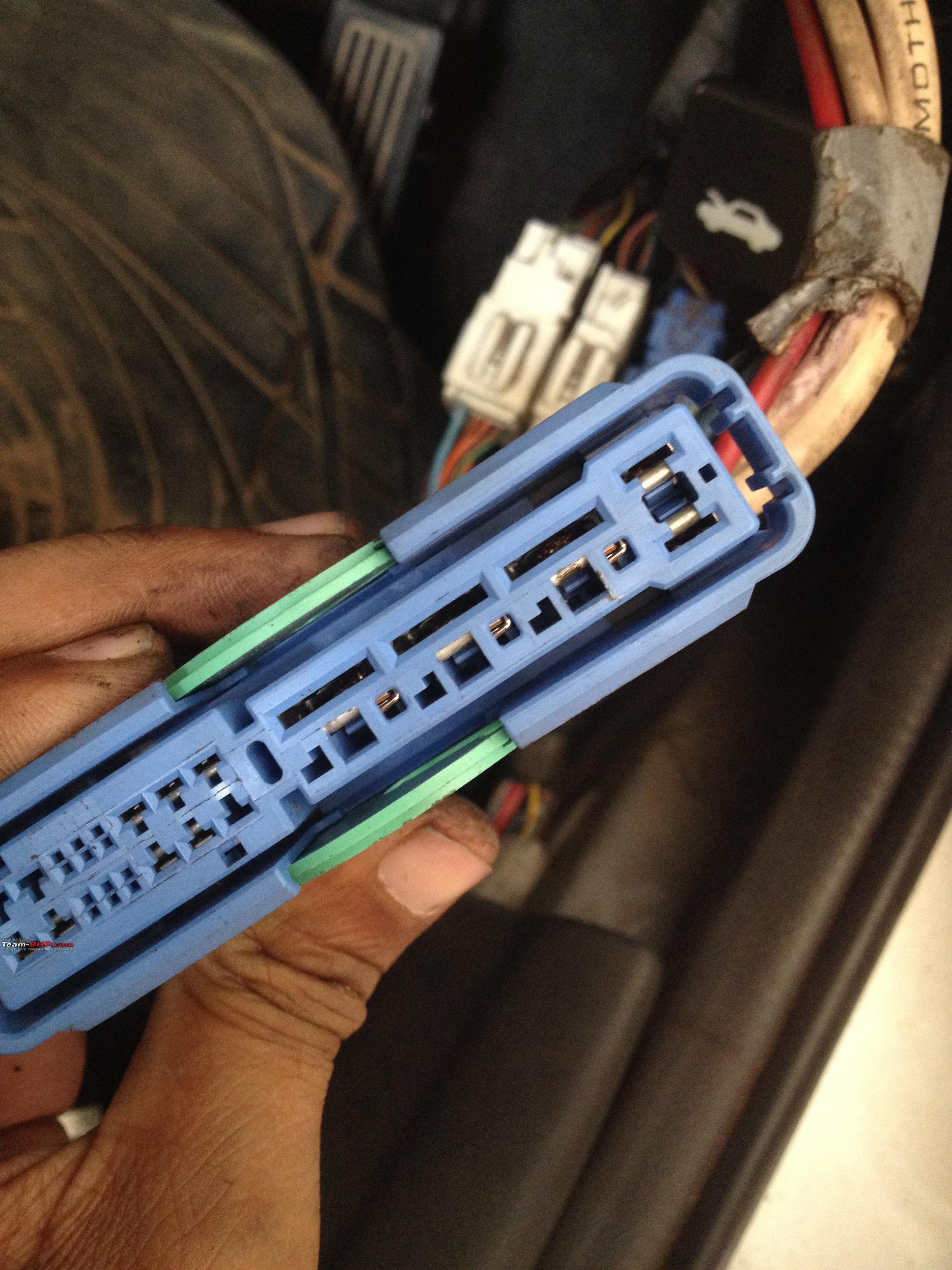

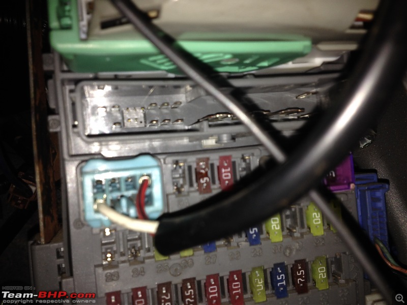

Thanks guys for your suggestions. @Sumeet: Yes, it's been raining here continuously for 5 days. Some respite since yesterday. Moisture issue is definitely on my mind.
@R2D2: totally agree. But finding someone to do this job is difficult. HASS guys are definitely least interested in such stuff and most FNGs here are not capable of handling a car like Cjvic with complex electronics.
Ok, update time.
I decided to get my hands dirty this time and checked all fuses in the engine bay first. All ok.
Then I targeted the MICU, which is along with the fuse/ relay box under the steering wheel near the driver's footwell. First took off the fiber trims along the running board, footwell area and the complete Dash trim under the steering wheel. This made some space to work with the MICU.
First checked all fuses in this area too and found all to be okay. Then With the key in the key cylinder, I started pulling out the multi connectors one by one. I found that the last of the 3 broad coupler connectors power the affected module. The key in reminder alarm which was silent until this time started sounding while I was disconnecting the third connector. The rhythm of the alarm kept changing signalling loose/ intermittent contact with this harness coupler until I pulled out the coupler. Obviously it stopped after pulling it out completely.
Checked voltages as per the service manual and grounding continuities with all wires and they looked okay to me. And then I noticed one slightly corroded contact point in the coupler. Cleaned it, sanded lightly by putting in a small rolled up sand paper. Cleans other contacts too and fitted them back one by one.
Since then, the problem has not re-occurred and I'm hoping it remains that way. I'm not sure if this was the issuer, but I will post the results when it becomes conclusive by test of time.
Posting some pictures of the job:
Honda Civic : Maintenance, Service Costs and Must dos-image.jpeg
The harness coupler- the third point was corroded.
The 3 coupler harness of the MICU:
The coupling points of the MICU harness:
The gauge diagnostic test run after clearing the Error 2:
Thanks!
