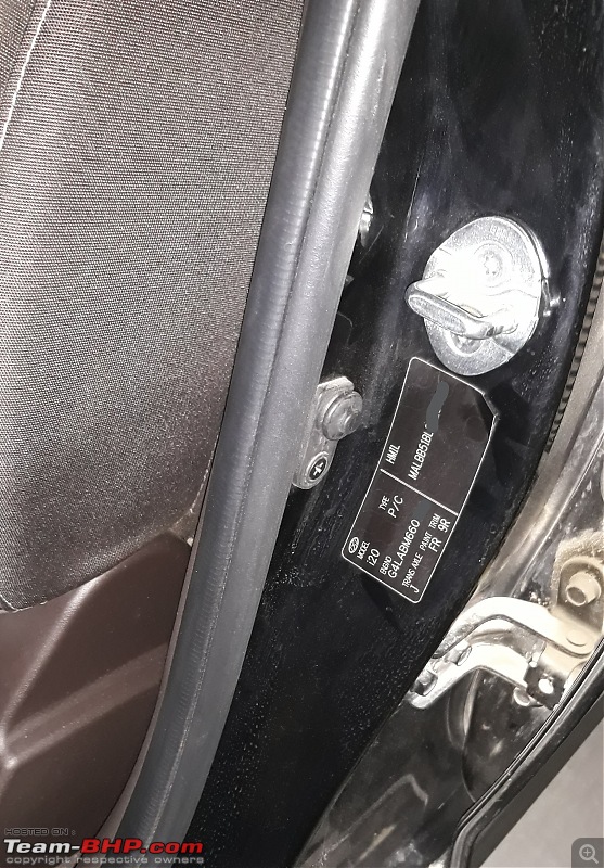

A friend has recently picked up a 2013 i20 Asta Petrol. Normally in Hyundai’s the chassis number is available under the driver seat as far as I know but in this case the carpet is stitched and there is no opening to take a chassis number print. Can any of the owners guide me to an alternative location of the chassis number or any other way to remove the carpet to trace the number? Thank you.

In My 2011 model i20 Asta, I see another location. Near the Front passenger door. Engine, VIN etc are stuck there also in a black sticker.
//hkp

Thanks. We found it under the Driver seat only but unfortunately we had to cut a part of the carpet to get the tracing. As far as I have seen in i10's the chassis number part is always cut from the carpet. Surprised to see it hidden in the i20 facelift.
