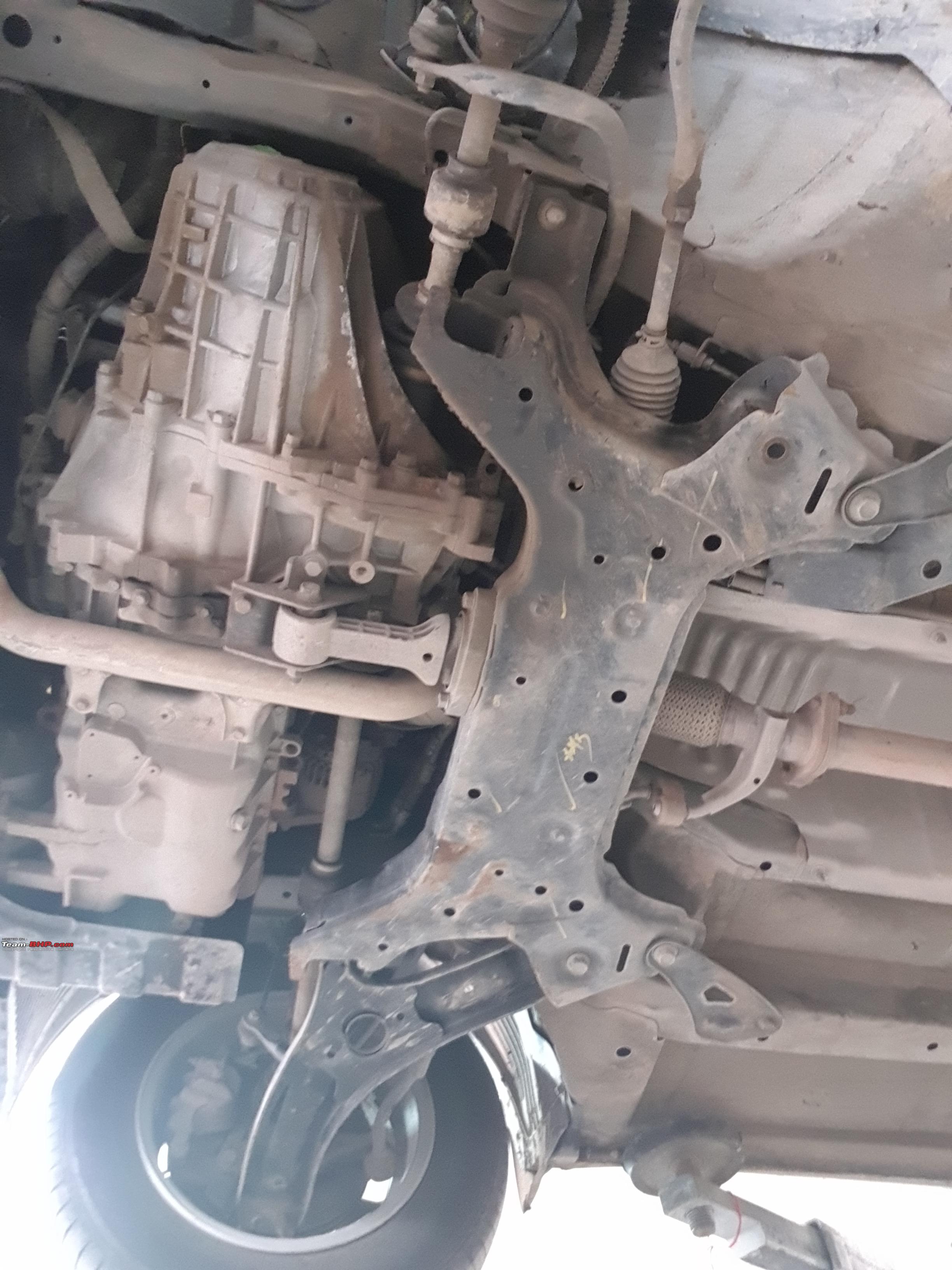

Hi everyone,
I have been having a problem with my 2013 i20 Sportz CRDi. My car met with an accident in January this year. The entire front and rear suspension had to be changed along with the radiator, left front fender and fog lamps. Reportedly no damage to chassis or the engine. Work done was upto my satisfaction and the car was driving fine for the next 4000 km. That was until i drove to Kasauli from Chandigarh on a particularly bad road. After that the car started having "Khat Khat khat" kind of sound while braking to a complete halt, starting from rest and particularly driving in a relatively higher gear at low speed. This was associated with vibrations, not in the steering but more generalized in nature.
I went to the Hyundai dealership from where the post accidental repair had been done. It was found that a nut joining the front left swing arm and the main chassis cross member was worn out and loose. They put in a different nut but even it could not be screwed in tight. It was seen that the part where the nut goes in the chassis cross member had become deformed and the socket was damaged. They gave me 3 options,
1. Drill the socket of the cross member and put in new rings and then an oversized bolt.
2. Drill through the entire chassis after cutting off a part of the chassis and put in a nut and a bolt.
3. Change the entire chassis cross member which would cost about 18000 plus labour and taxes.
Even the service guys are not very confident about the integrity of repair in option number 2. Please give your opinions guys.
1st-gen Hyundai i20 (2008 - 2014) : Review-20171109_103725.jpg
1st-gen Hyundai i20 (2008 - 2014) : Review-20171109_122247.jpg
1st-gen Hyundai i20 (2008 - 2014) : Review-20171109_123114.jpg
1st-gen Hyundai i20 (2008 - 2014) : Review-20171109_123953.jpg

Change the cross member. It is a very critical component holding all the front of your car together.you would not want to cut corners in that.
Thanks for the quick response. Even I want to change the cross member but it's taking them about 2 weeks to source the part. I don't want any "jugaad" work done here.
