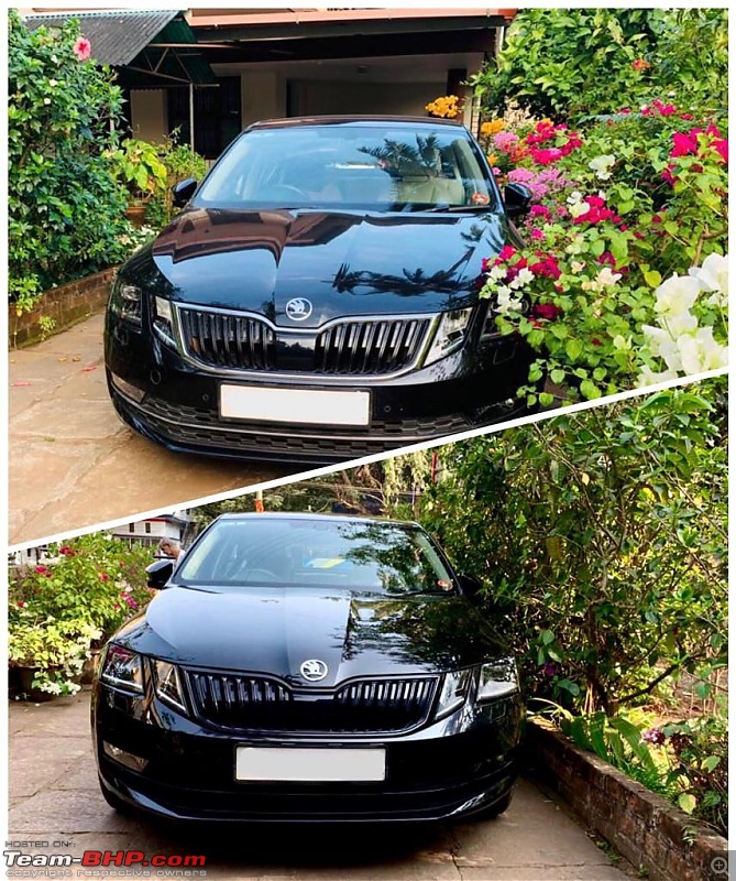

Sandygordon’s pic inspired me to put a pic of my dechromed front grille. Simple sticker job.
Review: Skoda Octavia (3rd-gen)-945b1a702ebb4cd292faf29f35bf96fe.jpeg
Review: Skoda Octavia (3rd-gen)-3d63be206bdf449daaa12cff8f8657b7.jpeg
