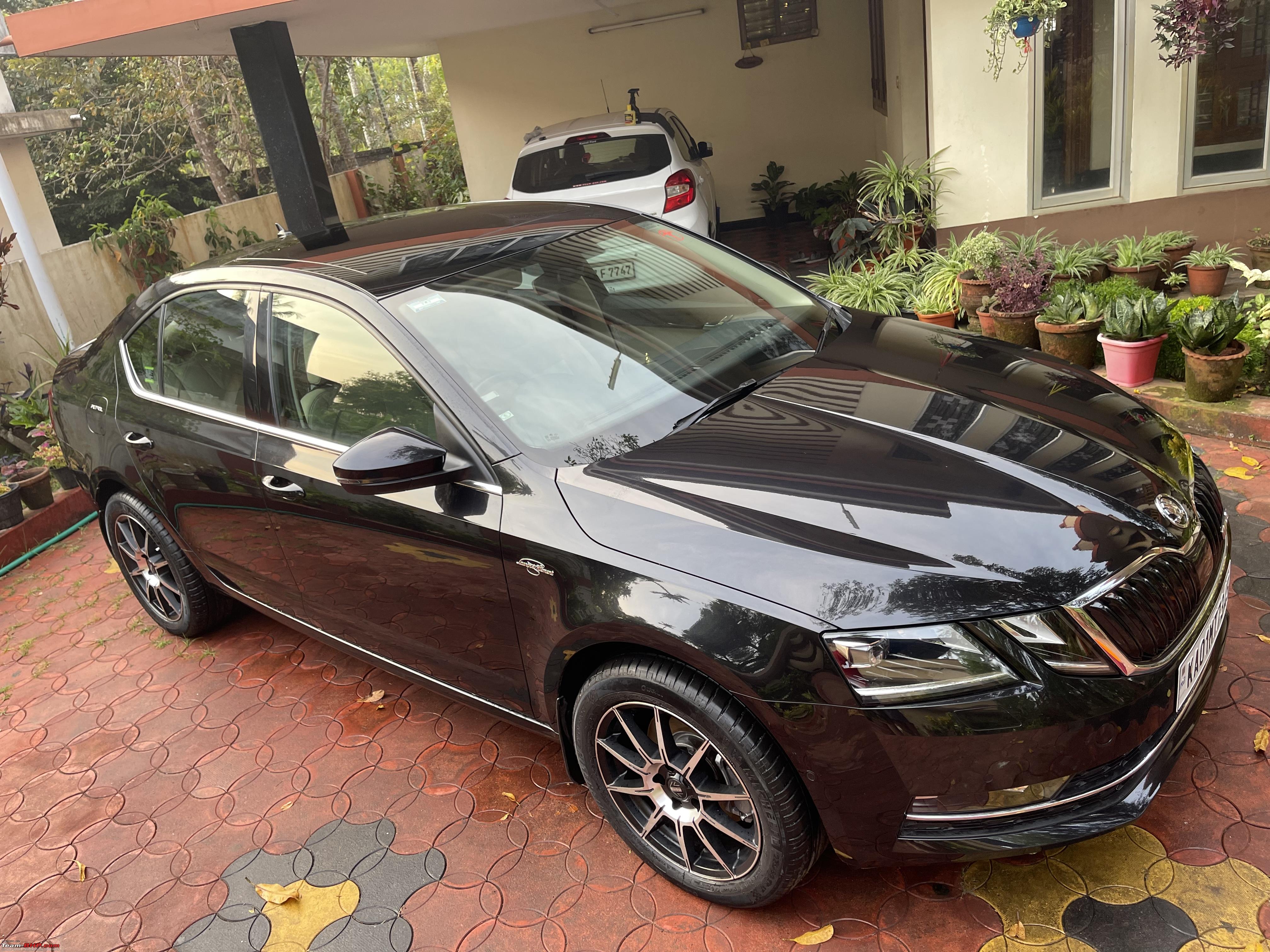

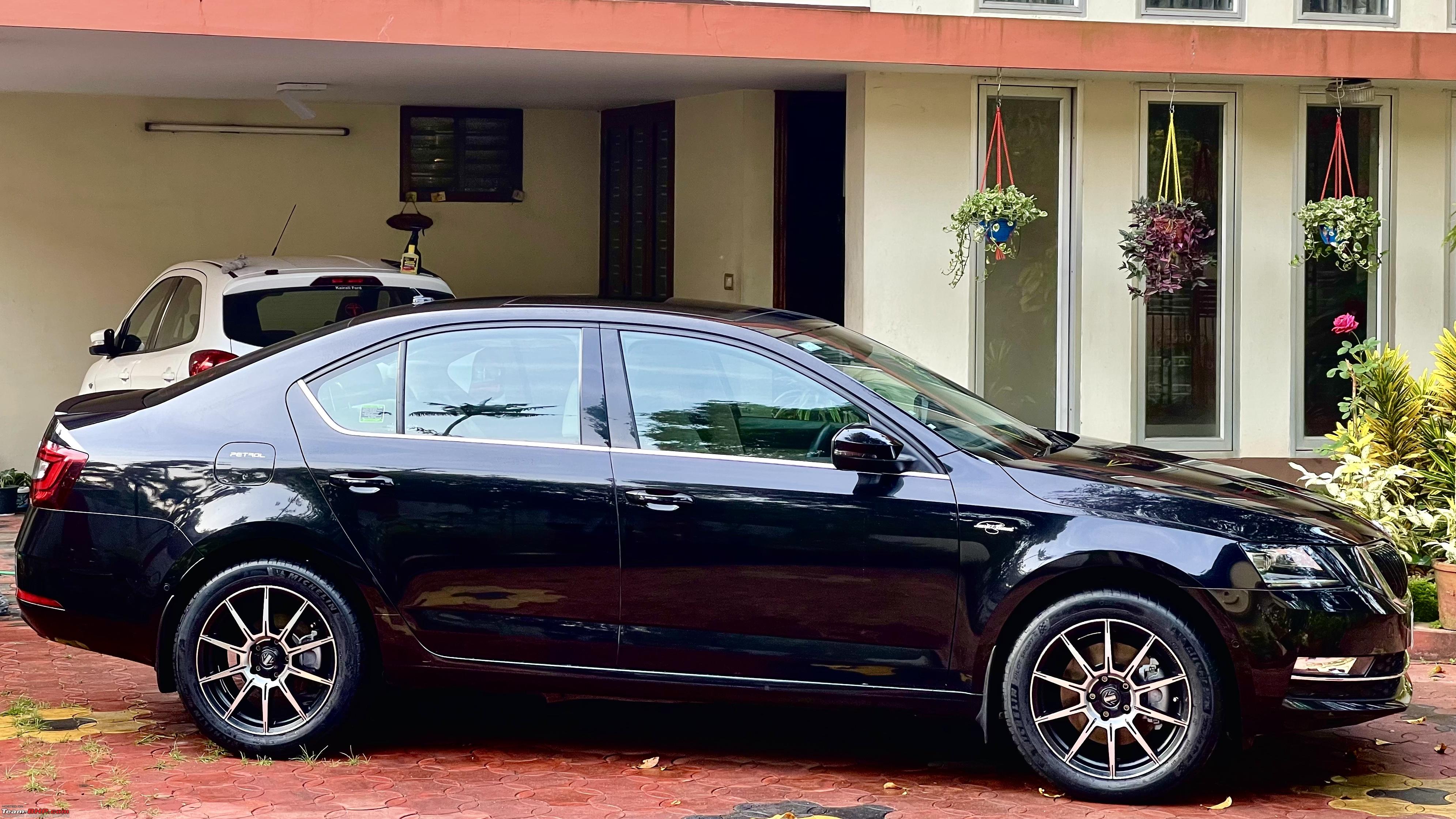

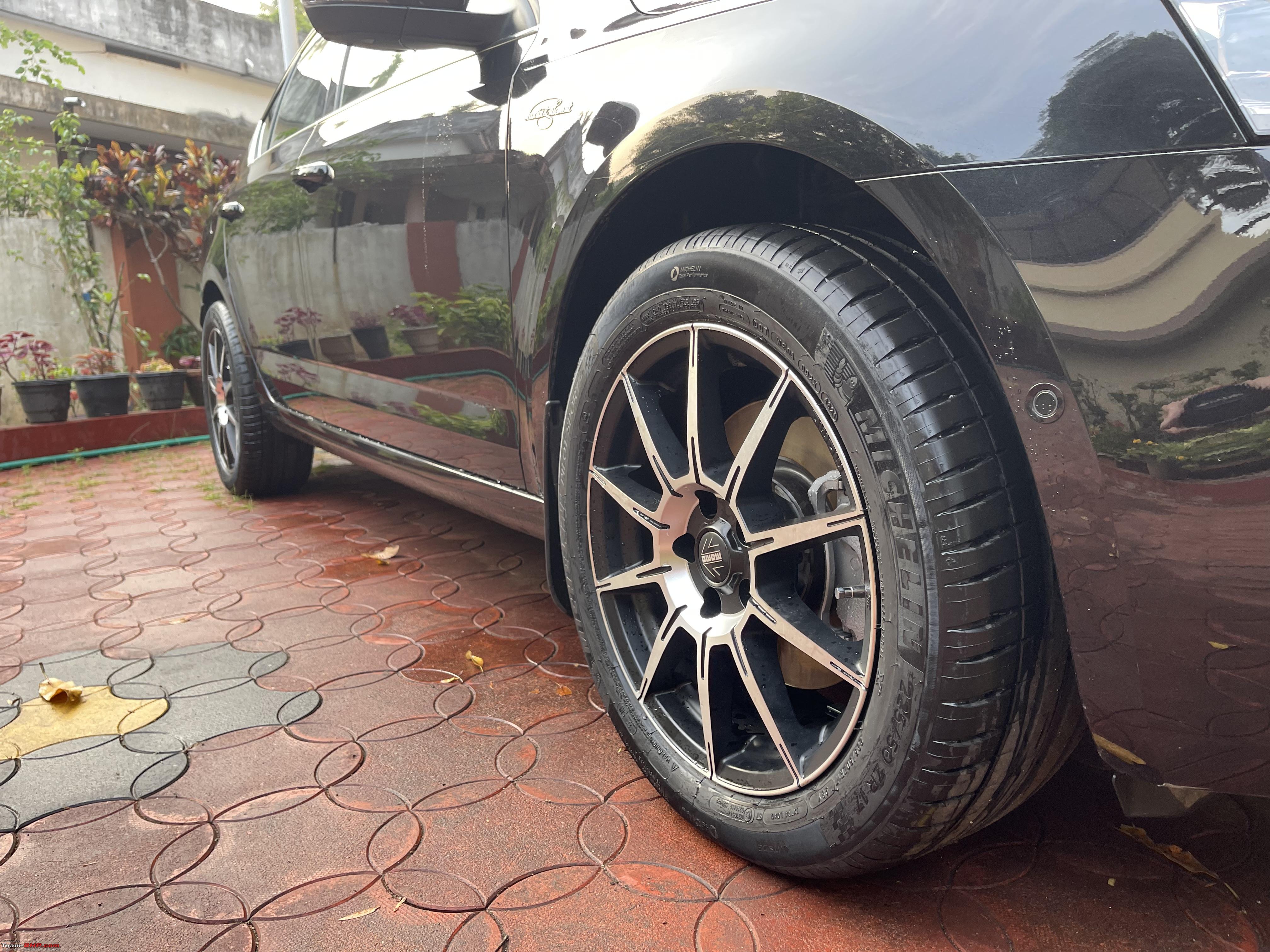

At last took the plunge
Review: Skoda Octavia (3rd-gen)-608b9fe04cd14de0bb5e691deccc3e30.jpeg
Upgraded alloys to 17 inch Momo Rush and tyres to 225 50 R17 Michelin Pilot sport 4. Drove on 34psi.
Differences noted
- Steering is 25% tighter
- Ride has become a bit more “crashy”
- Grip is vastly improved
- Tyre noise has increased a bit compared to Goodyear eagles
- Body roll has reduced though I am riding a bit higher now
- Will have to see the real world FE drop. Felt it has dropped by 1kmpl. I will have to wait and see the results.

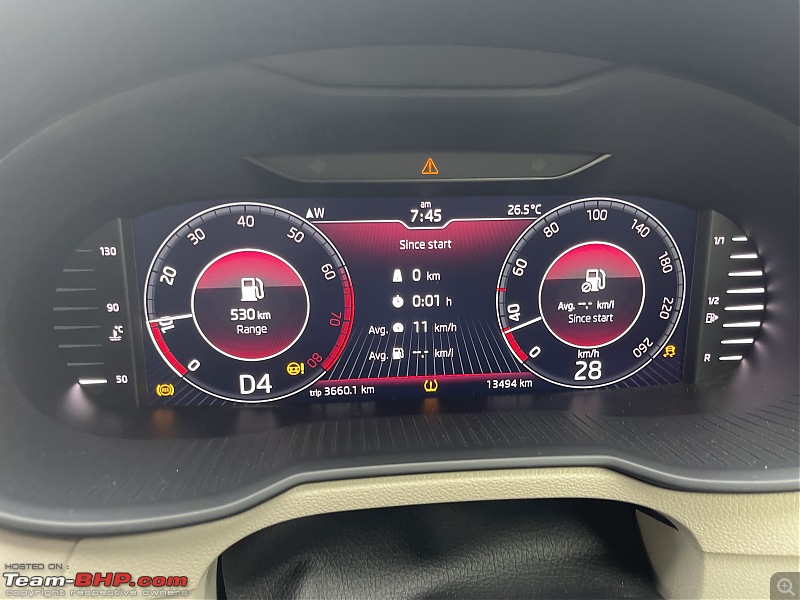

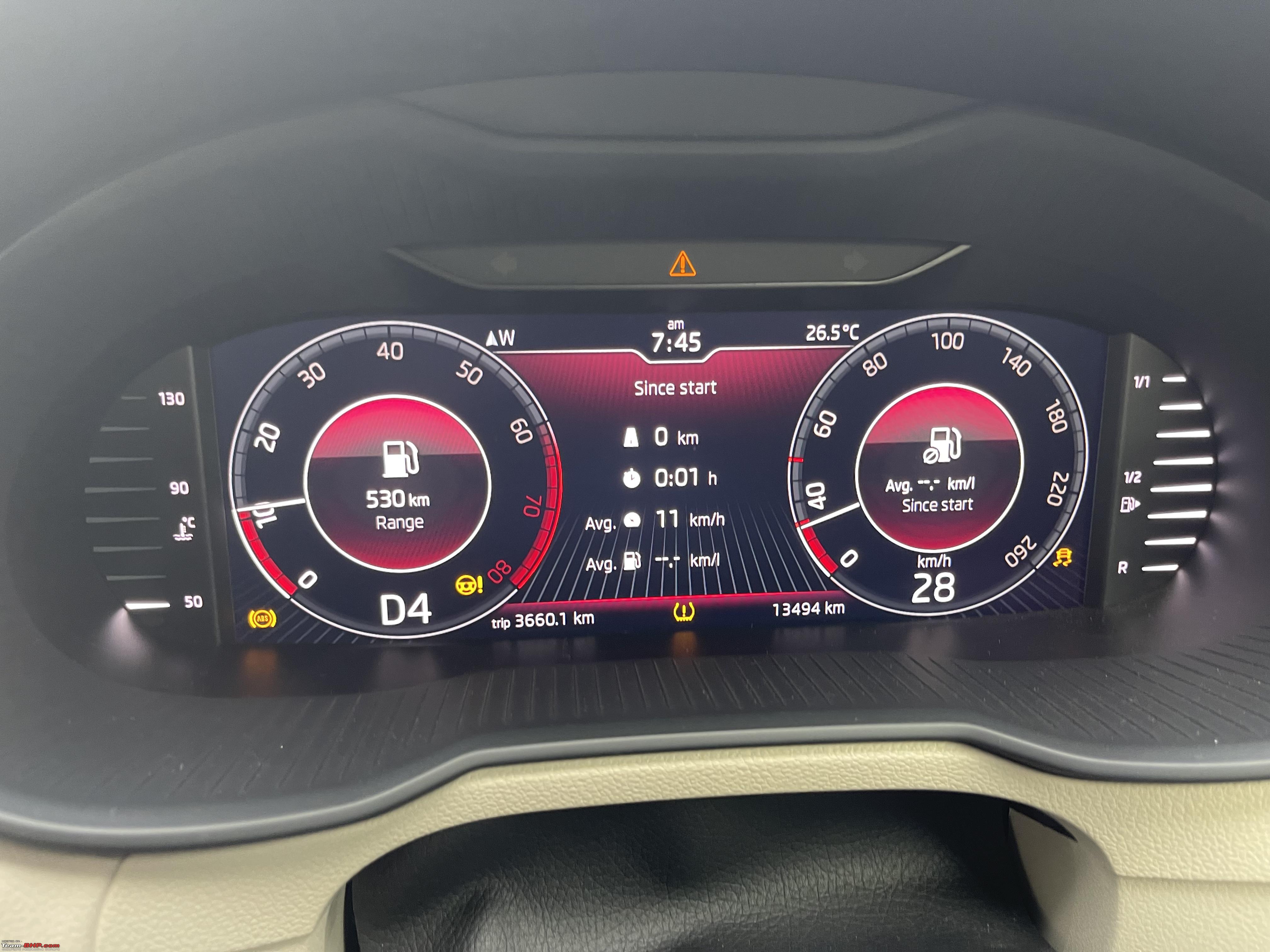

For past 2 days, ie 4 days after tyre upgrade I am getting all sorts of errors, errors of ABS, TCS, Power assist for steering, TPMS, Park pilot and manoeuvre braking. All these disappear after engaging in park mode with engine on for 20 -30 seconds. Should I be worried? What is the fix?

Mostly the ABS sensor would have gone kaput. Or some dirt in the sensor.
If your vehicle is not under warranty, get it done from a FNG. Else take it to the service center, but they might ask to change wheel bearing too.

In addition to the above advice, how old is the battery? VAG cars are notorious for flashing multiple error messages if the battery is weak (i.e. > 2 years). Further, did you by any chance disconnect/reconnect the battery or water wash the engine bay?
Do get the battery voltage checked and ensure a tight fitting of the terminals. Don't stress - do the above few checks and all will be fine.

Were you able to resolve these issues? I would blame it partly on the tire / wheel upsize. The correct upsize should have been 225/45/17. You have increased the wheel diameter by quite a lot. It could be one of the reasons why these errors are popping up. If its not too late get a set of 225/45/17 tyres. Your tyre shop might take the current tyres as buy back for almost the same price as you bought them, assuming here that you wouldn’t have clocked a lot of kms on them yet.
