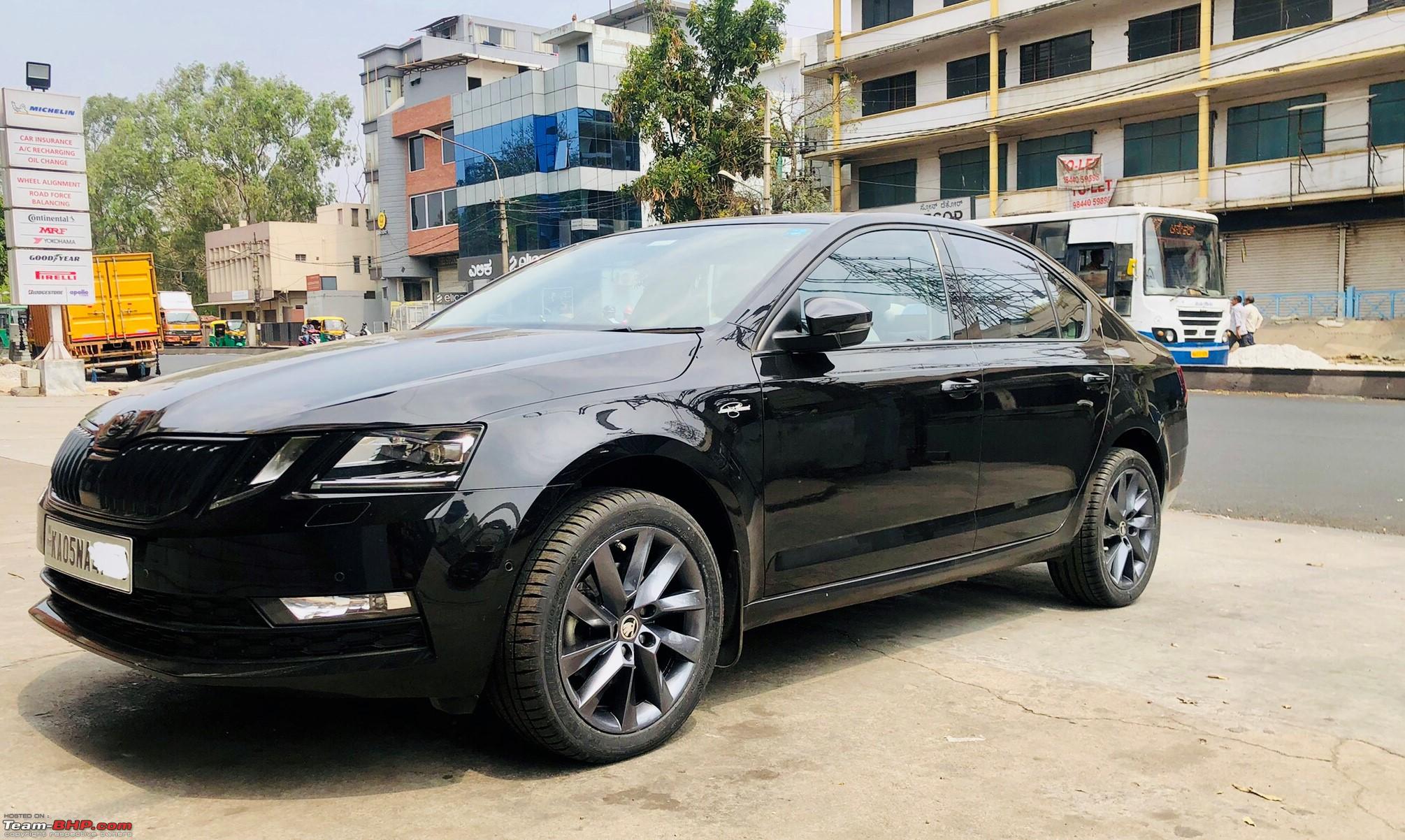

Thinking of dechroming / painting the chrome black - on the front grille. The window sills would be difficult I think.
However the alloy wheels do shine and the Seltos experience has got me addicted to a bit of chrome. Will be trying the sticker wrap this weekend.
Attachment 2296962
Do let us know how it goes. I am toying with this idea too. Had mine roof wrapped black, now the chrome elements are standing out (not in a good way)

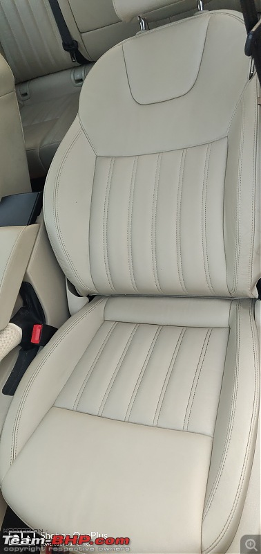

Hi friends,
Yesterday I gave a brief trial to clean both the front seats in my Octavia. It was my first such DIY attempt & still without much efforts, I could manage to achieve reasonable shine.
In fact, I was a bit sceptical to visit the nearby Car Washing/ Servicing Centre for the purpose. So, I just went ahead with the 'Interior Cleaner' liquid from the Car Care kit, I got as complimentary at the Skoda ASC during last annual servicing.
The process was simple that took 30 minutes for the entire job.
1. Spray the liquid over the surface to be cleaned.
2. Wait for a while to moisten the muck.
3. Rub gently with Sponge supplied with the kit.
4. Wipe out with a moist microfiber cloth to dry the surface.
That's all !
You can see the difference in the pics attached.
Also please suggest if there is any need to go for any specific Leather Conditioner post cleaning.

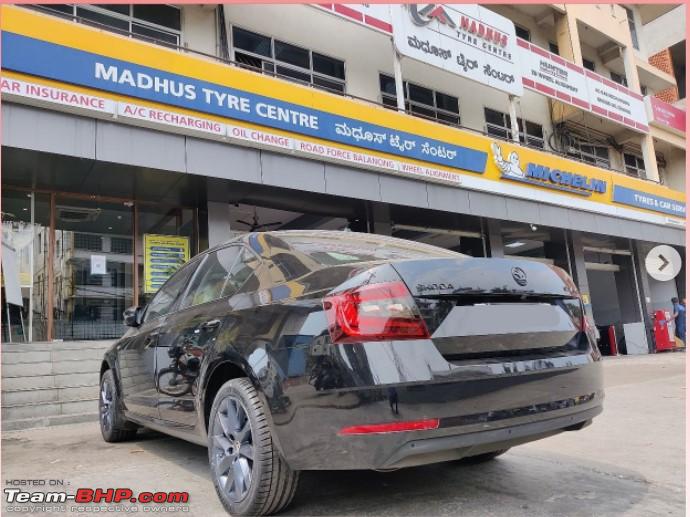

At last took the plunge
Upgraded alloys to 17 inch Momo Rush and tyres to 225 50 R17 Michelin Pilot sport 4. Drove on 34psi.
How are you managing it at 34? Isnt it bouncy?
I have the same 225 50 R17 PS4 and it was uncomfortable for me at 32, dropped to 30 and its manageable.
Picture Credit
Cheers!
Arun

Originally Posted by treadmark View Post
Damn, it looks sexy. The dechrome looks super cool - did you get it painted or wrapped?
On tyres, I am running with 225/45/17 with 33 PSI (cold pressure) and that works well for me.
It was bouncy at 34. Dropped it to 32 and it is manageable for me. Have to slow down at low speeds on humps though.
Wrapped window belt line molding and front grill surround. Skoda logo is a black replacement piece from AliExpress (bought when they were shipping to India), Skoda and Octavia letters were painted.
To me, anything above 30 is painful on broken roads, couldn't manage even on 32.

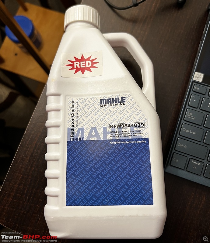

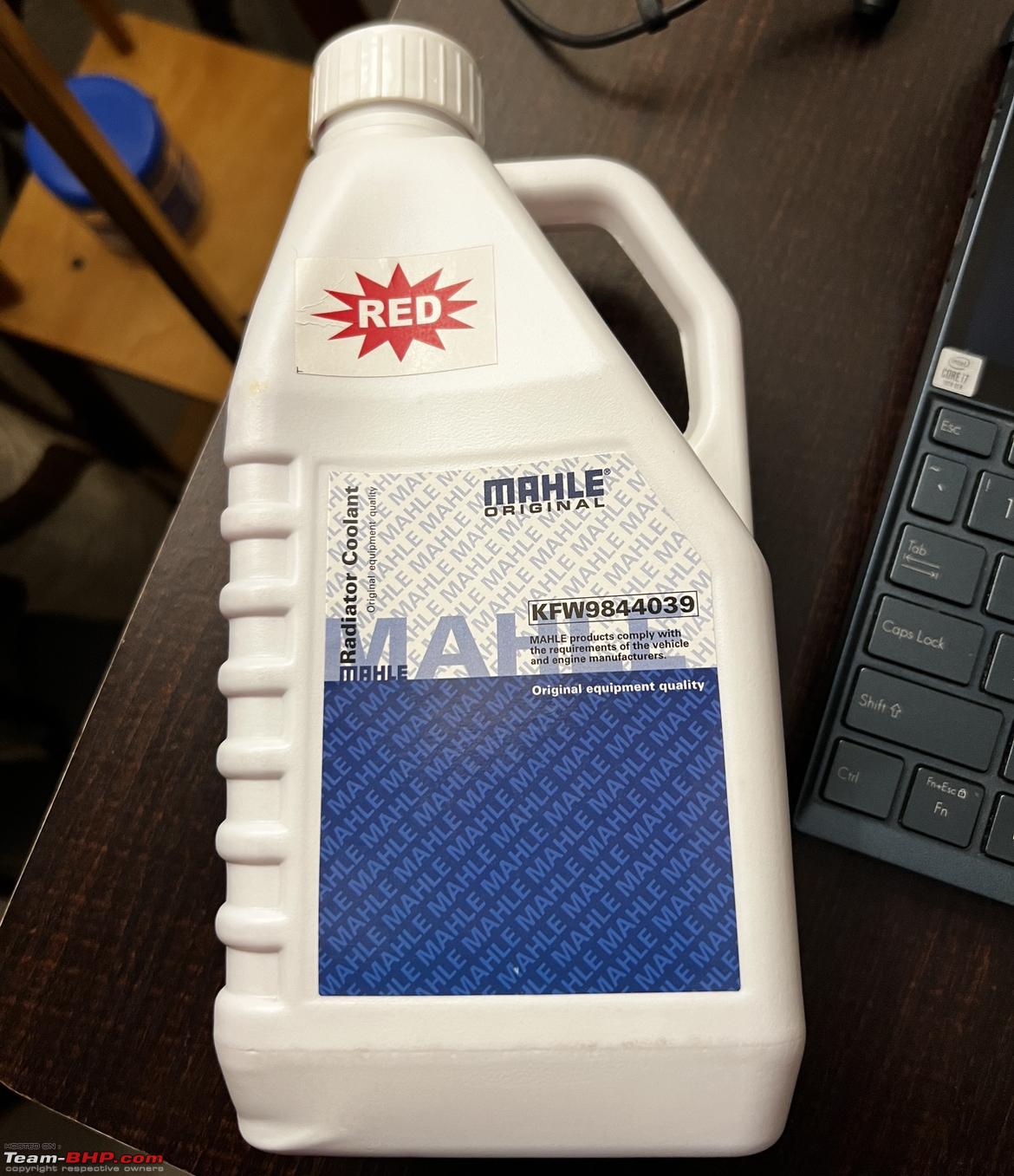

I got a coolant light in my 1.8 TSI today, can any fellow owner confirm if it’s okay to top it up with MAHLE KFW9844039?Review: Skoda Octavia (3rd-gen)-5a24ade575b446029305605d40869cf2.jpeg

Originally Posted by revsperminute View Post
I got a coolant light in my 1.8 TSI today, can any fellow owner confirm if it’s okay to top it up with MAHLE KFW9844039?Attachment 2306524
Which model is your and what is the ODO reading?
The coolant level normally does not go low.
The same thing happened to my car and within 500kms the water pump failed.
i would suggest you to get the water pump checked and replace it immediately.
prajnya is offline

Re: Review: Skoda Octavia (3rd-gen)
Actually a couple piece was replaced a few months back and the whole system was checked thoroughly for any leaks. The coolant level is alright, the light went away after stopping the car and restarting it and has not appeared since then in 200kms of driving. I have kept an eye on the coolant level and stored some VAG premixed g12 evo coolant in the car.
It's a 2015 1.8 TSI with 46k on the odo.
revsperminute is offline
