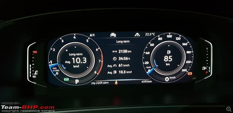

I returned after a 5 day 2100 km drive. FE as expected in normal drive mode and high speeds at times could only manage 10.3 Kmpl.
After entering Delhi last evening, I switched off at a traffic light. On turning on I got a voice message saying SOS contact customer care immediately. This was followed by an alert on the dash and blinking of the SOS button next to the sunroof screen. I pressed the SOS button, the voice command said retrying a few times but could not connect. The only option was to press the button again and cancel.
The alert also went off on cancelling. Will take it to the service station on Saturday.
Anybody experienced anything like this?
PS- the auto braking works in reverse mode too. While I was reversing at Jaisalmer, two fighting bulls literally came from nowhere and the car braked with the crash sign coming up on the display.

Adding the pic of the dash for red… see the sos sign and the exclamation on extreme left
Sanjoy
This is quite common in all Allspaces and TRocs. In the new TRoc I am told they have disabled this panel and hence no warnings anymore.
The crux of the issue is that our car comes with an embedded SIM that could have been activated in Europe as the car was intended to be sold in Europe. But, VW does not have a partner in India for the same. So, once in a while, the system checks for the connectivity and sends this SOS warning that the SOS is not set up properly.
I complained about this in the beginning in Nov last year and they replaced a Control module in my car under warranty (It takes 3-4 months for the part o arrive from Germany). Post the replacement, initially, the error went away for like 6 months but it has started to recur now, but less frequently than before.
--Kalyan
