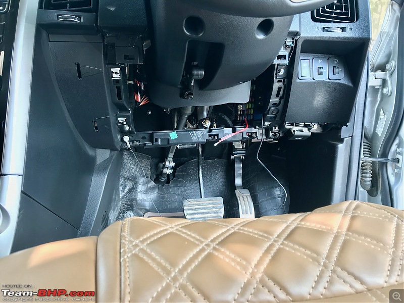

Originally Posted by Mr.Boss View Post
Go for Fuse tap + hard wiring.
So for anyone else doing this on Plush XUV500 with start / stop button:
0. Purchase a fuse tap kit with power conversion like this one. The cameras have micro USB power supply requirement at 5 volts / 1 amp (usually).
1. In the fuse box under the steering wheel, there used to be three 15 amp fuses for power outlets in three rows. Due to start/stop button, now there are only two fuses (2nd and 3rd row) and the third fuse slot one is empty. There is power supply to the third fuse once ignition is on. You can fuse tap this one.
2. Ground connection can be done to the bolt.
3. Get wiring done from a good accessories shop. Authorised service centers don't have the experience in doing dash cam wiring installs and they direct you to the accessories person.
I now have the Transcend Drive Pro 230 dashcam setup on my car.
