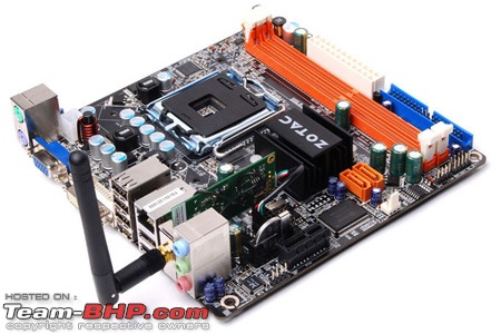

For those interested in mini itx board other than intel atom based in india these two will be available in India very soon. one is intel based for about 4k and other amd based for about 6k.
intel board specification:
New ZOTAC® nForce 630i-ITX WiFi
Powerful, small, dual-display compatible with integrated WiFi
NVIDIA GeForce 7100 graphics processor
NVIDIA nForce 630i media and communications processor
Intel Core 2 Duo, Core 2 Quad, Pentium and Celeron compatible
LGA775 Socket
Up to 1333 MHz FSB
DDR2-800 compatible
Integrated 802.11b/g WiFi
Mini-ITX form factor
PCI Express x1 expansion
DirectX 9 with Shader Model 3.0 compatible
Extended warranty (Please visit ZOTAC World Regions for details)
amd board specifications:
New NVIDIA GeForce 8200-ITX WiFi platform
NVIDIA GeForce 8200 mGPU
16 stream processors
Microsoft DirectX 10 and OpenGL 2.1 compatible
NVIDIA CUDA and PhysX ready
NVIDIA PureVideo HD technology
DVI with HDCP (w/Audio) and VGA outputs
HDMI output with dongle (w/Audio)
AMD Phenom, Athlon and Sempron – Socket AM2+ support
HyperTransport 3.0 compatible
2 DDR2 DIMM slots
DDR2-800/1066 compatible
Up to 8GB of DDR2 memory
ZOTAC Extended Warranty (visit ZOTAC World Regions for details)
