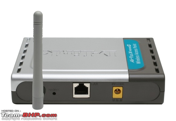

To clear up a little confusion- here's a 5 min schematic done in MSPaint.
This is what I'm using for Wi-Fi
doomsday is offline
Old 28th May 2009, 01:25   #224
dreamdiesel's Avatar
Join Date: Aug 2008
Posts: 420
Thanked: 63 Times
doomsday. The problem here is the IP address range of the Beetel 220BX (192.168.1.1 to 192.168.1.254) and the DLink DWL-2100AP (Fixed IP of 192.168.0.50).
In order to access the configuration page of the DLink DWL-2100AP you need to make sure the computer is assigned an IP in the same range as the DLink.
1. Change any one of the computers IP to 192.168.0.10 (manually assigned IP).
2. Now you should be able to open the DLink configuration page using 192.168.0.50.
3. Admin as username and password as blank.
4. Make necessary chages to secure the wireless network on the DLink configuration page and save settings.
5. Once the network shows up as secure revert the IP back to the 192.168.1... range.
Hope this helps!!!
