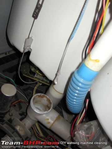

DIY - unclogging a leaking drain valve on washing machine
@vina; If you are in a hard water area then cleaning out the deposits might just work. Take the valve out and then pour some material like Blue Harpic, or Modi Spic and Span into it from both sides.
Well SG sir's encouragement, both now and in the past made me do it.
Opened the back of the machine again, and after fooling around with the valve assembly (3rd picture onwards) figured out that the four sticking poity things can actually be grabbed, and the whole assembly made to rotate - it opens up !
Before you do that however disengage the small ribbon connecting the valve to the wash/drain knob (see the 3rd and 4th pictures).
Valve came out, and also came out lots of lint with it - there was no way it was going away with harpic, though the calcium and other junk deposits might have washed away. The black-rubber bellows like valve was almost white with deposits.
Even my nails could not help much with the deposits, but an old toothbrush worked wonders (I could see how the toothbrushes clean teeth - this one took out mud and calcium deposits from soft rubber).
Cleaned up the drain pipes too, and then put everything back.
Voila, leakage is gone !
EDIT: LG had quoted Rs. 200 as service charges plus taxes and any materials used, and said they would take 24hrs. The LG guy I knew has not been picking phone since this afternoon.
I guess I can spend the money for a Father's day gift (he gave some pretty good clues on phone too)
