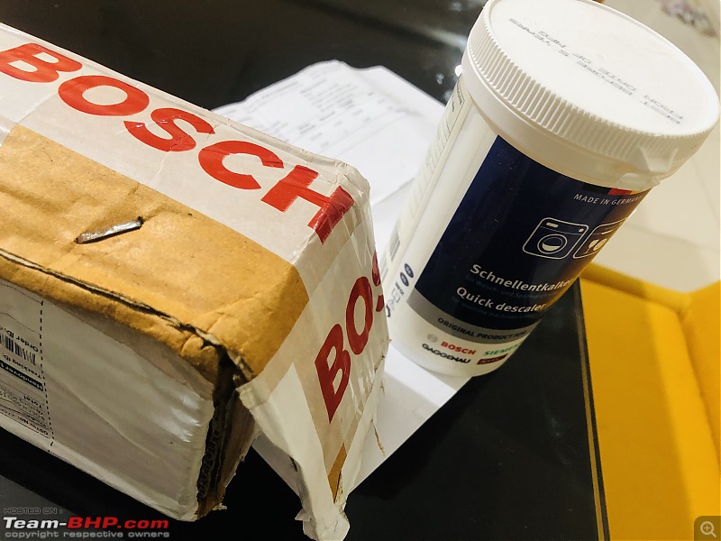

Washing machines need descaling once in 6 months, since its mostly tanker water in Bangalore. Ordered one from Bosch (Germany) on Flipkart. This one costs Rs. 600, but there are some from Whirpool at Rs. 150 as well.

Buy some citric acid powder from Amazon. Add a cupful to the washing machine and run the hottest cycle. It will do the same at much cheaper price.

Can you guide me on the proper method of descaling? I had bought 3 packets of descaling powder off Amzaon some months back but not sure how exactly to do it. A search on 'how to descale' on Google gives so many contrasting methods, I just got confused and left it at that.

It's nothing. Just add this instead of washing powder. Select wash with the temperature set at 60 Degrees. Skip the rinse stage at end as there are no clothes to dry. Removes mold, unpleasant odours and scale. You can feel the positive effect after using the best powders. Then, for drum rubber beading, I use vinegar

Thanks for the info.
Is descaling needed for those who are not having hard water?
