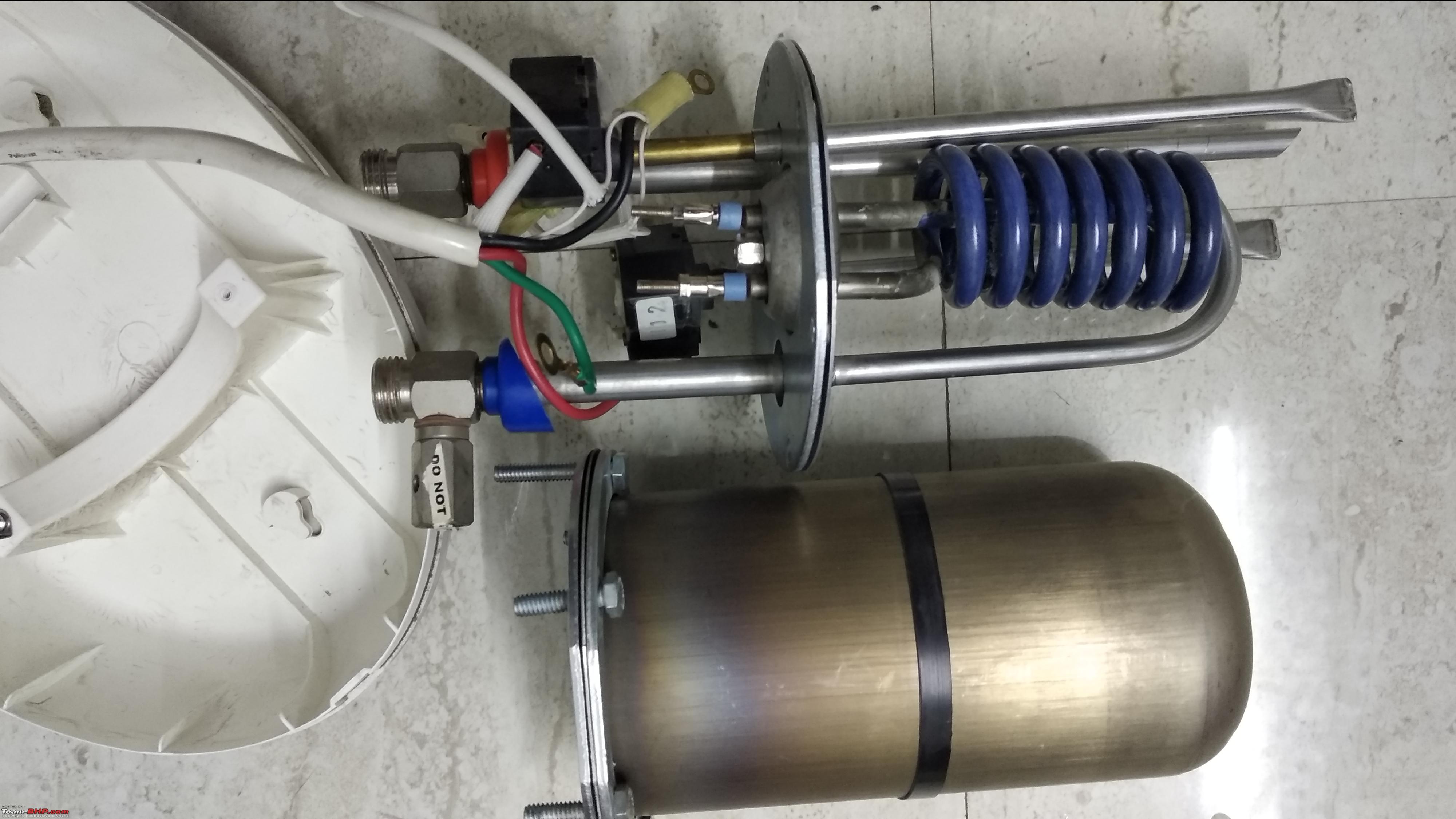

Scaling would be the prime suspect. We have had to periodically replace the heating rod/coil in our geyser unit. Don't recollect the exact cost of the replacement coils, but our electrician used to get it from neighborhood shops for 1000/- or so.
Originally Posted by diyguy View Post
I had changed the heating element in an older bajaj heater myself. Purchased it from a local electric store for under 400rs about two years back.
Thank you Miyata and diyguy for the advice. I will have a look at the Heating Coil. Just a doubt regarding the Heating Coil; is the size same as per the rating of the Coil? And will a 3kw Bajaj coil fit in a 3kw Racold heater - as in does the design of the coil change as per the manufacturer?
adi.mariner is online now
Old 28th August 2019, 10:40   #7308
diyguy's Avatar
Posts: 521
Thanked: 588 Times
Yes the coil/element is model specific I believe. The one I changed was curved like a banana, see pic.

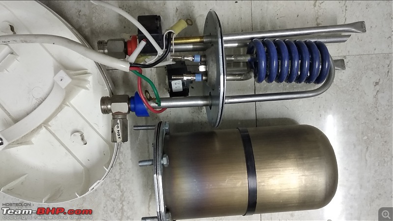

I had opened up our Geyser. The coil was coated with a layer of lime scales. Just gently wiped it and all of them came off. There seems to be some ceramic coating on the coil. Also increased the temperature setting to 60 degrees from the factory set 55 degrees. Geyser is working better now. Attaching a picture of the coil and internals.
I see that you cleaned the coil up and and it's working good. However, for a future reference, just in case the need arises:
Almost always the coils will be brand/model specific. An improper fit will lead to leaks. What our electrician would do was to carry along the damaged one to the nearby store and get a matching one from the store - compared and contrasted!
If you keep cleaning periodically though, you will be able to stretch its working life well. Soft scrubbing with some vinegar or/and mild soap should work alright.
Also, for the instant heating units, depending on the volume of water usage, you may not really need to rise the heating temperature. If your consumption isn't much, you'll only end up increasing your electricity bill with no other benefit to go with it!

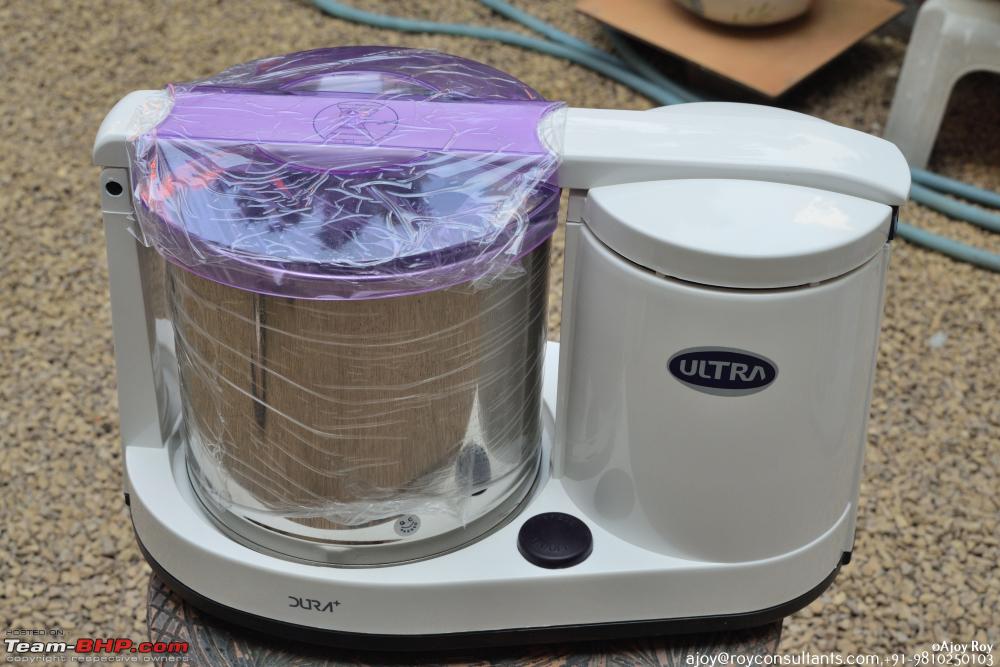

I have Elgi wet grinder. It is excellent for all sorts of wet grinding - Dosa, Chutneys etc. There are some limitations
. There is a minimum volume required
. It cannot grind dry masalas
. Chutneys and coconut have to be rough ground or cut fine, before using wet grinder. On the upside the fine chutney paste that comes out is practically impossible to get in a normal mixer/grinder.
