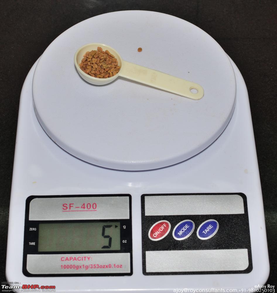

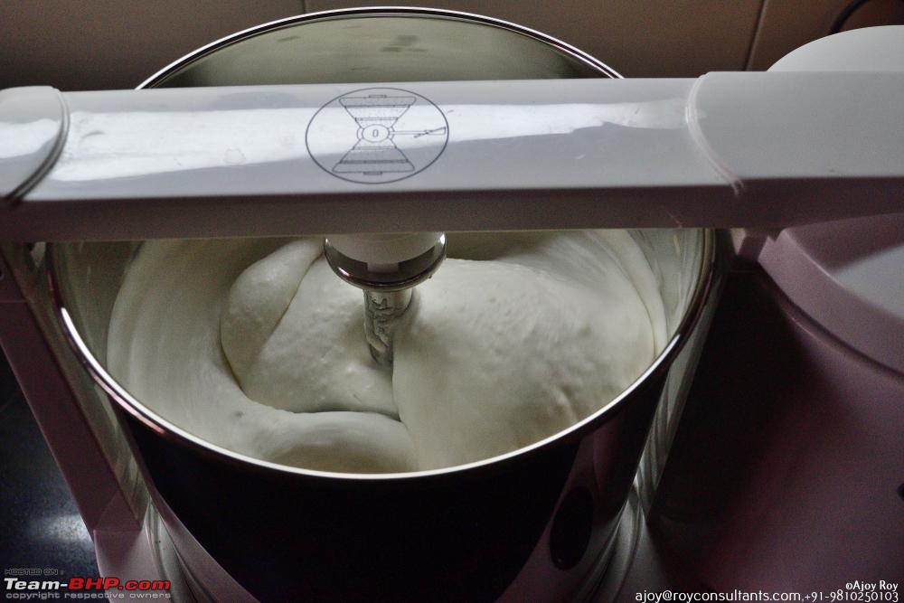

I bought the Elgi 1.25 after reviewing the other brands. The conical stones are way ahead of the cylindrical ones used in older design.
These grinders can grind as little as 250ml. For Idly Dosa, my usual mix is
250g rice
250g rice, total 500g
125g dal
5g Methi
First grind Methi. Even that small amount grinds perfectly
Then the Dal. The 125g dal will swell up to nearly 8 times
Lastly the rice, and then mix it up.
Please note that the dal and rice are ground separately and require about 20 to 30 minutes to grind really fine.

Thanks for the detailed review. One suggestion, instead of using the split Urad dal, you can try using the whole Urad dal. It gives a smoother texture and yields better results.
How much quantity of rice does it grind at a time? I gather it is about 1 lit including the water?
hrman is offline
