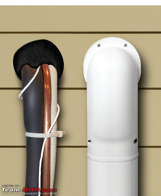

AC refrigerant lines cover
I was wondering if any of you had your refrigerant lines covered for aesthetic reasons, and how you did it. The one on the left is how mine looks and I'd like to get the cover on the right for the lines. Since none of the Indian AC installers seem to know about the cover, is there any jugaad solution? Thanks in advance for your inputs
