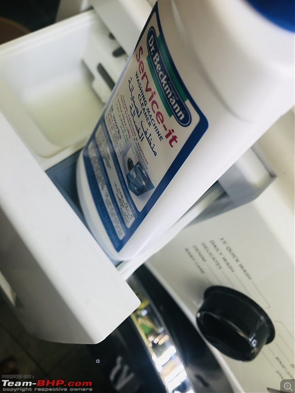

I dont know if you get it in India (the original), but there is a Dr. Beckmann washing machine cleaner - 'service-it' liquid from Germany. I've been using this for a decade and this really prolongs the life of a machine. I just got one from the UAE and used it on Mom's 5 year old machine (in Bangalore) for sparkling results. She is really happy with the result
