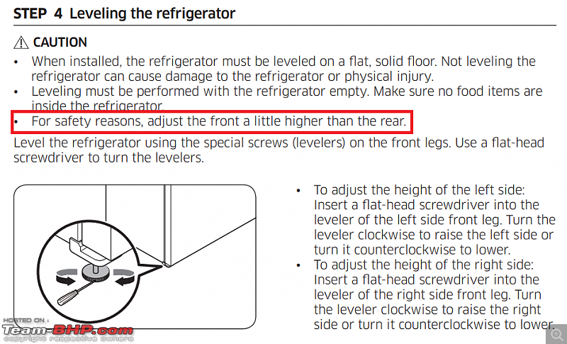

Especially for folks with OCD, I know it will drive them crazy.
How do you think I noticed?
Can you check the front-bottom if the threaded mounts can be turned to adjust the height? This can perhaps solve the weird tilt.
Yes, it can be adjusted (see below). The unit was wobbling a bit initially and the doors were a a bit misaligned. It was after the guy adjusted the leg to make it steady, the tilt became more prominent.
Not for safety but for folks who're careless enough to leave the door open. So the installation guys does this type of tile for regardless even if we're detailed to attention people.
Tilt a little backward & the door closes with ease, otherwise, the door closes till the edge, just enough to switch off the light inside, but still remains open for few mm. This happens over the years, not immediately though.
Your explanation makes perfect sense and sounds a much better one than the security one that is mentioned in the manual (yes, that's where I had read that) - unless they are talking about the refrigerator toppling on you during an earthquake.
A slight tilt is indeed for for closing, but it shouldn't be visible tilted. Just enough.
Every time I look at it I am tempted to grab a screw driver and give a go at it. But I hold myself back scared that I might screw it up. Maybe I will eventually learn to live with it or gather enough courage to tinker with it.

It's not like a washing machine: you don't need a spirit level. Just make it look right, and be sure the door falls shut, not open. You could check a bowl of liquid on a shelf inside to make sure it looks reasonably level. You can't screw up.
(well, you can screw up, but don't worry: you can screw down as well )
