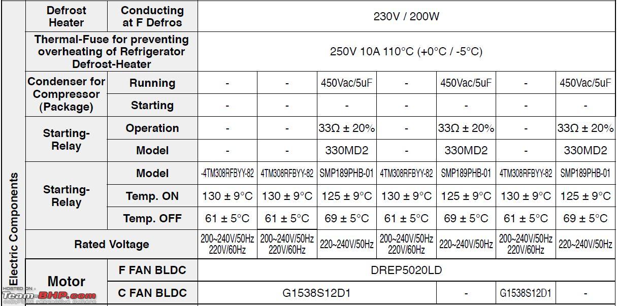

Originally Posted by Prowler View Post
The heater coil is used for defrosting. Many refrigerators don't come with heater coils as they call it as frost free.
You couldn't be more wrong sir. Every frost free refrigerator has a heating element. You can read about it over here - https://homeguides.sfgate.com/frostf...nts-76586.html
The difference between older models with manual defrosting and the models called frost-free which is actually a misnomer and is actually auto defrosting is a simple device known as a mechanical timer which would switch on the heater for a fixed time period after a fixed number of hours instead of manual switching in older models where we used to press the red button to switch on the heater cycle. This seems to have been replaced with some sensors on the latest refrigerators which do the same job but based on actual frosting of the coils rather than on fixed time intervals.
If you open up the back of your frost free refrigerator you will see another set of coils and a fan. When the water is melted by the heater and drops inside the small collector at the back, it drops very close to the condenser coils at the back and this action with the help of the condenser fan evaporates what little water has been melted by the action of the heater because condenser coils are very hot. I have opened up my refrigerator and seen all this first hand.
You are correct that failure of the evaporator fan can also lead to forming of ice on the fins of the evaporator coils but that is not the sole reason and can very easily be verified by checking whether the fan is working or not. In fact I recently did replace my evaporator fan but the real culprit in my system is that the heater is not switching on despite the timer being perfect.
Yes. The fridge has a 200W defrost heating element. Below is from the service manual.
