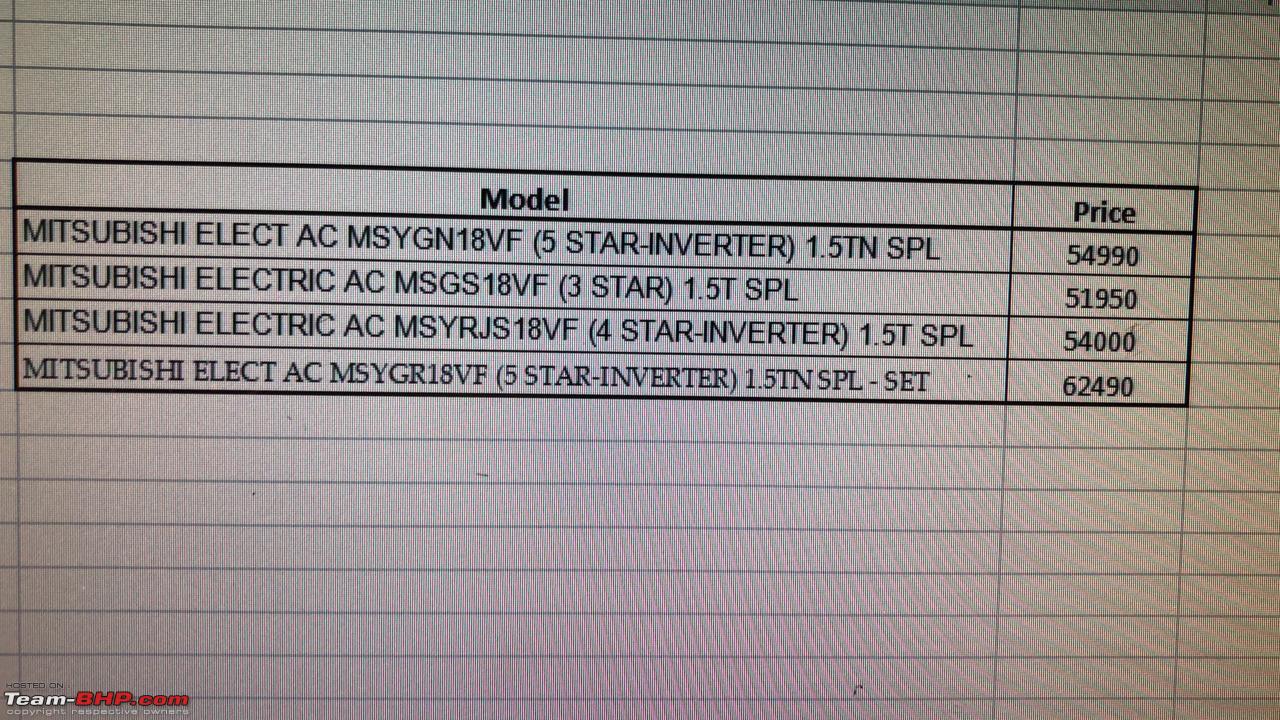

Team,
With the lockdown over and Vijay Sales re-opening, these are the Mitsubishi models they have available. Which one to pick? Thank you!
The home / office air-conditioner thread-27c3b6f1b6134770b51d12cc9378615e.jpg

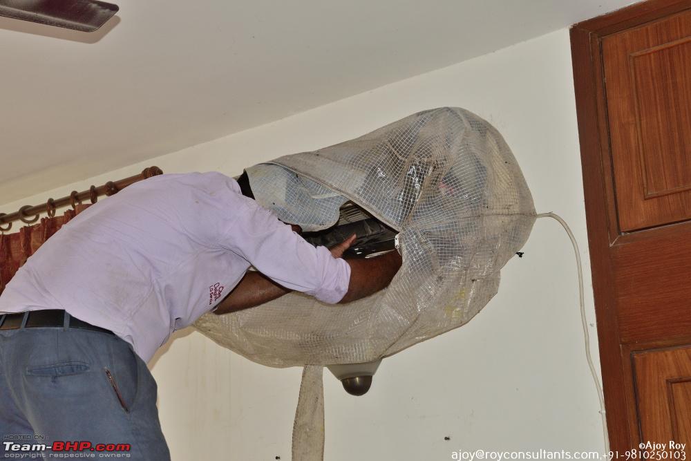

For those who are wondering about dirt accumulation in an IDU of an Inverter AC, here is the proof. I got my LG 5* Inverter serviced yesterday. The images speak for themselves.
The home / office air-conditioner thread-rsc_4805.jpg
Fixing the "Hood"
The home / office air-conditioner thread-rsc_4809.jpg
Pressure spray
The home / office air-conditioner thread-rsc_4812.jpg
First round of water. Notice how dark it is
The home / office air-conditioner thread-rsc_4813.jpg
Second round of cleaning
The home / office air-conditioner thread-rsc_4820.jpg
Water slightly less dark. The third round had clean water.
The home / office air-conditioner thread-rsc_4827.jpg
Cleaning the ODU. The water dripping was also quite dirty, thanks to Delhi's dust.
Aroy is offline   (4) Thanks
