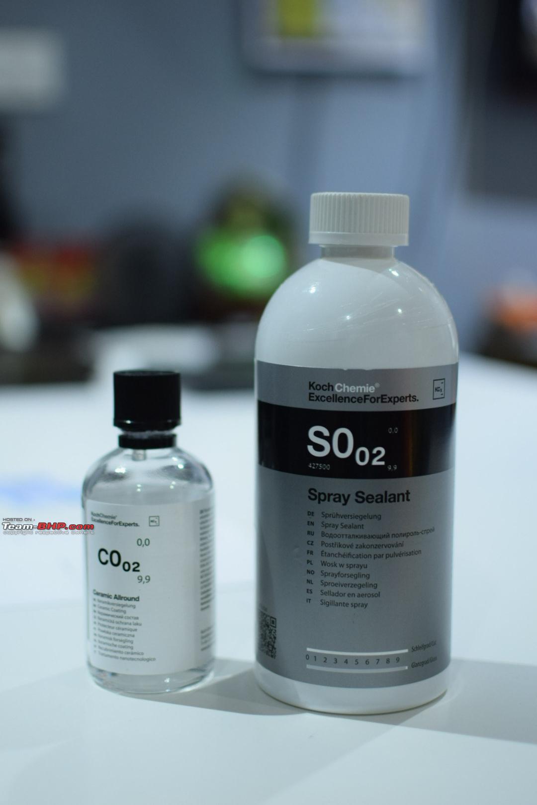

Ceramic coating for my Volkswagen Virtus GT Plus
I had a great experience with Koch-Chemie C0.02 Ceramic Coating at the Washing Culture detailer in Andheri West, Mumbai, for my Volkswagen Virtus. I had checked out five detailers within a 10-kilometre radius of my home and compared their a. rating/feedback on Google, b. quote, c. materials used for coating, and d. warranty. Most of the detailers use unbranded silicon-based products, claiming that foreign ceramic coating solutions do not work in an Indian climate! In India, many detailers import SiO2 solutions from China/SE Asia in generic containers and experiment with the correct concentration and number of layers. Furthermore, there is absolutely no standard rulebook as to how many coats are actually required to get lasting protection; this is often determined by the negotiated price and, boy-o-boy, how informed the customer is! Of the two detailers who use branded products, I decided to entrust my car to the Washing Culture guys for the German-branded Koch-chemie solutions. The coating came with a 5-year warranty.
On the day of the appointment when I arrived at the Washing Culture’s Andheri West workshop, I was impressed by the facility's interiors (and not by the exterior), their customer-connect, and the attention to detail they put into every aspect of their work. The staff was knowledgeable and friendly, and they took the time to explain the entire process to me before beginning. On the previous day of my schedule, they had confirmed my booking and ordered the Koch-chemie products, Ceramic Allround C0.02 and Spray Sealant S0.02. For the pre-ceramic steps, they used Malco’s Epic Wash. Allround C0.02 is a cyclosilazane, silaxane, and silicone-based ceramic coating solution. I had requested that Sooraj, the proprietor, and Kalpesh, the chief technical person, inform me before opening the C0.02 solution bottle, and they readily agreed.
I was there throughout the 3-hour-long C0.02 application process and was impressed with the meticulousness with which their team approached their job. They used professional-grade applicator pads that came with the Koch-chemie solutions package to ensure an even and smooth application. Once the ceramic coating was applied to all the surfaces, they allowed it to cure overnight. This curing process is essential for the coating to bond effectively with the paint and create a durable shield against the elements.
The next day, I could not be physically there at the workshop, but Kalpesh took video snippets of the S0.02 spray sealant (top coat) application process and sent me those in real-time. When I arrived for the delivery 6 hours after the top-coat application, I felt my car's finish looked deep and glossy, with a level of shine that was as per my expectations. They also demonstrated the hydrophobic properties of the coating by spraying water on the car.
As recommended, I did not wash the car for the next 8 days for the coats to settle well, but I used the car for my routine trips to the office (70 km/day). On day 9, when I water-washed the car, I felt the water roll-off was a bit deficient on the central part of the bonnet. I contacted Washing Culture, and they readily agreed to inspect the car. After inspection, Kalpesh felt likewise and decided to reapply the coats on the bonnet as the rest of the car’s coating was perfect. The recoating and curing under IR were done over the next 1.5 days. Possible reason (and this might benefit my fellow members here): The Virtus and the Slavia do not have insulation under the hood, and hence the bonnet heats up significantly during and after long drives. If one drives the car for a long period immediately after a ceramic coat (settling time is generally 7 to 9 days), there are chances that the top coat might wear off in patches. Please be aware of this.

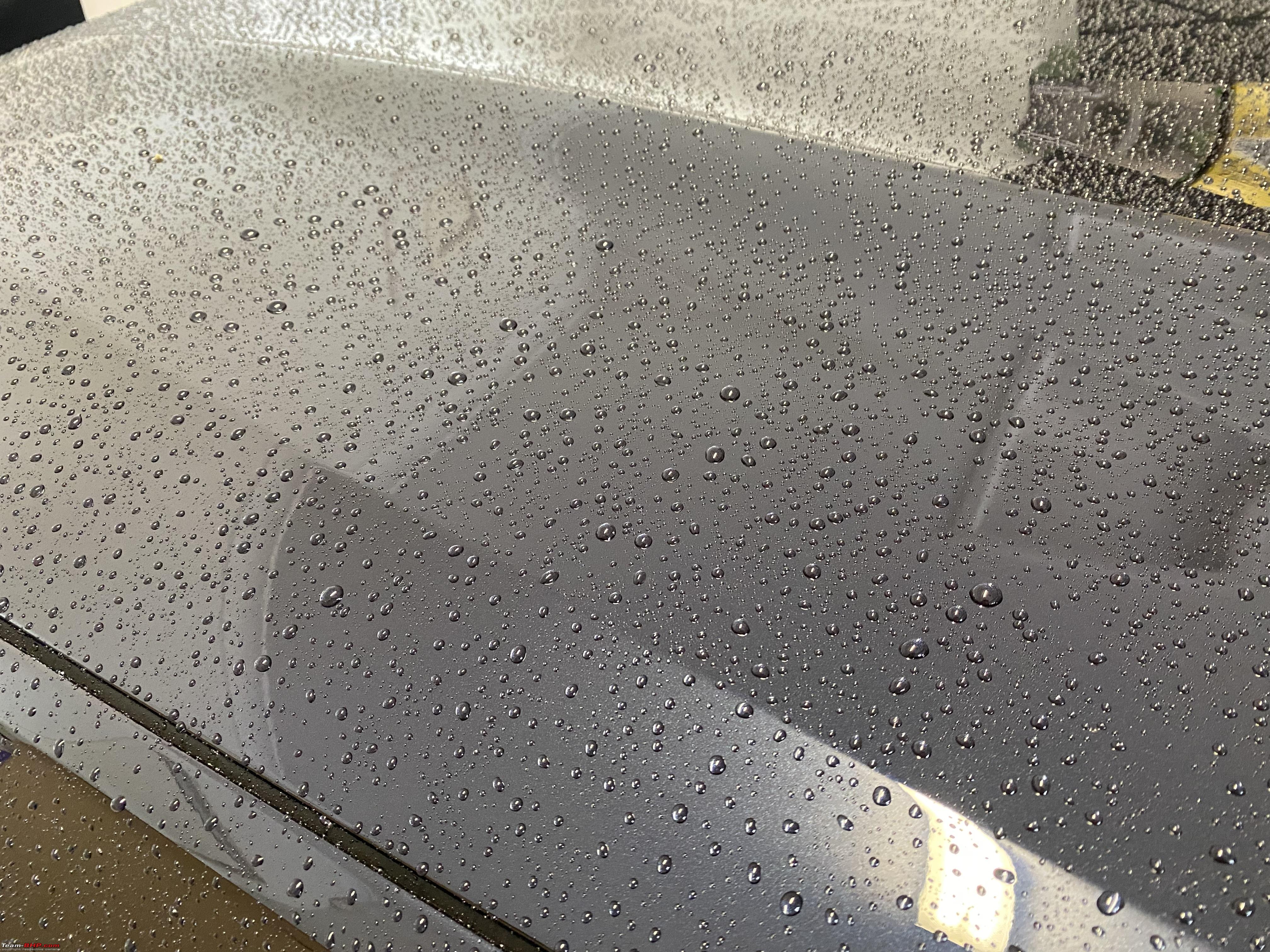

Water beading effect on my car after a drive in the rains this morning. Coating was applied in mid June.

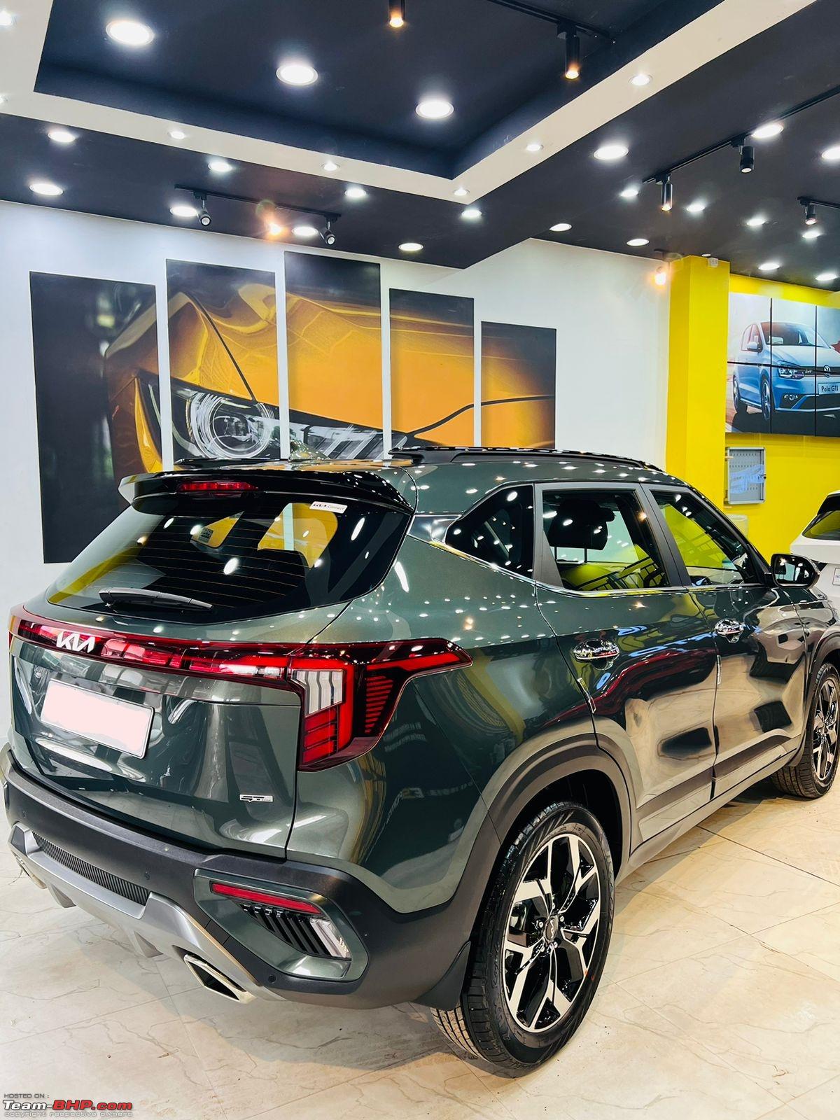

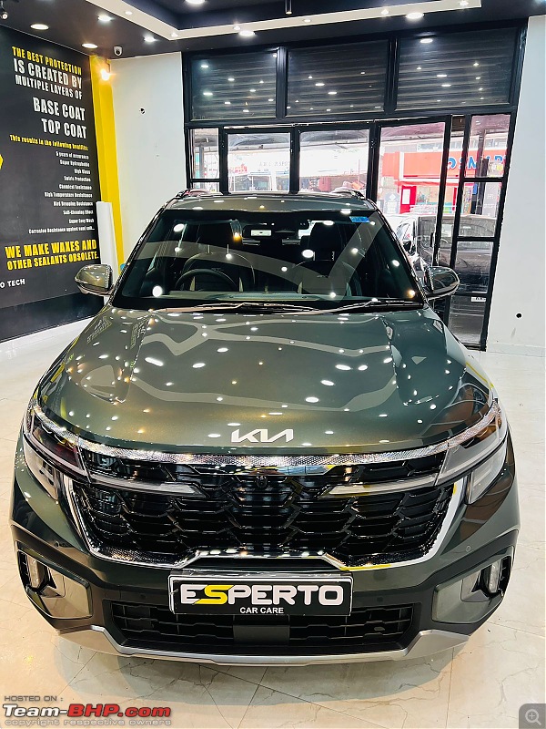

I recently had my new Seltos 2023 GTX+ 7DCT car treated with ceramic coating at ESPERTO Bilekahalli facility, and I am thoroughly impressed with the service provided.
Ojas is very helpful, understands your requirement and provides clarity on how the process is done as well explains what comes with the package that you can opt for. The team does have a good level of professionalism and expertise. They use Drexler graphene coating, multiple layers applied along with the layer of top coat ensuring my car received the best possible treatment.
The application process was meticulous, and the attention to detail was commendable. The package I opted for also included applying glass coating and treating some portions of the interior plastic and seats, enhancing the overall look and feel of my car. Also PPF was used for Side view mirrors and door handle inside area, door edges prone for scratches.
Customer Service is very good, car was parked inside and taken care of. I personally dropped my car to the place and the work was completed earlier than the time i was promised for.
Post service Esperto would provide 3 maintenance coat on 18 month cycle for the platinum package I have opted for.
5 Years warranty for minor scratches , paint fade and hydrophobic effect.
Along with this the team at Esperto is very open for getting top coats once in every 6 months with nominal car wash charges..
Long-Term Effect (Awaiting)
While it's too early to comment on the long-term effects of the ceramic coating, I am optimistic about its durability and protective properties. As the months and years pass, I am looking forward to seeing how well the coating holds up against the elements and preserves the showroom shine of my car.
Overall Experience: ⭐⭐⭐⭐⭐
In conclusion, I am very satisfied with my experience at this facility. The professionalism, attention to detail, and use of high-quality products have left positive impression. I would recommend this service to anyone looking to protect their vehicle and enhance its aesthetic appeal.
I will update my review in the future to provide a comprehensive perspective on the coating's effectiveness.
