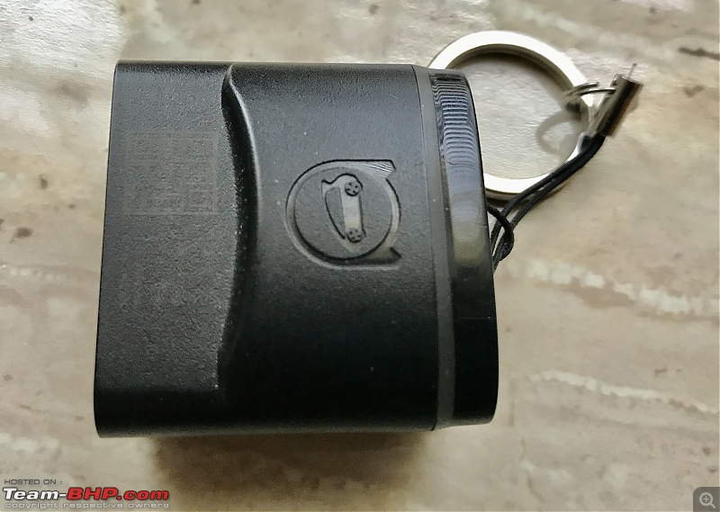

There's another workaround for the VAG cars
This can be done with the OBDeleven. There are a range of features that can be activated and dectivated.
You dont even need the most expensive Pro Version.
https://www.ubuy.co.in/brand/obdeleven
