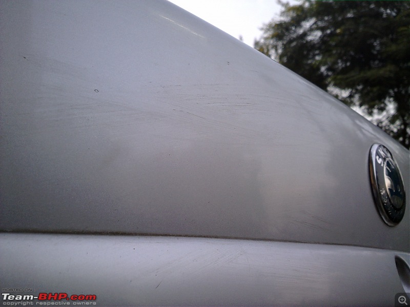

Here are the pictures of my Skoda, with the wax stains:
Huge Fake Car Polish/Wax market in India-03112009029.jpg
Huge Fake Car Polish/Wax market in India-03112009028.jpg

You probably got the best batch of the lot.

I am not joking when I say that you got the best batch of the lot and the Carnuba content must be a lot more. It is this carnuba that you see as a white crust.
Bonding to the paint is its forte. The amount you applied is way, way too much. In my earlier days by which I mean 30 years ago I too faced this issue. All you have to do is apply a thin coat once again to make it oily and wipe of immediately without waiting for the wax to dry and this time wax only 6 square inches at a time. If it still does not come off use the costlier fluid waxes from the same company to polish away hardened Carnuba. As mentioned before; you have to have real strong arms to polish the car in one day. I do by sections today and some times finishing just the bonnet gives me stomach cramps let alone dead tired arms. Also it is better to err on applying less wax than more wax. Do not be worried you are the learning curve. Do not use any abrasive or liquid house hold kitchen detergents to clean off. If you are flumoxed use pure Kerosene and never ever use diesel or turpentine to wash away the wax but thats the easy way out.
This seems to be the safest solution.

Thanks Doc,
This method works like a charm, I tried it on the boot of the car.
Will post pics once the entire car is buffed.

This method,
I re-applied the wax and buffed it immediately.
The result was good, all of the older harder wax came of easily.
