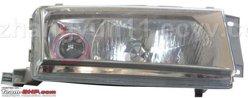

Default Question about Skoda Octavia A4 headlight.
Hi,
Could some one please tell me what is behnid the projector of Skoda Octavia A4 headlight?
Auto Lighting thread : Post all queries about automobile lighting here-skoda-headlight_trimmed-snap.jpg
Thanks in advance!

Originally Posted by shyamhegde View Post
Hi,
Attachment 43336
Thanks in advance!

Hi, Thanks! here is the pic of projectors in side the headlight assembly of Octavia (refer to my previous post above pls)
Name:  Skoda Octavia projector.jpg
It is a H3 projector. I just wanted to know what bulbs does sit there? I mean a H3 halogen or (43K) H3 HID ?
I suppose it is a HID but wanted to confirm.
Thanks!
Shyam
