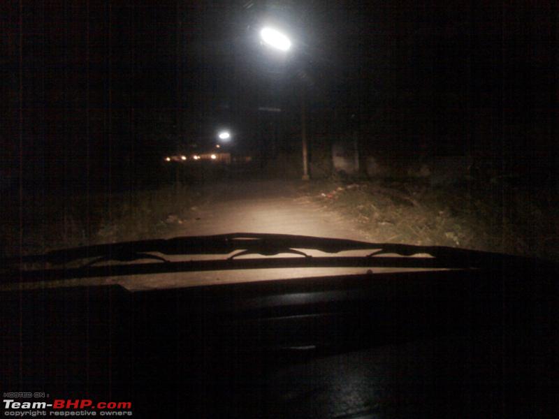

This is how road looks to me at night These are 100/90 Halonix with relay.

Originally Posted by Hashim View Post
Attachment 61462
My personal experience with Halonix +60 100/90W bulbs has not been good. I also feel your HL requires aim settings. And read ultimatechamp's post #2210. What is the condition of your HL Assembly/reflectors? You might want to replace those.

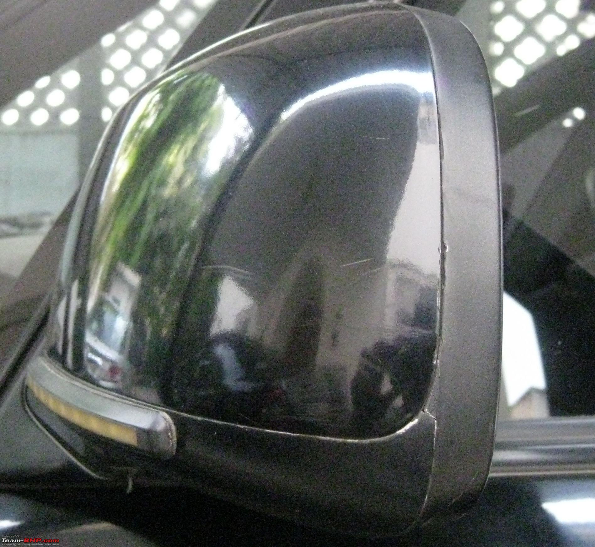

LED Mirror Lights are down below:
Auto Lighting thread : Post all queries about automobile lighting here-img_0896.jpg
Dont have one taken in the day will post it in a little while.

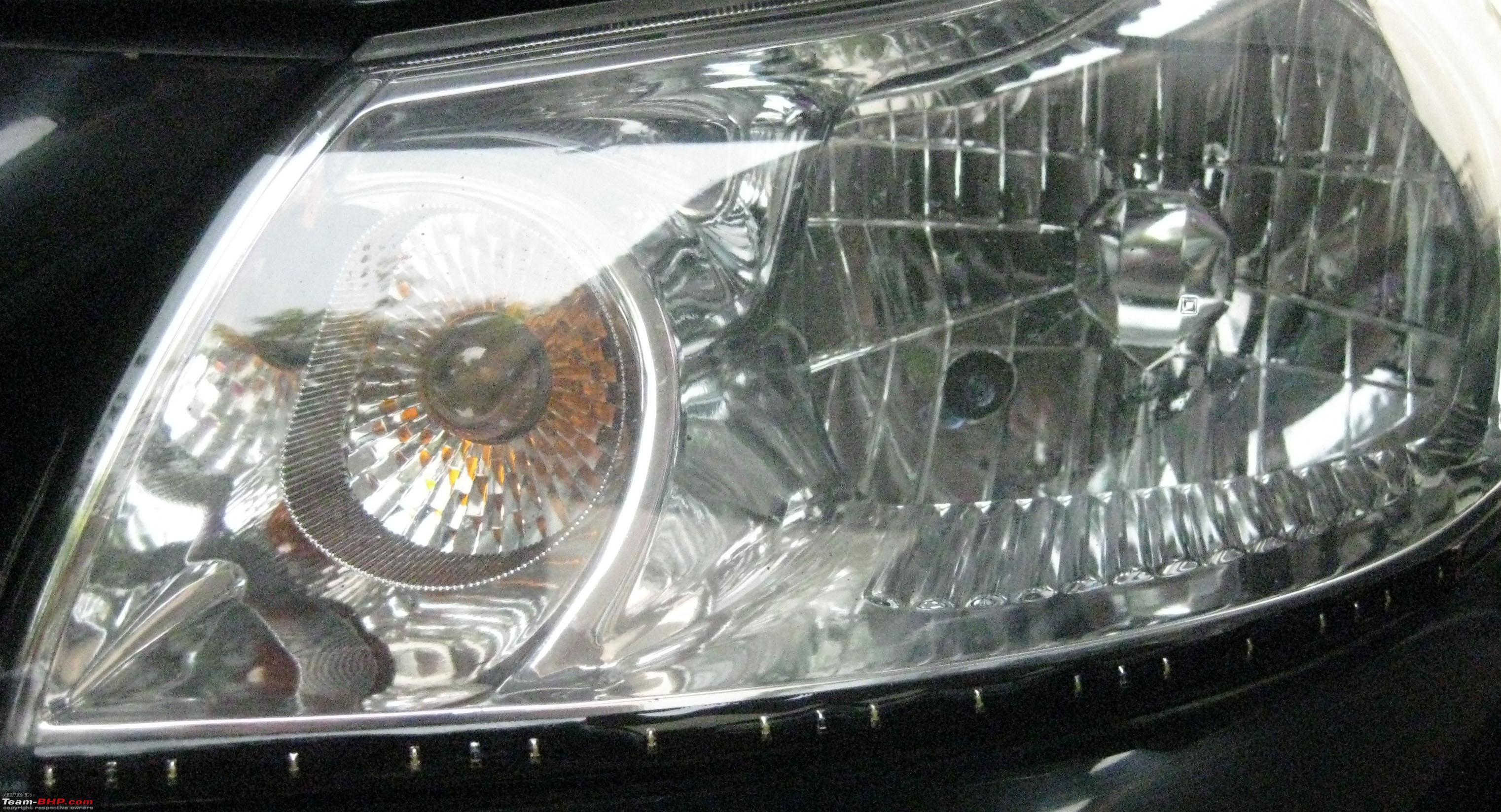

I also have an LED strip on the headlights, but taking a pic from the front resulted in alot of glare, trying to figure that one out. This is what I have as of now. (This is the LED strip with parking lights on)
Auto Lighting thread : Post all queries about automobile lighting here-img_0955edit.jpg
I just figured out from yellow light from my bulbs that they are not getting enough voltage. Just now what I did is connected a multimeter to car battery terminal and started the car and kept RPM little higher than idle. Voltage increased to 13.2v from 12.5v, now as soon as I switched on headlight, battery voltage started dropping and reached 11.6v Battery is not even a year old and quite well charged as I drive car daily.
Switching to lower wattage bulb like 55w something will solve this problem or there is something wrong with the car electrical ?
Voltage will drop if the circuit isn't getting the current it needs for the load connected to it. You need to put your lamps on a different circuit (read : relay) and use some fat cables to do so. Do remember that the highest current capacity of a circuit is the capacity of the lowest capacity cable in the circuit. So make sure there are no bottlenecks in your electric system.
12.5V is fine for the battery. I suspect your cabling.

Originally Posted by anantnehru View Post
Sure, but which ones? The mirror lights or the headlight LEDs?
The mirror LEDs look cool Anant and the headlight ones too.I guess like greenhorn,we all want to see both in daytime shots to check out how they are actually.The low beam headlight picture needs to be better though.

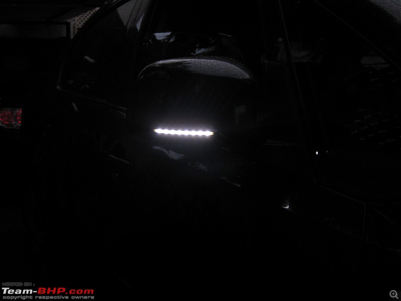

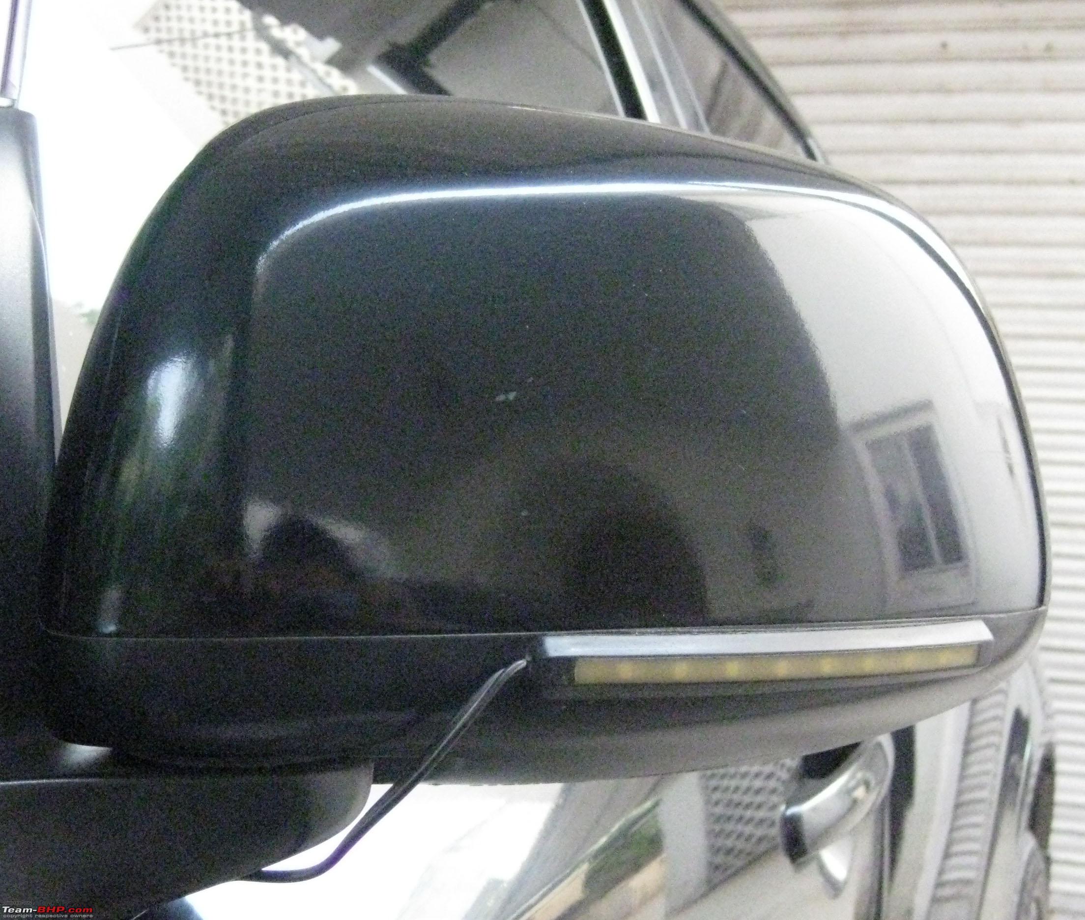

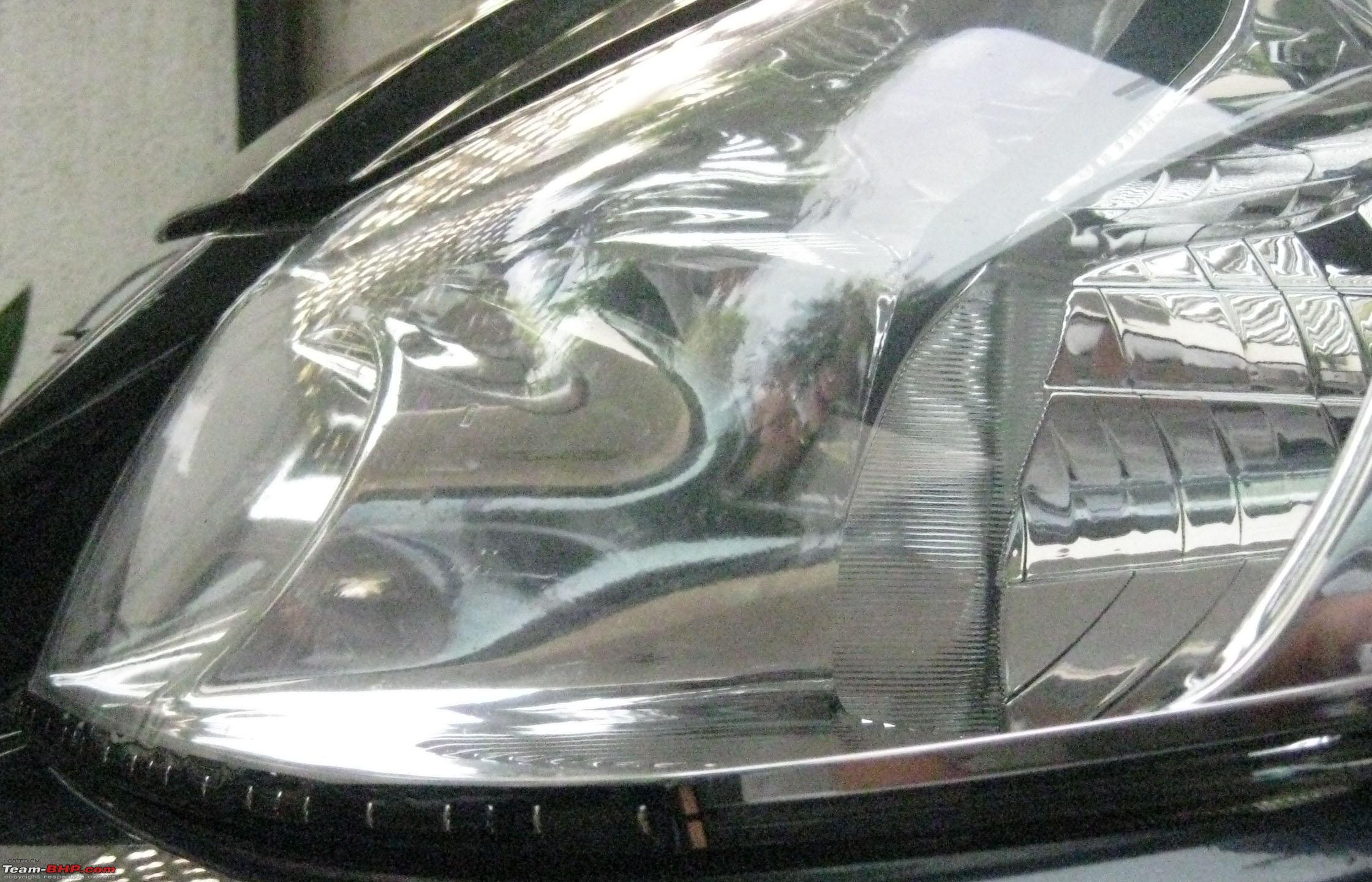

All right guys.
Here you go, head on shots as well from the side.
Let me know what say you.
Auto Lighting thread : Post all queries about automobile lighting here-img_0988edit.jpg
Auto Lighting thread : Post all queries about automobile lighting here-img_0989edit.jpg
Auto Lighting thread : Post all queries about automobile lighting here-img_0990edit.jpg
Auto Lighting thread : Post all queries about automobile lighting here-img_0991edit.jpg
The wiring for the mirrors can be done alot more neatly, but I didnt have patience the day I had it installed so have to go back and get it rectified. But you cant really see them at night.
