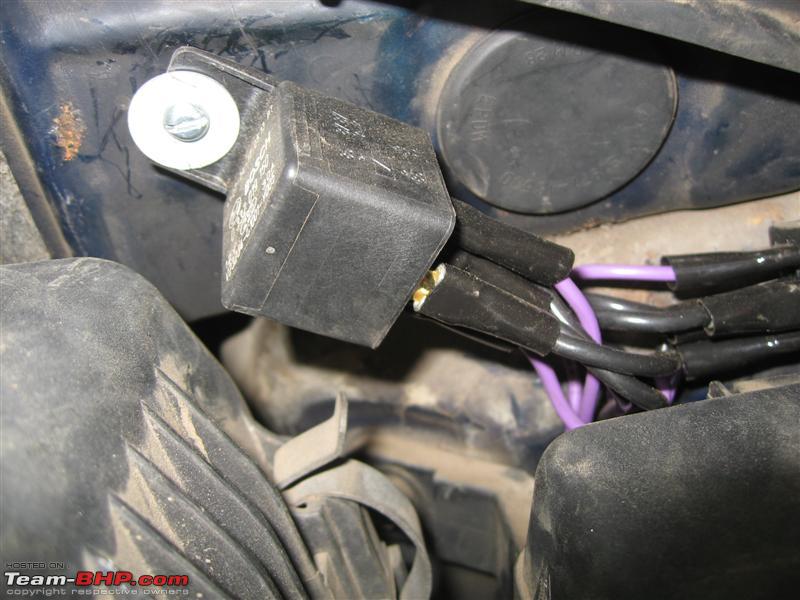

Just got Philips Rally 100/90, Bosch mini relays (x2) [impressive looking - I must add!] and Roots ceramic holders (x2) installed in my Getz today.
Initial impression is quite positive. Could not get to do a long drive, but what I could see was good throw/coverage and the illumination is also quite nice.
I had no idea which bulb to go for (i.e. blue/white/yellow/4x00k whatever), so went with what my mechanic suggested.
OT - Why does everyone call it Rallye when its actually just Rally?
Good call Nishant. Do post a picture of the Bosch mini relay, would like to see.

Thanks for the confirmation Ankit. After reading through so many pages in this thread, I was actually confused what bulbs to go for!
Will click somepics today and post at night.
Here are the pics of the Bosch mini relays and back of the ceramic holders. Could not click pics of the actual install as I had left the car with my mechanic.
