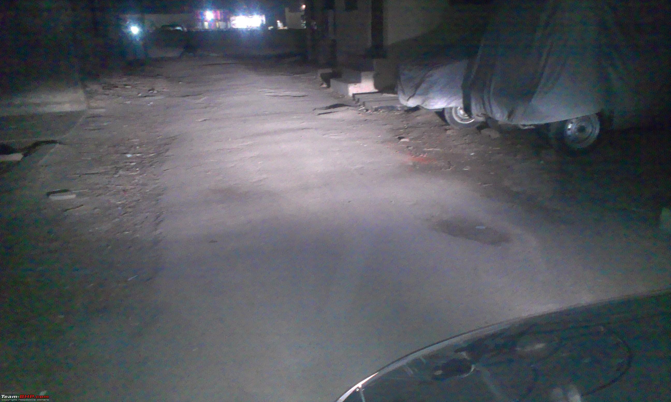

Here's the pic of 4300k 90/100 halonix bulbs on my Accent. And i got them for 100/- per bulb. Sorry for the wrong price, I told you previously.
Low Beam :
Auto Lighting thread : Post all queries about automobile lighting here-imag0006.jpg
High Beam :
Auto Lighting thread : Post all queries about automobile lighting here-imag0008.jpg
Need to get right headlamp adjusted a bit.

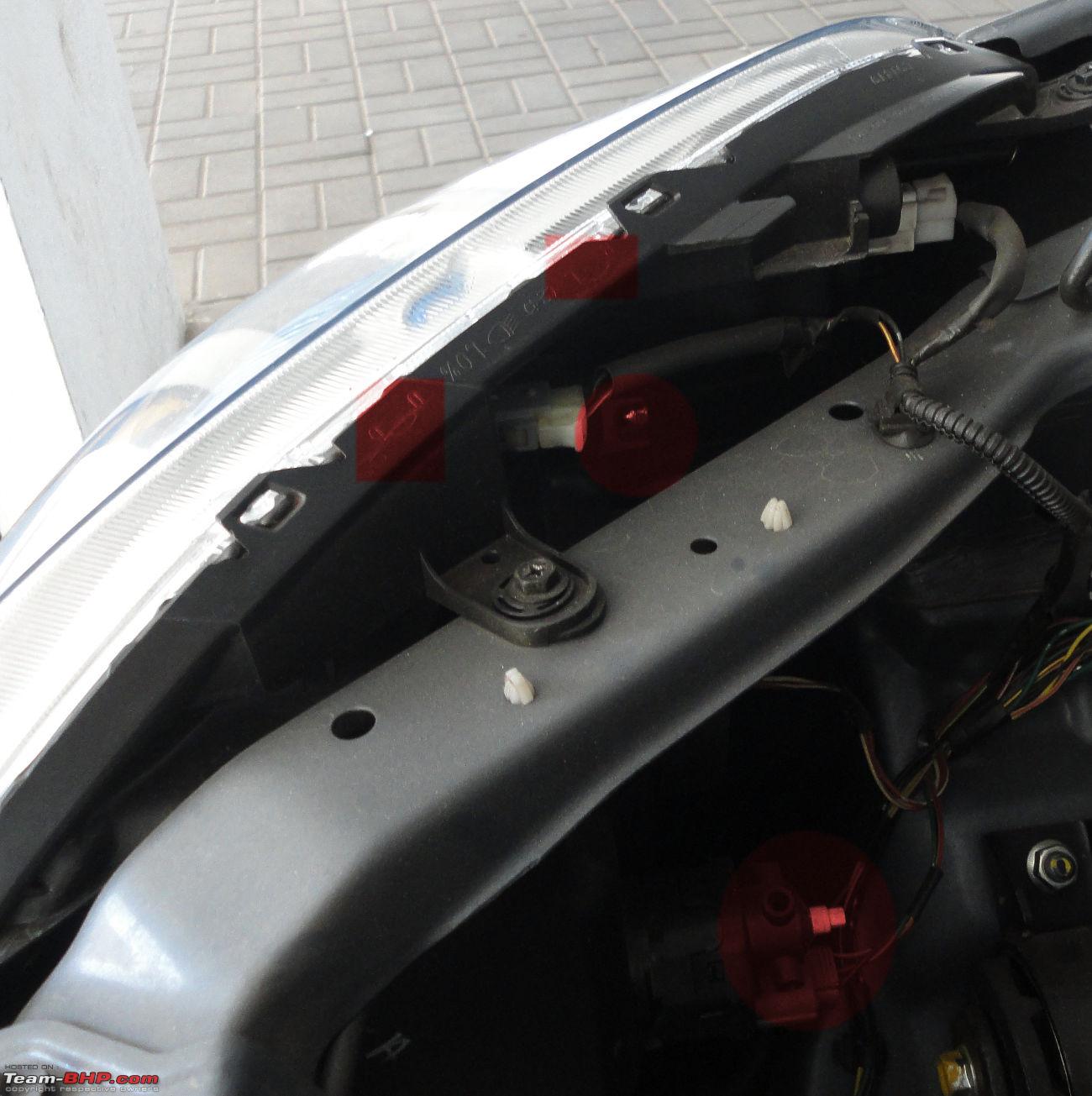

Here is a guide:
1. First, visually inspect both the headlamp assembly to ensure they have been mounted right. Sometimes when you have changed the assembly, the mechanic may have improperly mounted it, causing bad alignment of the lamp. Even a small mistake can put the alignment off badly.
2. If you are satisified with the mounting, then move the leveller switch to a mid position, like 2 or 1. This is optional. I do it because my default position is that. I can move it up or down if required. If you focus the lamp at 0 position, you can only move it down.
3. Peep behind the headlamp assembly. You will find these reference markings:
Auto Lighting thread : Post all queries about automobile lighting here-dsc07489.jpg
Auto Lighting thread : Post all queries about automobile lighting here-dsc07491.jpg
Auto Lighting thread : Post all queries about automobile lighting here-dsc07513.jpg

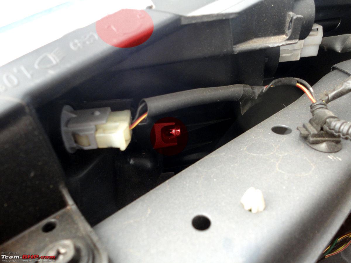

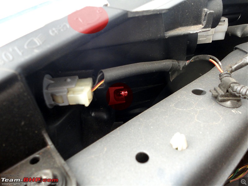

Given above are what is found in my cars. These indicate the position of the adjustment screws and the direction they need to turned to move up down, left and right.
4. Look behind where the two LR and UD markings are located, and you will find the respective adjustment holes
Auto Lighting thread : Post all queries about automobile lighting here-dsc07494.jpg
Auto Lighting thread : Post all queries about automobile lighting here-dsc07505.jpg
See the location of the marking and the location of the screw. Now, here is a close up of the Up/Down adjustment hole:

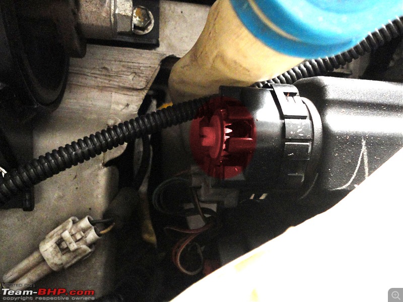

We can see a gear cog inside the hole. Insert a long star screw driver into this hole. As per the notation, turn it to acheive the desired result.
Here is the left right adjustment screw on the WagonR:
Auto Lighting thread : Post all queries about automobile lighting here-dsc07503.jpg
As we move closer,
Auto Lighting thread : Post all queries about automobile lighting here-dsc07509.jpg
Insert the screwdriver, and repeat the same procedure.

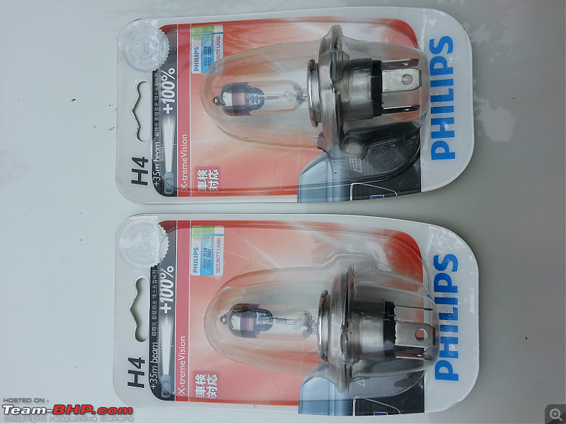

Just bought 2 pairs of Philips Xtreme vision H4 60/55 bulbs from AK traders, JC road, Bangalore. Cost was Rs. 900 per pair inclusive of taxes. MRP printed is Rs. 600 per bulb. Did try bargaining for a discount, but the shop owner did not budge, and he went on to say that even if we take 200 bulbs, the selling price will remain the same!
Attachment 1036875
Attachment 1036876
Attachment 1036877
The bulbs are january 2012 manufactured, hope that would not be an issue.
I purchased 2 bulbs for 900 bucks today from AK traders. But got one bulb of July2011 and another of Jan2012. :( . Did not check with a keen eye at the shop.
