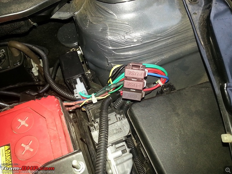

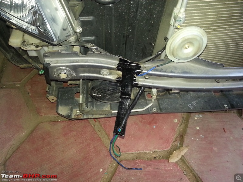

I installed the lamps as a DIY yesterday. I got the clamps welded from a garage but did the install myself.
Integrated the driving lamps relay and harness into the headlamp relay kit harness and wired it in such a way that the hellas come on when i put the high beams.
There are no switches installed for the hellas since i wanted to keep the wiring simple and short. I don't plan to use the extra lights inside city so i'm keeping the relay (micro relay) out. When i need the lights for highway usage i'll put the relay in, can do this with either relay or the fuse. The connections are all soldered and insulated with double layer of heat-shrink tubing. Wire is passed through the corrugated plastic sleeve.
Clamps - Heavy gauge strip.
Auto Lighting thread : Post all queries about automobile lighting here-20130525_171700.jpg
Auto Lighting thread : Post all queries about automobile lighting here-20130525_171707.jpg
Fuse cluster - high beam, low beam and aux light
Auto Lighting thread : Post all queries about automobile lighting here-20130525_171720.jpg
Micro relay in its socket
Auto Lighting thread : Post all queries about automobile lighting here-20130525_171726.jpg
Lights
Auto Lighting thread : Post all queries about automobile lighting here-20130525_190203.jpg
