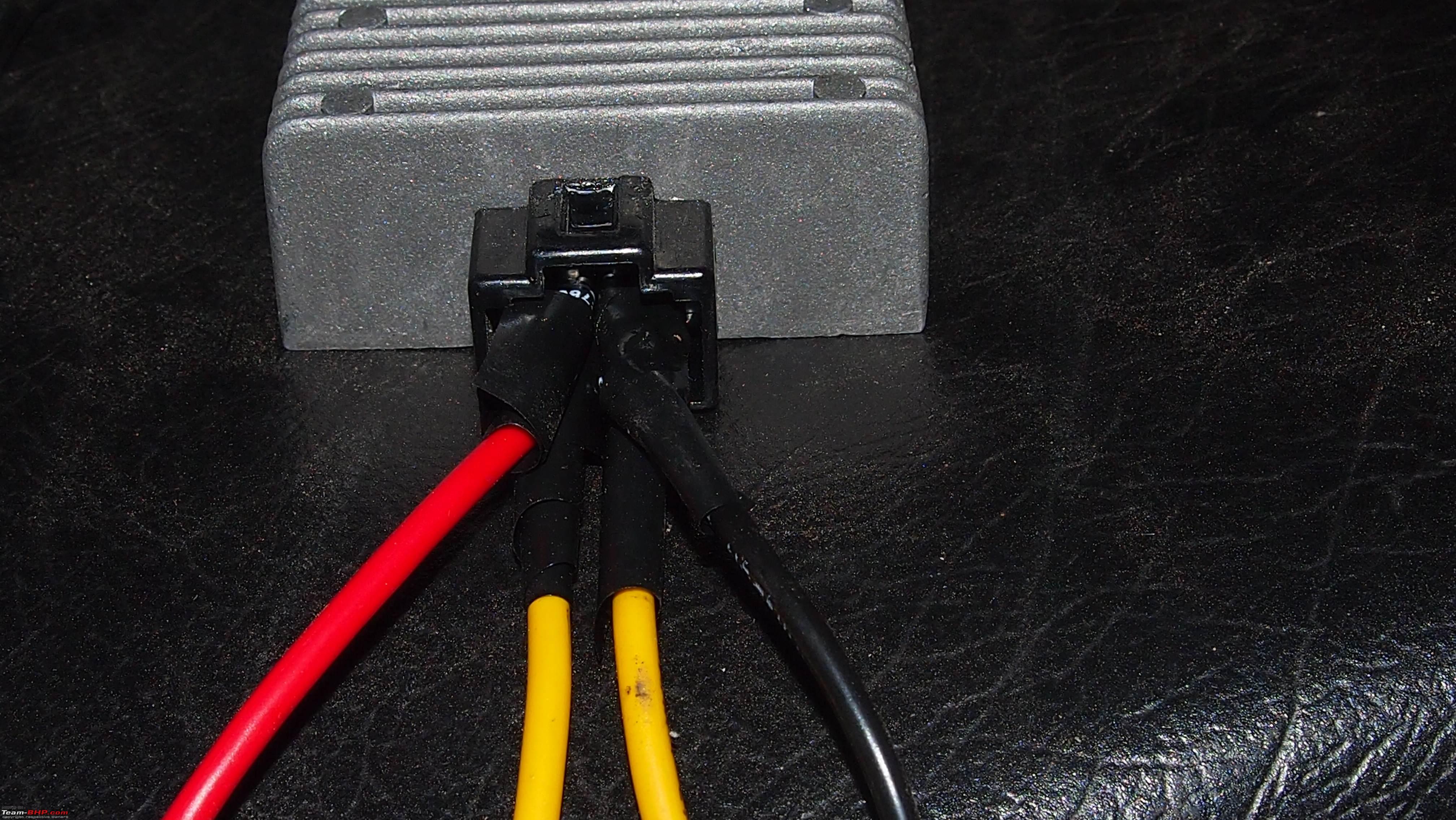

I've tried a Regulator-rectifier for standard CI350 using a 'Swiss Regulator- rectifier' for the point set enfield. After I did a 6V to 12V conversion the bike would stall after crossing 80 kmph due to power surge and it felt like a sudden jolt. After many months of agony and replacing of a lot of parts, I pinned the problem to the Bridge rectifier. Replacing this with a regulator-rectifier solved my problem. The bike accelerates smoothly.
Keep the Swiss regulator-rectifier 4 pin connector facing you.
The bottom 2 pins are for the AC wires from the alternator you can connect either of then from the alternator.
The upper 2 pins are 12V-14V DC output, top left for positive and top right for negative.
I have rewired the enfield myself with thick 4 sqmm wire and made the body negative and centre of the spark plug positive as in modern bikes. Cost me just Rs180 for the wires. The bike runs very well as good as any other enfield.
I recommend a Reg-rectifier instead of a bridge rectifier in an enfield that has had a 6V to 12V conversion or a new alternator installed.

6 months down the line and it still works good.
