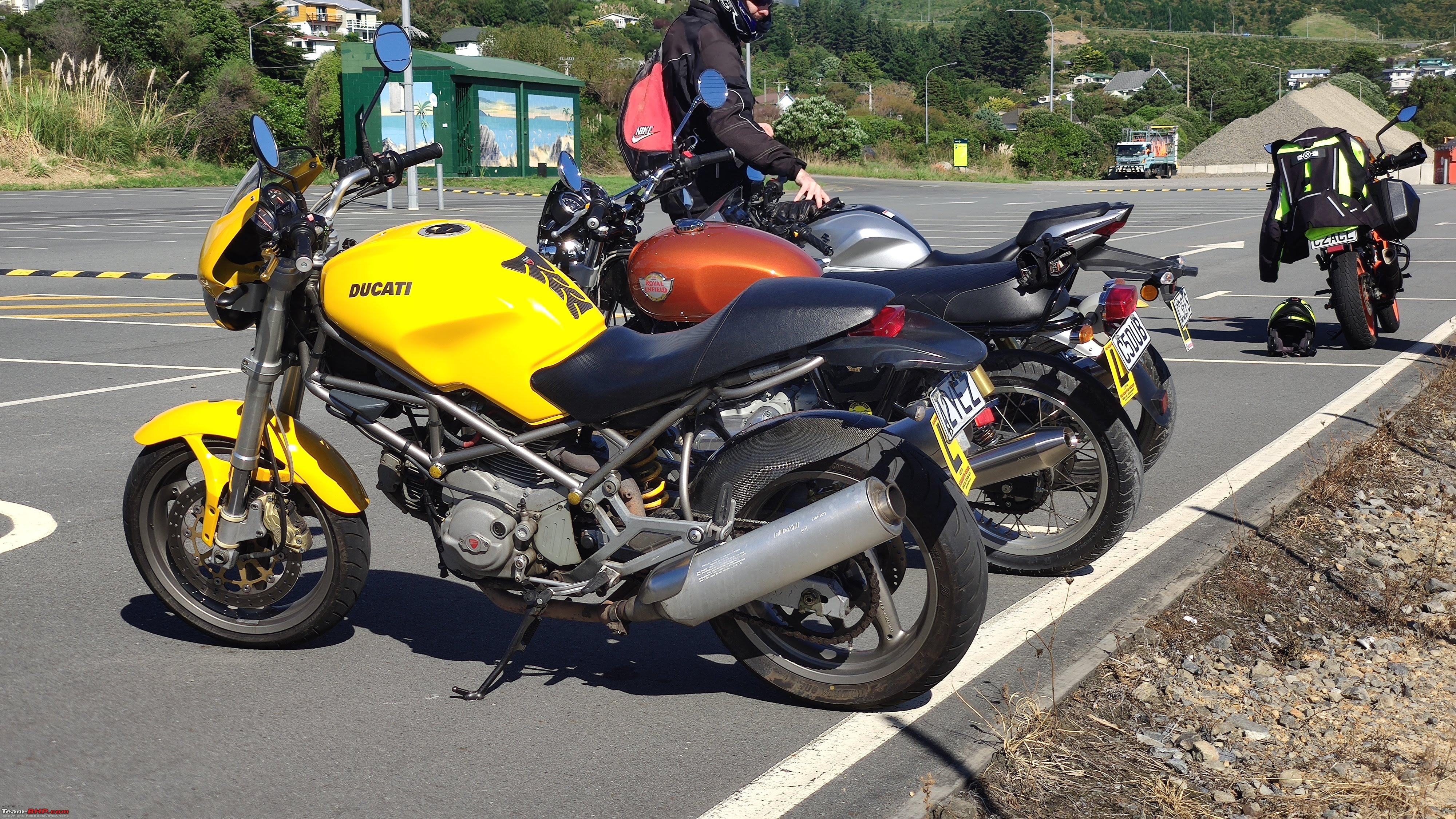

Was in the company of some unique machines and thought of sharing this here.
First, the Ducati Monster 400. This motorcycle was a part of 5 of us who were attending a Ride Forever Bronze Certification program. I was doing a refresher as its well past time I moved from my Leaners to Restricted motorcycle license. As always, these courses teach you motorcycles skills that you will otherwise never get to learn or experience. The $20 day long session is peanuts for the knowledge you gain.
The Ducati was the oldest motorcycle to attend. Old school. The 90 degree V twin engine fed by two carburetors. For something Italian thats generally fiddly about their mechanical design, I was impressed at how easy they made it to maintain. The fuel tank is latched to the fork stem. You remove the latch and it hinges at the seat end giving you full access to the air box and fuel system. A tool free & neat design.
Ridden: Royal Enfield Interceptor 650 & Continental GT 650 Twin-img_20220403_143048.jpg

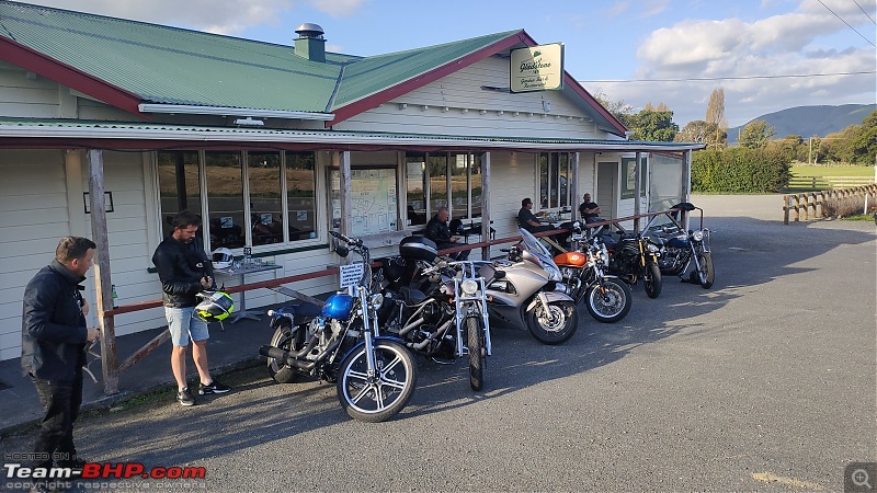

The photos below are from yesterday. An impromptu ride to Gladstone. This Inn gets interesting as you spend more time. I hung around for about 90minutes, soaking in the evening light. In that time, lots of interesting motorcycle or vehicles showed up. I know nothing about Harley Davidsons so please forgive that I do not know the model or cubic inch of the bikes on display. What I will say is, when they are fired up, their engines roar like none other.
There was an old Honda ST1300 or Pan European. If you want to know or hear what a smooth engine sounds like, this is the benchmark. Two decades of age means nothing for this Honda. They purr like they are brand new. Reminds me of that old video of a guy making different sounds of all the motorcycle brands. He was spot on about the noise a Honda makes. There is a sense of calm about them.
One of the Triumphs are easily identified. The other not so. The modern one is a 2019 1050cc Speed Triple R (or RS). As with any Triumph sports machine, they are truly unique in their looks and design elements.
The one that got me interested was the 1978 Bonneville 750. It was immaculate. Some bits are modernized to keep up with the times. The points ignition was replaced with a more modern electronic ignition. Starting is easier now. No decomp too or its integrated. I could not tell. It had a cable operated front disc brake and the rear one operated by a shaft. No hydraulics. The Amal carburetors were open ended with only a mesh covering the air intake. Each had their own petrol tap opening. The float chambers were interlinked with a fuel pipe. I guess to balance out flooding. The exhausts were after market and quite loud. That distinct Triumph twin firing order was present. At low rpm's it tends to sound a bit slow or out of sync. As you raise rpm, it sounds better.
I got chatting with the Speed Triple owner who was older to me. We shared stories about our on road experiences and destinations we've been too. He asked about the Interceptor and its dependability. Assured him that the motorcycles Royal Enfield make today are the opposite of what they made a while back.
In this company of motorcycles, I was the young stud.
Ridden: Royal Enfield Interceptor 650 & Continental GT 650 Twin-img_20220410_160712.jpg
Ridden: Royal Enfield Interceptor 650 & Continental GT 650 Twin-img_20220410_160544.jpg
