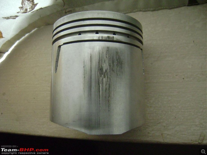

Is this Piston in usable form with a new set of rings?
Std size OE piston from a '08 CI Electra done ~19k kms.
I had faced a loss of power at 100kph similar to when fuel supply hits reserve. Engine did not die down but i just pulled in the clutch, coasted to 50kph speeds 'like' giving carb time to fill up and by that time its back running normal. Did those speeds later with no issues and so i thought it was a one off fuel flow issue.
A carbon clean up work 2k kms after the incident shows this damage- a mild piston seizure . Its got these 'rubbing' marks on front & rear but surface is not rough & has no deep scores. Bore is good, no other issues.
So is it good for use?
Attachment 560890
Attachment 560889
TO be trure with you i have seen really bad quality of Pistons being sold lately. so if that kinda quality is to be bought then i would be prefering to use tthe same piston with the new RINGS, other wise yes you should change the piston but i will like to tell you that i am stupid and i did the whole leh trip on such a piston and it all went fine.
Hi the marks don't look too deep and the piston ring area looks to be clean except a slight marking on the bottom ring land of oil control ring. I'd say you can keep using this piston. I have reused a slightly seized piston, like this one, in my engine with no ill effects. Clean the bore thoroughly.
Is this Piston in usable form with a new set of rings? ...
update: i opted for a fresh cyl-piston kit considering (1)the not-so-gentle revs & speeds my bike had seen right after the initial run-in (2) at <3 yrs- 20k kms it is still a new machine against the decades old machines going around (3)its my sole daily run about so a new kit offers peace of mind.
And most importantly though the bore & piston looked good, I couldn't get to measure the wear- clearance properly to decide on a ring set or piston change. Piston was cleaned with kerosene & a piece of fine marble polishing stone rubbed lightly at scored areas only in a circumferential pattern. There were only a couple of spots left to catch finger nails, no score lines. but rings were out.
My choice did turn out good, its got a new found punch esp low-end.
now a Query: Is there a preferred brand for std/ oversize replacement pistons?
removed OE was Goetze.

Rennjit:
I suggest that you ride real easy with your new piston and rings, just like you were breaking in a brand new motorcycle.
If you ride like the engine was fully broken in you stand a good chance of scoring the new piston or cylinder or possibly even "freezing it up".
The piston will have very little clearance with the cylinders bore at first and will have to go thru many heat up/cool down cycles before it has fully sized itself to fit its new environment.
The new piston rings also will wear both themselves and the bore in and in doing so will create a lot of heat and small metal filings while they do this.
For that reason alone it may be a good idea to change your oil after you've ridden 300 kms.
Enjoy your "new" motorcycle and ride with care.
