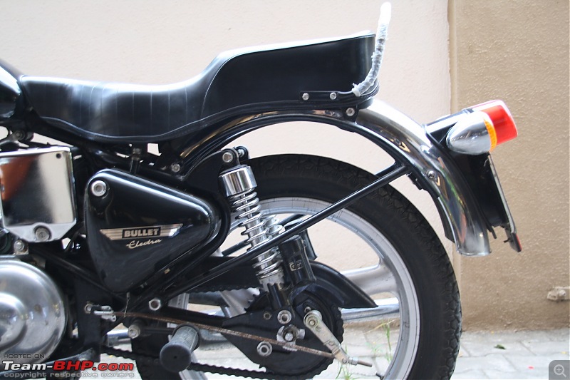

Here is my father's early 80's Bullet. Its not really been used much so I decided to take over . It was overhauled sometime ago, while I was studying in the Amreeka, so couldnt really influence anything...
Now I need your help... I have issues with the ride height. Although, I can still ride, its not to my liking. Also I feel the gap between the wheel and the mudguard looks completely out of place.
So here are the problem areas I need to sort out:
1>
How can I reduce the gap between the wheel and the mudguard? I noticed the assembly is an individual piece which connects to the chassis and the mudguard. In that case, can I get a different assembly which has a lower curvature?
2>
Another issue I feel is the seat. Im planning to get the stock two piece seat assembly from the new Classic350/500. Will this help lower the ride height? The seat looks a little low profile but I cant really make out from the pictures.
3>
I feel they have changed the handle bar as well... Its bent upwards and I dont think thats how the stock handle is supposed to be.
4>
I want to upgrade the rear drum brakes and get a disk brake assembly for the front.
Also whats the widest rear tyre I can get for a good balance between stability and performance? Are the stock Classic350/500 tyres good enough?
I am eagerly waiting for your tips/suggestions. Also I am from Pune and would appreciate any references to good mechanics/workshops who can help me out with these tweaks and source the parts as required...

Hey,
Please find my thoughts with respect to your question below:
1. You can use Machismo front and rear mudguard, they are good in height.
2. You can't fit Classic seat without any modification, you need to alter the frame little bit to fix that, instead of that I will suggest go for after market seat from Nana Peth Pune however you will not get the original seat comfort in aftermarket seats.
3. Yes, this looks like after market handle but you can get stock handle from authorised dealer for 150 - 200 Rupees and they are easy to fit, I have 2 set of handle and I keep changing every 6 months.
4. I think rear drum break is enough but yes front disc break is good to go, you need to change the froks for that, so whole setup will cost around 10K.
Can't comment on tyre as I am also looking for the same.

Your primary intent seems to be lowering the seat height. I had a similar need and went to Khajanchi in Karol Bagh, Delhi. He has a special seat frame for lowering the seat which will probably give you a little over an inch in height reduction. The way it works is that instead of the seat frame resting "on" slots for the seat, the frame would have a hook that goes "into" the slot. It essentially reduces the gap between the seat and the bike chasis.
Difficult to explain in words, but such a frame would have a different bottom from conventional seat frames. The moment you look at it, you will know that its the one
There must be some seat experts in Pune who would have this. Additionally you could shave off some of the foam and have some more height. Gel inserts could be useful here.
