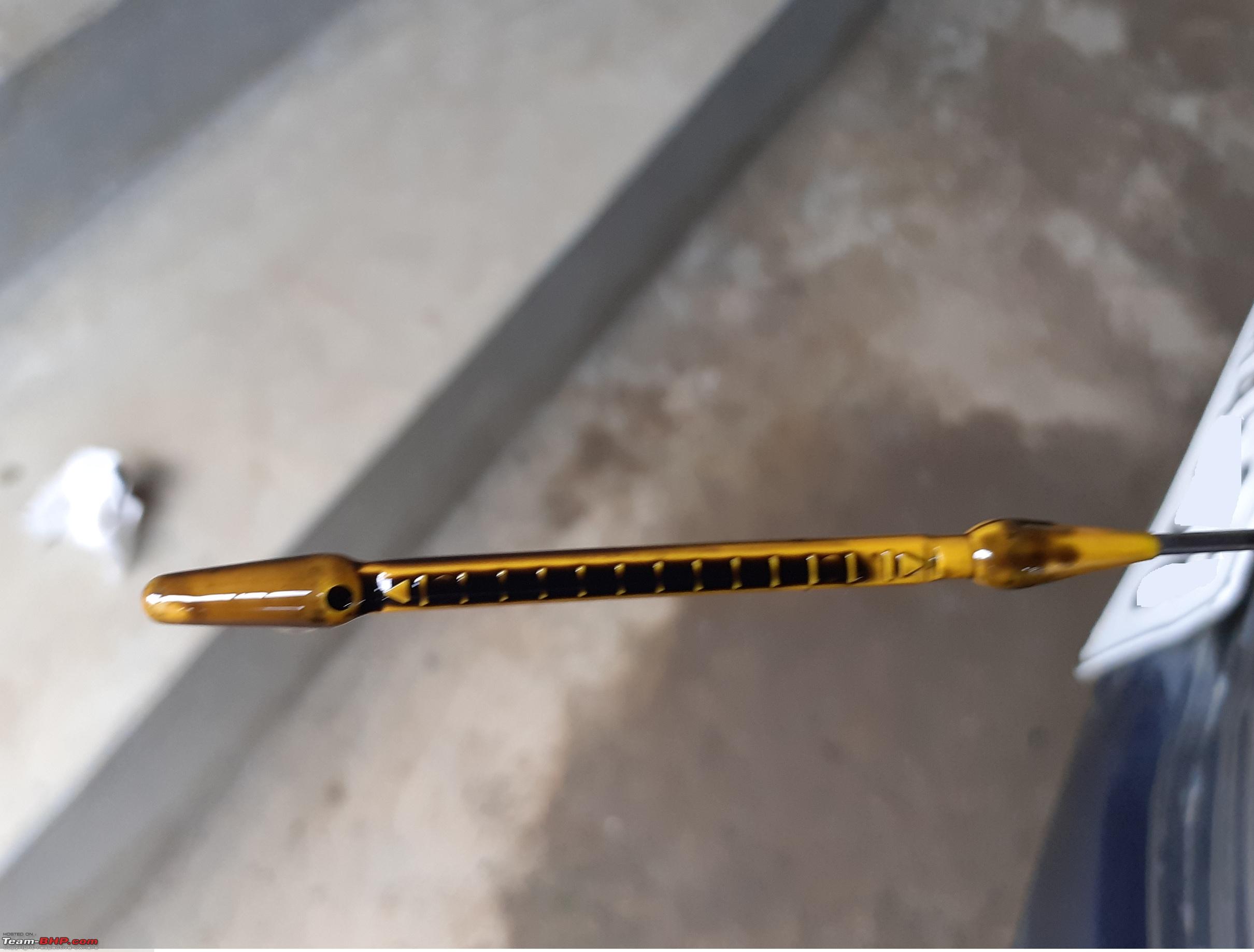

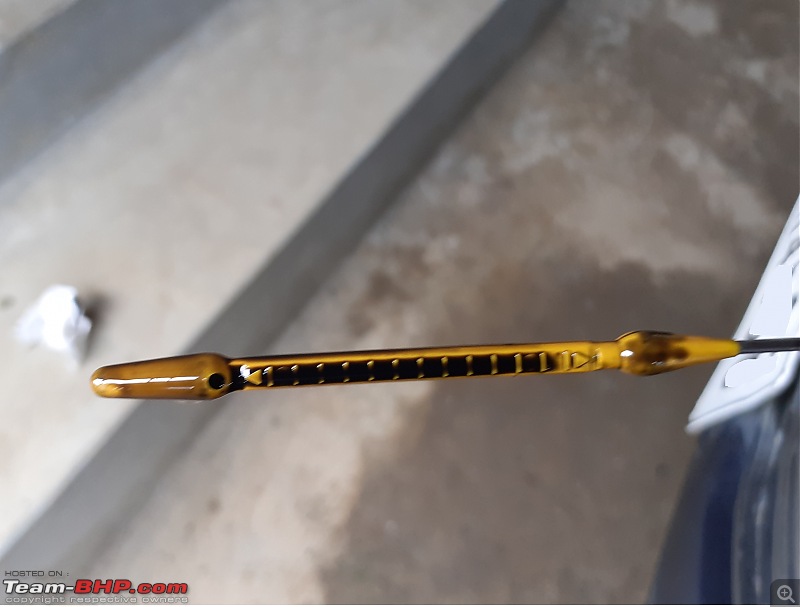

2016 Ecosport TDCi 70k km service:
The last service was done at 59k km & I had planned to keep the oil change interval at 8-9k km going forward, which meant next service was due at 68k km. Though due to Covid-19 & lockdown, I couldn't get the service done earlier. I would have postponed the service to an even later date, if not for a noise that had developed recently. During startup & shutdown (i.e when the engine shakes a bit), a ringing kind of sound came from the engine. So, it was decided to get the issue checked & also complete the 70k km service.
70k km service for an Ecosport is a simple service where only engine oil & engine oil filter are changed. I generally prefer to stay with the car during service & overlook the work done, though this time due to the current situation I dropped off the car & came back home. I told my SA to fix the ringing sound & change both the Air & AC filters, over & above the engine oil & filter change.
The ringing sound issue was solved, it was apparently due to the starter motor bracket coming in contact with something. The SA told me they had to change some gear lever bushing (worth 300 rupees), as the OE one was worn out. The total bill was Rs. 5249, which is reasonable for a 70k km service of a diesel car. This time they did add some unnecessary (though cheap) things to the bill like wash fluid pouch (washer tank was already full), service kit, distilled water & some grease.
Today morning I checked the dipstick level, to my shock it was slightly above the maximum mark . Checked the bill, they had billed me for 4.2 litres of engine oil. For all the previous oil changes, they billed me for 4 litres of engine oil. Checked the owner's manual, it recommended 3.8 litres of engine oil with oil filter replacement. Called my SA & asked for an explanation, he told me sometimes the engine takes more engine oil & hence they filled more engine oil this time . I am aware that there are many side effects of overfilling engine oil, especially in a turbocharged engine. In our ex Punto, the crankshaft oil seal gave away at 90k km due to overfilling of engine oil.
It was a case of once bitten, twice shy. Informed my SA that I am coming over to FASS to get the excess engine oil drained. The mechanic put the car on a ramp, loosened the drain plug nut & drained a bit of engine oil. Checked the dipstick, it was slightly below the maximum mark. Told the mechanic & the SA to fill only 3.8 litres of engine oil in my car henceforth, no matter the dipstick reading.

Before photo of the oil dipstick:
Ford EcoSport : Official Review-dipstick-before.jpg
After photo of the oil dipstick (after letting the engine cool down for 5-6 hours):
Ford EcoSport : Official Review-dipstick-after.jpg
