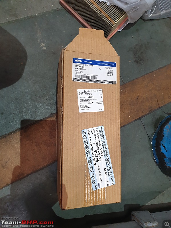

Thanks to Niraj Singh for sending these images in. Heartfelt gratitude for sharing it with other enthusiasts via this Team-BHP page!
I want to share a problem that I faced with my 2018 Ecosport - Trend+ (Diesel).
I searched the Team-BHP forum, but did not find any thread where this issue has been mentioned.
My Ecosport had just completed 25k on the odo when suddenly a message appeared on the MID - "Brake Applied, Power Reduced". This message flashed every time the brake was applied above a speed of 20 kmph. And there was no message below this speed. It was coupled with RPM fluctuation. There was no error or warning sign on the MID and everything was working fine. Searched the manual and found that the only mention of this problem was related to hand-brake being engaged while accelerating, which was not the case with me.
Took the vehicle to the authorized service centre, but no error was being shown in the FDRS system as well. They tried to change the brake switch but the problem was not resolved. The problem was then discussed over the phone with someone higher, and he immediately asked to change the Accelerator pedal. Since it was not in stock, it was ordered and changed after the part arrived. After that there has been no issue while driving the car and the throttle seems to be more aggressive with the power delivery.
The RPM fluctuation issue has also vanished.
The part was changed under warranty and the service centre didn't charge the labor as well.
Attaching the pictures of the issue that was faced and the part that was changed.
I am sharing this, just in case someone else, somewhere, faces the same issue, shall know what exactly is the cause and what needs to be done.
Thank You.
