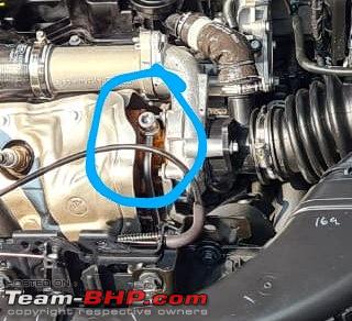

My friend took delivery of a Diesel EcoSport two days ago, while checking under the bonnet today we found some rusting under the heat shield ( see the picture) is this something to be concerned of?
Its a November manufactured vehicle.
Ford EcoSport : Official Review-img20201213wa0007201.jpeg

Looks like it is the exhaust manifold, it is usually made of iron, so surface rust is common, better get it cleaned after opening heat shield with a metal wire brush or 300 grit sand paper when the vehicle is cold and apply heat resistant primer and paint if needed.
Generally this happens if the car is washed with bore water and is parked for long time without starting it after washing or if not cleaned with air blower after water washing the engine bay.
If you don't want to do it yourself, also since it is a brand new car, ask the service center for free replacement of the part.

I've had this on my 2013 EcoSport since brand new. It's just surface rust, nothing to be worried about.
