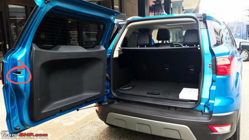

Need more details on boot issue.. where exactly to spray WD 40?
Isn't that the MAF sensor? I need to locate the MAP sensor ..
Attaching a generic image, the latch highlighted in red is where you have to spray the wd-40. It'll stop the creaking temporarily, eventually you'll have to get it tightened at the service center.
