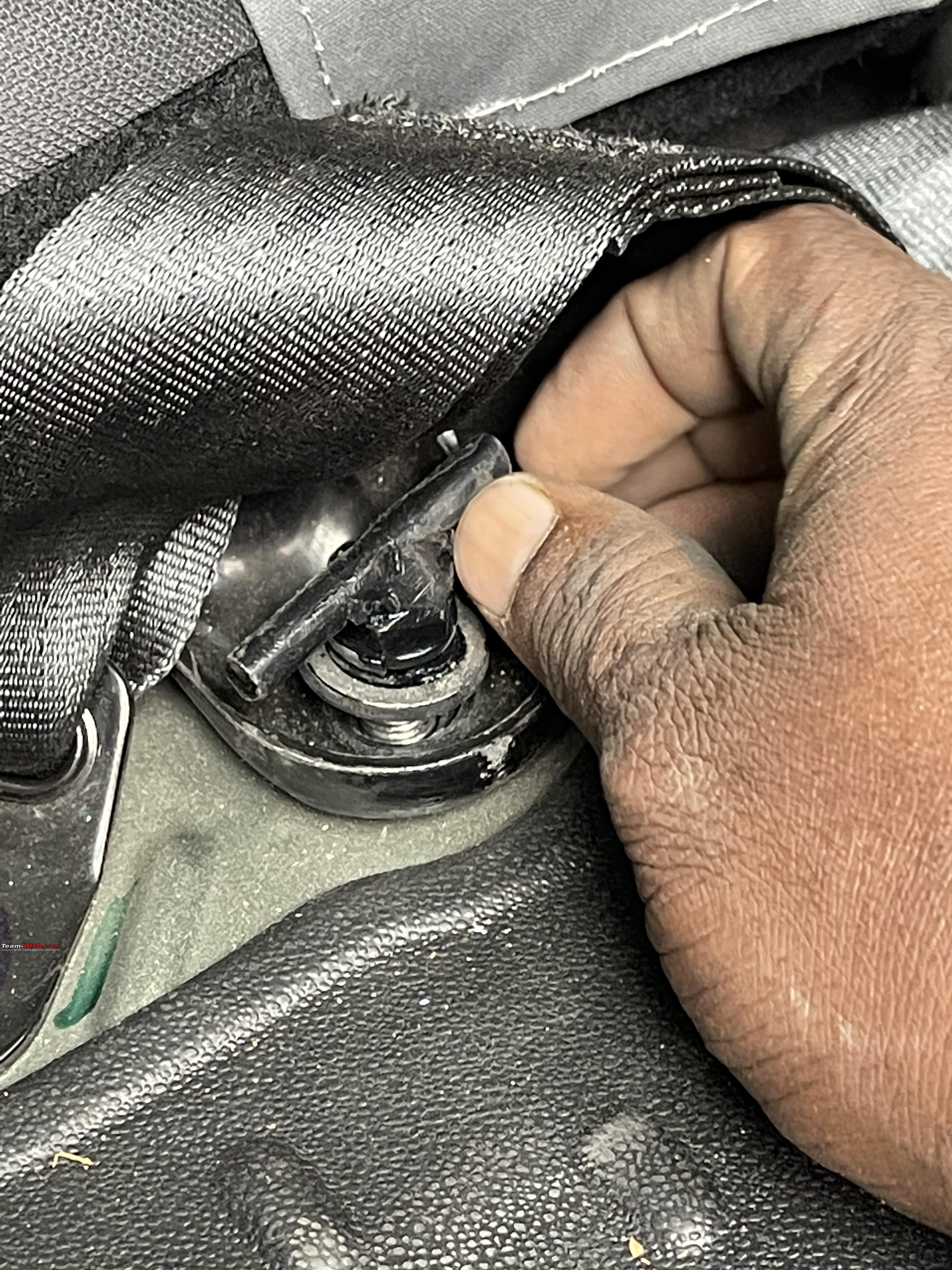

Small additional work on my Thar. I would consider these essential functional enhancements.
1.Tumble-fold rear seats. This makes for a more use-able cargo bay area. This is from Azad 4x4 Bangalore and executed by them neatly in 2 hours. They remove the seat. Introduce a pair of hinged plates to allow for the tumble. No drilling etc. Just using rhe existing seat securing holes. Replacing the OEM Bolts with these simple easy to use T Bolts as shown. The seat bottom area where the sponge is exposed is covered easily with a piece of carpet with velcro. It imparts a clean look. The actual tumble folded seat rests most of its weight on the vehicle floor. And will be secure when the cargo bay has luggage in it. The bungee cord stays are merely for additional stability so that it doesn't fall back. It doesn't exert heavy strain on the front seat head rest.
The only headache is to get there and back which was quite a trek for me.
2. Silencer end-can guard - mild steel. Will protect from roots, small rocks and stone hits. This is from Swastik Fabs. Executed at Auto Style Koramangala.
3. Another thing people do is the dead pedal for the AT vehicles. This is a bad idea for a tall person. It eats up vital 5-6 inches of footwell space in the already cramped Thar footwell which otherwise could be used to stretch one’s foot and be relatively comfortable. I tried fitting it but immediately had it removed because it will actually be a disadvantage for me rather than an enhancement.
Mahindra has copied so much from Jeep Wrangler. But they copied everything in a very ‘surface’ manner. Had they done a little more diligence they could have copied all the lovely functional bits also nicely. Tumble-fold seats and creative storage and arm-rests and all come standard in the Wrangler. They ought to have come standard in the Thar too. After all it professes to be your super functional go anywhere adventure vehicle.
Oh man! This is something which is definitely required for Thar. Could you share how much it costed you?
Are the seats secure without bungee cord?
Found one video of something like this, but couldn't really understand what the person was saying. But it looks really functional and easy.
Azad charges Rs 5500/-
I would not dispense with the Bungee cord. It will work as a restraint at least.
The cover for the silencer is mild steel and is expensive at Rs 7500/-
Thank you for the reply, sir. Could you share what was altered in the seat? Like is this reversible or do they weld/attach the hinge joints permanently under the seat after cutting from the frame underneath?
I talked to Bimbra 4x4 Gurgaon, they are asking 11k for the same, but their seats have slide function as well. This is from their brochure:
Yes they replace the OEM joints with hinged joints. This is a minor job and neatly executed.
You can reach out direct to Azad 4x4 for more details. In this specific matter I didnt like the Bimbra solution. It involved additional stabiliser pipes and all to keep the seat in place. Too cumbersome. I preferred the Azad one for my kind of use case.
