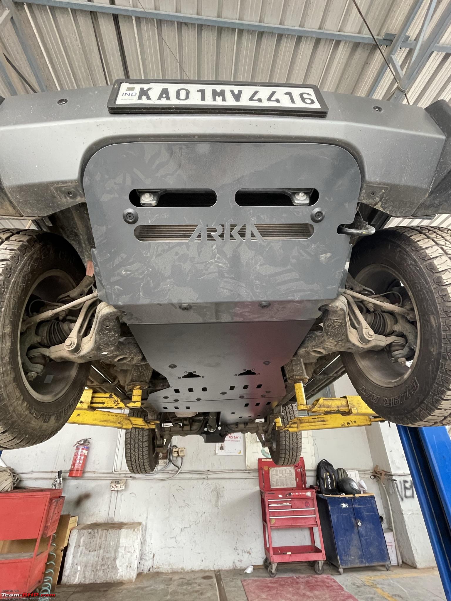

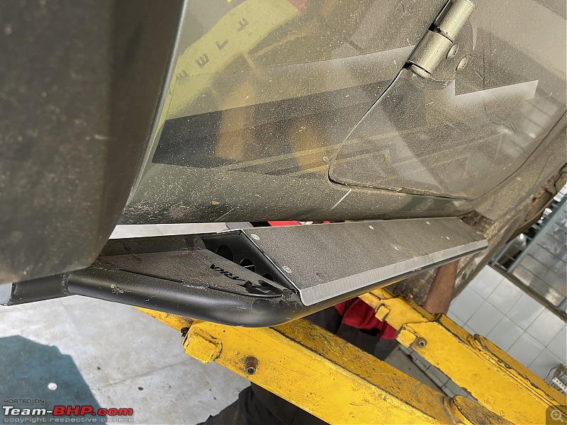

The pair of side steps / rock sliders which I bought from Arka weigh about 24-26Kg total. The entire three piece underbody armour another 22 -24 odd Kg. The end can guard which is made of mild steel may weigh another 4-6 Kg. The rear diff guard probably another 2Kg. The front bracket maybe another 1kg.
The 3 piece underbody armour can be fitted as a DIY.
You will need a set of Allen Keys and of course the Allen Bolts come in the box along with the armour. You will require access to either a 2 post lift OR a service inspection floor pit and you will need at least one person to help you lift and hold the plates in place while you bolt on the Allen bolts.
Along the way I would suggest spraying just a little WD40 into the bolt holes. And along the edges where the plates meet. So that any ‘tectonic’ movements are lubricated a little.
Here are the pics:
1. Underbody Armour - Aluminium (ARKA)
2. Side Steps/ Rock Sliders - Mild Steel with Good quality paint finish and 3M anti skid tape stuck on the surface (ARKA)

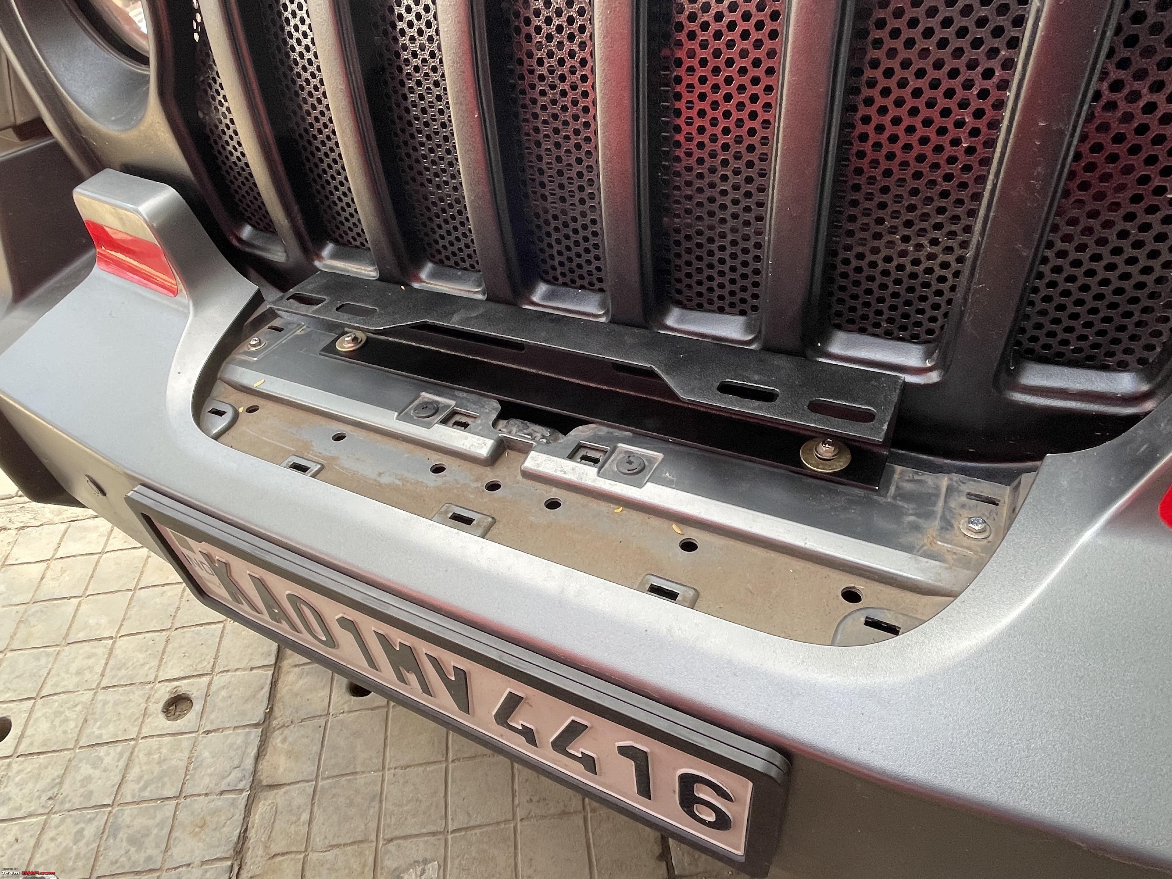

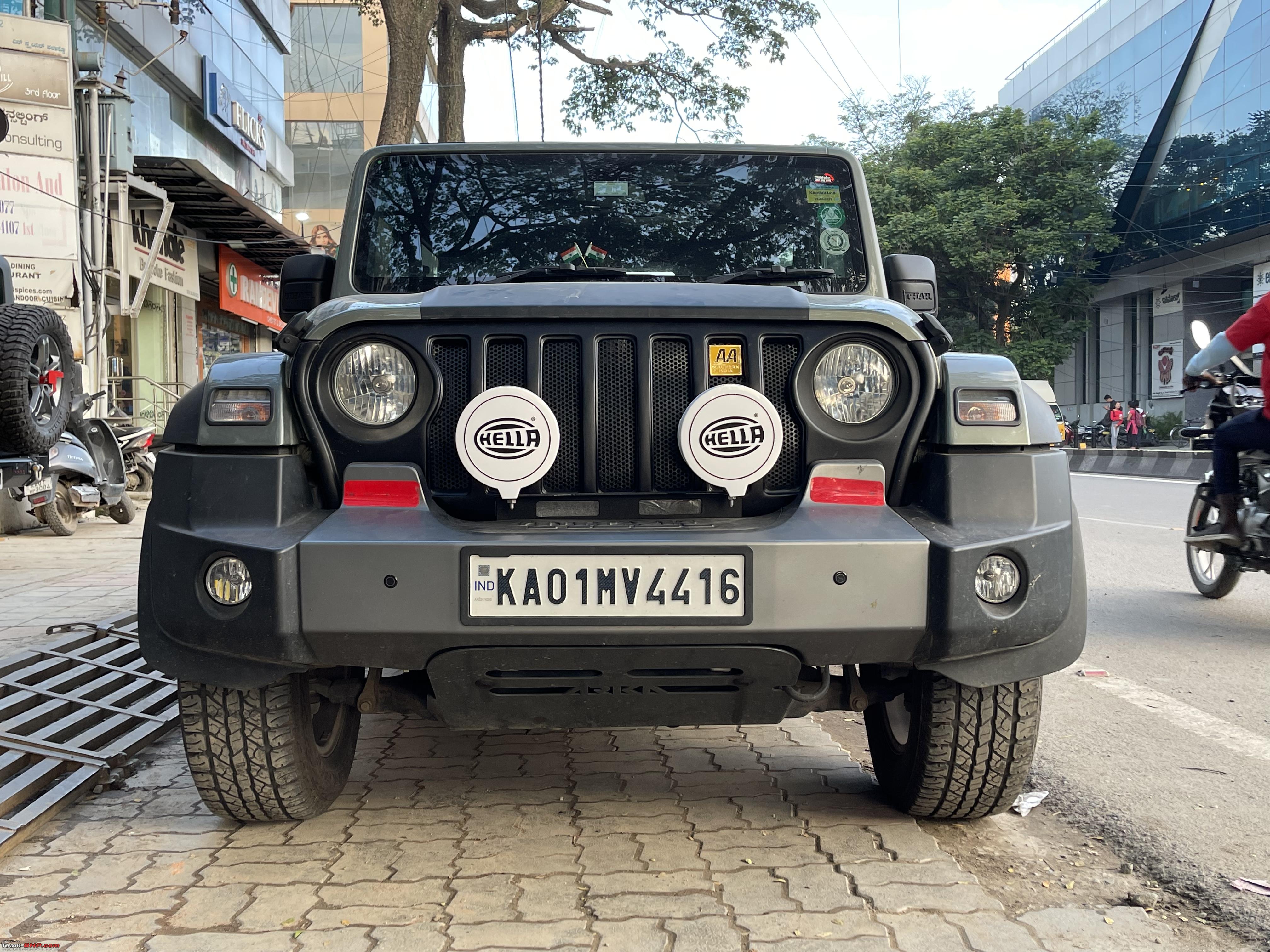

3. Front Powder Coated Mild Steel bracket moint for Fog Lamps (Bimbra)

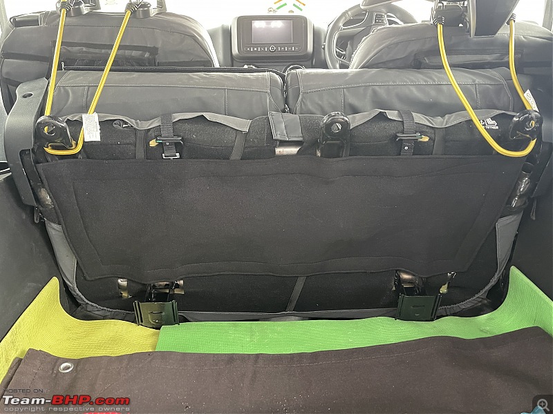

6. Tumble Folded Rear Seat - (Azad 4x4)

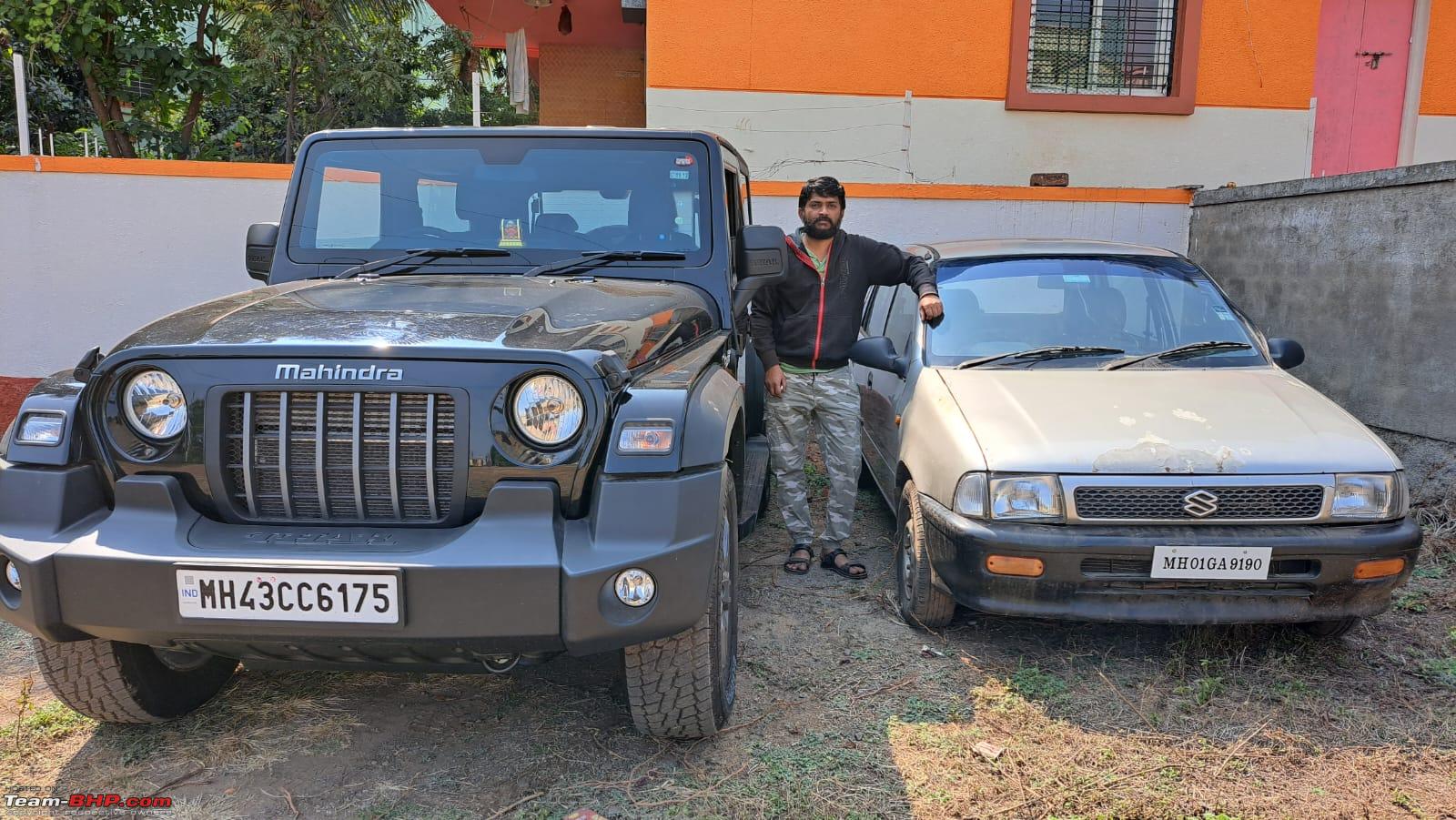

This december 2022 confirmed my decision to bring Thar LX Black Diesel MT to home. Costed me 18L on road. As I am typing this post, I have already completed 1000kms and first service is yet to be carried out.
Need
I have my, not so reliable Maruti Zen (2003), which I will be scrapping in April 23. After that I wont have any vehicle. Hence I needed a vehicle. Coming from a very old vehicle I had very limited expectations from the new one. And I did not want lot of gizmos in my vehicle.
Replacement Considered
Nothing else would do. I wanted to buy thar since 2014. But I did not because of soft top and problems associated with it. I did considered buying scorpio n, but that decision did not materialise because of long waiting period, and I did not want to buy a product which is not yet matured (read 1-2 years in market).
I also considered buying Thar AX but price difference between AX and LX is very marginal compared to specs I will be losing.
I would have seriously considered 2wd Thar if it came with 2.2ltr diesel.
Accessoroes Planned
Dashcam
Bimbra rear seat sliders
Auxiliary Head lamps
Bug deflectors
Grab Handle
